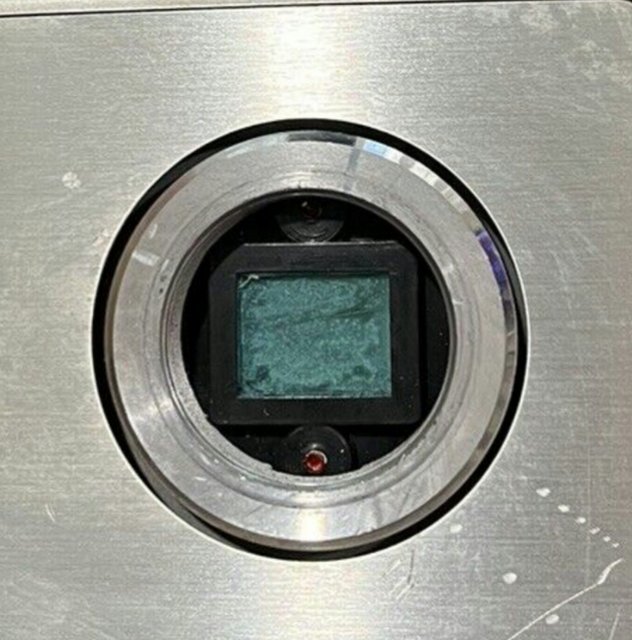

Panasonic PK-200 (maybe 300 later) is the twin. Look for the UV filter contamination in front of the tube before you buy any. You cannot fix it.

Tube TV 02-05-2023 07:13 PM
I'm glad you brought this up cause I've seen this before and thought that's what it was. There's a CC-001 on ebay that has pretty extreme clouding. Seller is asking $159.00 for it. Lol.
https://i.postimg.cc/d1RfC3Cc/2023-02-05-18-01-45.jpg
By the look of the rust on the chrome washer on microphone jack at the back of the camera it was likely stored in a humid location.
Now that I know it's a common issue I'll be asking for photo's with the lens removed before I purchase. No point on getting stuck with a dead horse and the only repair would be to hunt down a replacement vidicon tube which would be likely hard to find.
Dave A 02-06-2023 03:08 PM
What you see is the problem on the 001/002. But it is not on the tube, it is on a small glass plate mounted just in front of the tube. It can be replaced or maybe fashion a new one with good filter material.
Another trick is a hidden AGC switch. I forget how it is set from the factory but you can get to it from the outside. It is behind the top (left I think but I don't have mine nearby) air vents. You can see it from the outside. Just break out a vent plastic rib so you can get a small screwdriver through and change it. I think it is meant to AGC a cheap lens that does not have an iris control. Do this with the power off. It does have some high voltages.

Those blue skylight filters are also found on the later Sony DXC and DXC-D cameras and they're actually made of fluroite not to mention a great pain to deal with. I tried to post a picture here but the server isn't accepting anything greater than 150kb... I have nothing that will go below 1mb in file size.
