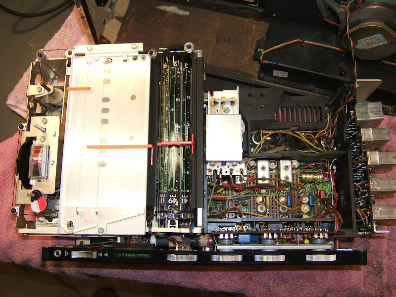

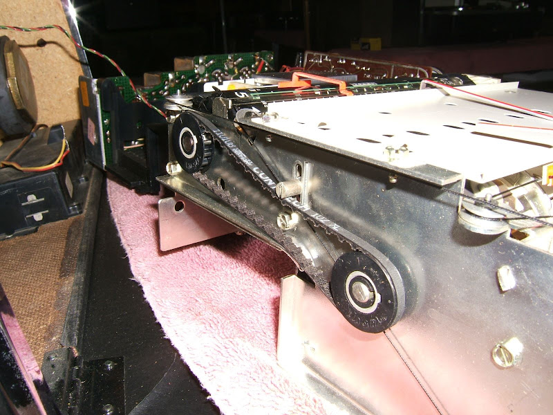

The carry case was a nice thing to have when I bought it. There is a little slot in the case which is where the previous owner stored ALL of the papers that fortunately are still present. When I bought it, it had a broken belt the rotates the SW dial drum. Its a cogged thermoplastic belt that just snapped. I glued it together as at the time I couldn't find a replacement anywhere. Just last week I found a guy on ebay in Germany who sells replacement belts and dial lamps for the 210. The new belts are actual rubber so the reliablity should be much greater. I also bought some dial lamps as this one needs a couple new bulbs replaced. Im still waiting on those parts to arrive as I feel that luck is the only reason the belt didn't break on me again.
One other thing that I replaced right after I got the radio was the antenna as the original antenna was broken and a large section missing. When the radio was up on ebay, it was advertized with the fault of the broken antenna and "the dial drum doesnt turn so I cant test all the bands" but it was mint so I figured the problems couldn't be too difficult. Fortunatly that was the case as the radio worked flawlessly when I got the belt and antenna back together. I'm sure those flaws contributed to keeping the price down. I was lucky enough to find a replacement antenna for the 210 from some antenna guy in hong kong. I remember him telling me I was lucky to get the last one as it became NLA on his website right after I bought it. I have no idea if there is currently a source for replacement grundig antennas as they are very unique and I doubt anyone is reproducing them.
drh4683 10-25-2009 11:38 AM

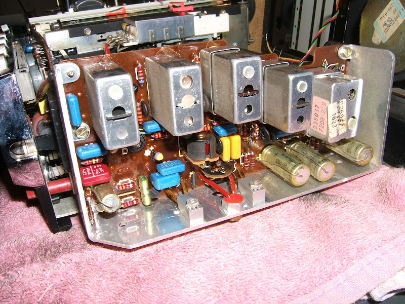

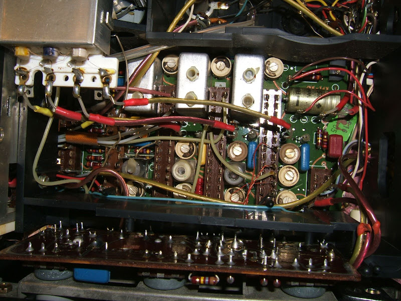

I received the new drive belt and dial bulbs today. I forgot how delicate this radio was to take apart. Its so overly complex how it is built. The new belt was definitly a great help so now I don't have to cross my fingers that the belt won't break if I ever want to change short wave bands. Hopefully I'll never have to restring the dial on this thing. Numerous cables that go all over the place on all sorts of angles, clutches and springs to the extreme. Its not like a zenith T/O where you can just unplug some connectors and then pull out the chassis. A zenith T/O is a much more robust chassis mainly because its point to point on a steel frame. You can handel that without feeling like you are going to damage something. This doesn't mean that the grundig is inferior in any way, its just so much more delicate with the number of parts vs. a T/O. You also have to unsolder some wires, disconnnect and remove the antenna then find numerous screws throughout before pulling the chassis. I do like how the dial bulbs can be replaced by pulling on tabs from the back and the bulb comes out on a special clip. To put it simply, its a radio unlike any other. Its a wonderful example of German engineering.

wcarroll 10-26-2009 09:23 AM
I agree... These radios are a bit complex to take apart. Not too bad when you've done it a few times and know what to expect. Did you get your parts from Rainer in Germany? A great guy to deal with! The replacement lamps he sells are correct replacements where some other eBay sellers sell a substitute that isn't as bright.
