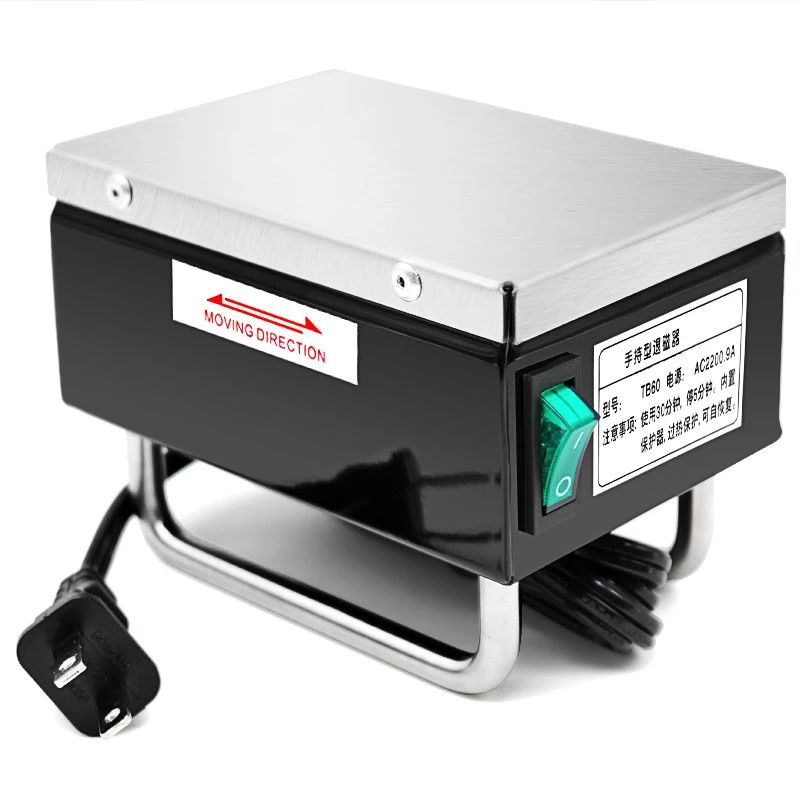

Degauss the iron part of chassis with a hand degausser and degauss coil.5. Degauss CRT face with a hand degausser again.6. Input AC 230V to AC IN and turn the monitor off and on. Then auto-degauss works.7. Reset FUNCTION_SW bit1 to 0 (auto-degauss = off)8. Degauss CRT face with a hand degausser again.9. Attach wobbling coil to the specified place on CRT neck.10. Put on landing sensor to CRT face.
