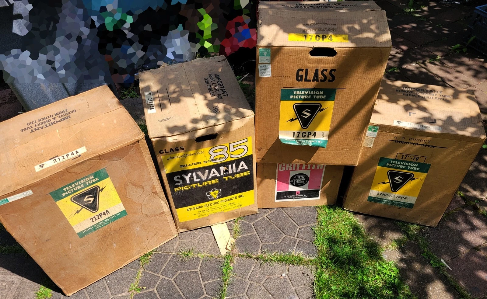

Is there any interst in New in Box 1950's Era CRT Picture Tubes?
I buy and sell old electronics and came across these a couple months ago.
Sylvania and Griffiths 21ZP4A 21WP4A 17CP4 17HP4 17RP4 17DTP4
Not exactly sure what to do with them. They are so old they don't even have the implosion band around them. I *really* don't want to ship them. I'm in the Duluth MN area.

If that 17CP4 is intact and still good, some people would kill to have it, cause it's rare and highly desired.

Metal cone? Never even heard of that - didn't even know that was a thing. Most of the boxes are still sealed, and the 1 I looked it was glass.

This says it's a metal cone type.
https://frank.pocnet.net/sheets/127/1/17CP4.pdf
Prone to leaks, but rare if good.

Yes, implosion band came much later. Don't worry - these are pretty stable.
17DTP4 will work in a Predicta.
I'd take them all, but you're just too far away.
