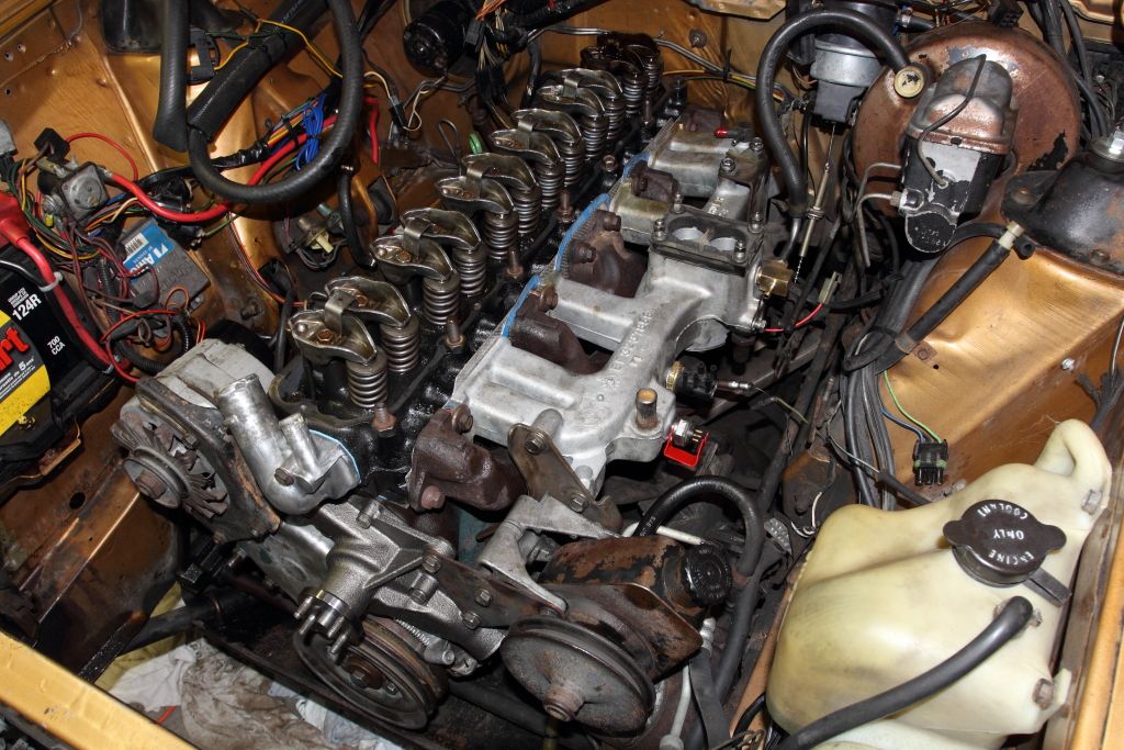

Anyways after dinner last night I decided to take the car out to see how it handled and get the ropes of driving and parking a wagon. About five minutes after the above photo was taken I drove up the steep hill in town....and the automatic transmission died and dropped into neutral.
I did get the phonebook sized service manual with this car. The fault isolation matrix seems to indicate a hydraulic failure. The car itself was hopeless to shift into anything or make any transmission noises unless it was cold. The car was towed with my BCAA coverage to a transmission shop I know and we'll start learning how much more this car is going to cost me tomorrow.

More mixed news today while the shop was still closed.
I went and tried the transmissiont this morning after it had gone cold and the transmission was extremely noisy but would go into gear, so it's not completely dead, just, unwell. Still no indications of particles in the fluid, nor does it look burned which is good.

You have a 4wd vehicle, that 'goes into neutral.' Red flag. The transfer case may be in neutral. If the 'transmission' sounds like it's grinding gears while in gear, or if it's in neutral completely and you put it in drive for a minute, then put it in park, and it makes a loud fast grinding, you're looking at a transfer case problem. You already indicated that it had a transfer case issue.
Check the trans fluid, engine running, in park, on a level ground. Is it in normal range, or too high/low? Check it again with engine off and compare the levels. Should be much higher on the stick when it's off. If there isn't much difference, the trans isn't sucking in fluid like it should. The filter could be clogged, or fallen down.
I'm not sure which transmission is in that Eagle, but the good news is that it's either a normal GM or Chrysler. So parts will be available.
No grinding gear noises actually, or at least compared to what I know of a manual transmission there's no obvious gear grinding going on. Think more the sound of a power steering pump under load. The previous owner also mentioned he had just serviced the transfer case and the rear differential, so both have recently had their fluids changed as well.
This was one of the first things I did once I was rolled into a parking lot. The fluid didn't smell, did not look burned, I didn't see anything shiny in the fluid but it was topped off before we left and was still reading high, both at hot idle and with the engine off. I checked it again this morning and still read the same, even after the car had warmed up, so I am still thinking it is a hydraulic issue. I was able to get it to shift into a gear this morning while cold but it was noisy, took a few seconds and would fail back to neutral and go quiet if I tried shifting out again.

If you're lucky, the filter just fell out, or failed in some way. Easy fix, you just need to get under the car and have ready a large, deep oil pan. The empty power steering pump whine is tell tale of the transmission oil pump picking up air.
