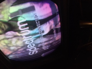

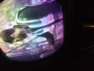

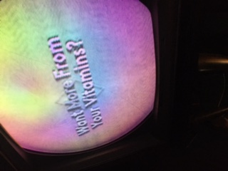

I’m looking for a cause that would be responsible for color bars on screen when turned on it looks like loss of color sync when I let it warm up for a few minutes I turn it off then back on and the color is fine. Maybe possible dirty tube pins or sockets all tubes are good but then again I have had bad tubes that test good.

So I took the horizontal out of sync and then back and has color bars then it popped in then I changed the channel to see if the color goes out of sync and it did but I moved the channel selector and again it came back in so it’s a bit inconsistent.

This has to do with parts being on the verge of out of tolerance CAPS RES, so on, 20%, 10% and the change as the set warms, since most adjustments are done warm, it's not unusual to see this weirdness on older sets when cold, the only real way to avoid it is to go overboard when you restore, if it says 20% test and replace at 10% or higher, if it says 10%, shoot for 5%, I myself have been using 2%, and only very rarely see the cold no sync problem.

You may want to consider running through the color AFC alignment procedure another time, keeping in mind that any parts that are close to tolerance in / out , resistors and critical caps, (NPO, and the like) will leave the set susceptible to drift as it warms up, heck, even changing tubes sometimes can do it like I saw on my latest Magnavox tv.

It's less likely an issue of good/bad tubes, and more likely an issue how a tuned circuit is reacting cold vs warm ( phase locked loop)- burst amp and color oscillator control, options are to try to adjust it to minimize the drift hot and cold so you don't lose lock OR replace with optimal parts so the drift is eliminated.
