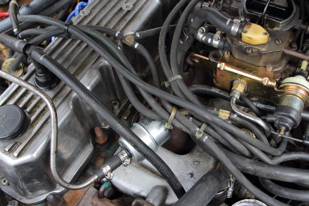

To be honest, I don't work on carbureted cars often enough to know for sure. My suggestion is to make damn sure all the vacuum lines are routed correctly, and not leaking vacuum. In fact, make especially sure zero vacuum is leaking. This can be very difficult. Large vacuum leaks can be found with a can of flammable brake cleaner and a big pair of balls. Little leaks can be impossible, unless you put eyes and hands on every single thing that has vacuum to it, and even then, it's unreliable at best.
Me, I could just hook up a smoke machine to the intake and watch where the smoke escapes. And yeah, that would probably be MY first step. Second, I'd make sure the ignition timing is in spec. Need a timing light and a tachometer, which I think you have. Easy to get, if not. Which, btw, idle speed has to be set right before doing ignition timing. Ignition timing should probably also be double checked after everything else you do.
Valve timing is pretty unlikely to be off. Perhaps a little with an old, stretched chain. But a jumped chain is unlikely. Besides, you'd know. It'd probably run ok, but have very little power when driving, all the time, not just when cold.
The rest would be carburetor adjustment, which... I'm not sure about with the computerized carb. I'm sure your big fancy book will detail it well. I'd imagine there's some way of locking the computer in default mode, perhaps unplugging some sensor or such. And then likely turning a screw while watching a vacuum gauge. Hopefully. It might be more complicated.

Already ahead of you on the vacuum lines. New rubber line for all the vacuum routing and the fuel lines has been ordered. My initial work back in the beginning of winter found either cracked or deteriorated lines.
Carb adjustments are made by placing the computer in a set mode which locks the timing and lean/rich adjustment to a known static value, then it's the usual method of setting the idle adjustment, unless they've also tempered with the metering pins and jets, in which case it might be better to just rebuild the carb.

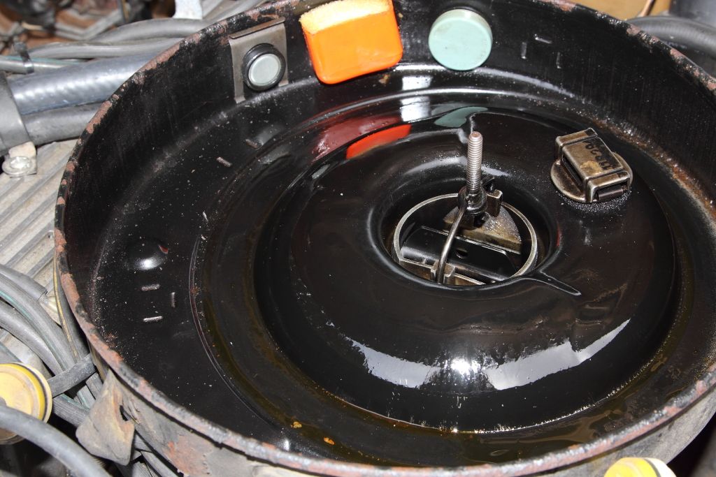

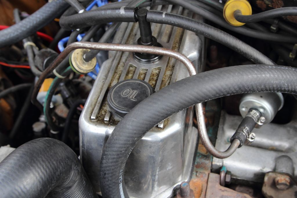

I actually have one of those small smoke machines Wal-Mart sells during Halloween. I've been thinking of ways to make it practical to do smoke testing, otherwise I'm stuck with a vacuum gauge and testing various points with the engine running.
Speaking of vacuum leaks, all is not well in the valve cover. Before I change the air filter I inspected the PCV breather and again after a week on the road I've had oil burping out of the valve cover, up the breather hose, through the PCV breather filter and into the air cleaner, so there's no point changing the air filter yet.
I tested the PCV valve and found it was behaving as it should and found a decent vacuum going through it and into the valve cover and sharing the same vacuum with the charcoal canister. What I did not find however was a vacuum at the air cleaner breather. It must be pulling a LOT of air from somewhere to defeat a 20 inHG vacuum and there was not a lot of indication of serious blow-by. There's an oil leak from the valve cover gasket above the manifolds, so we might have to first start there.
Yes you can set the computer into various open and closed loop modes manually. The mechanics handbook specifies how to jumper the diagnostic connectors to fool it into various states. Speaking of carb rebuilding, there was a partial rebuild kit that came with the car so indeed, there has been people inside the carb body. I know there's at least one shop in town within a stone's throw of my workplace who does rebuilds.

Eh, a lot of old cars get oil up the pcv hose. Hell, a lot of cars in general. There's a reason manufacturers stopped putting the pcv breather hose near the air filter - it just gets the filter all soggy (and leaves oil deposits on the throttle plate) - so most modern cars usually have the hose routed to the intake or some place down the line from the air filter. I think your car should probably have a little square of felt in the air cleaner, over the pcv hose place. To sop up the oil it squirts out. Not 100% sure though.
  #144
Old 03-12-2019, 10:54 PM
Posts: 1,021
It does. It's a little orange plastic cartridge with a FRAM part number and packed with a wadding that is plugged into the side of the air cleaner.
It's completely filled with oil. I need to find new wadding to replace it. My aftermarket metal valve cover apparently lacks a baffle for the breather port to keep oil out, so I'm wondering if that is something I should install when I redo the gasket.
