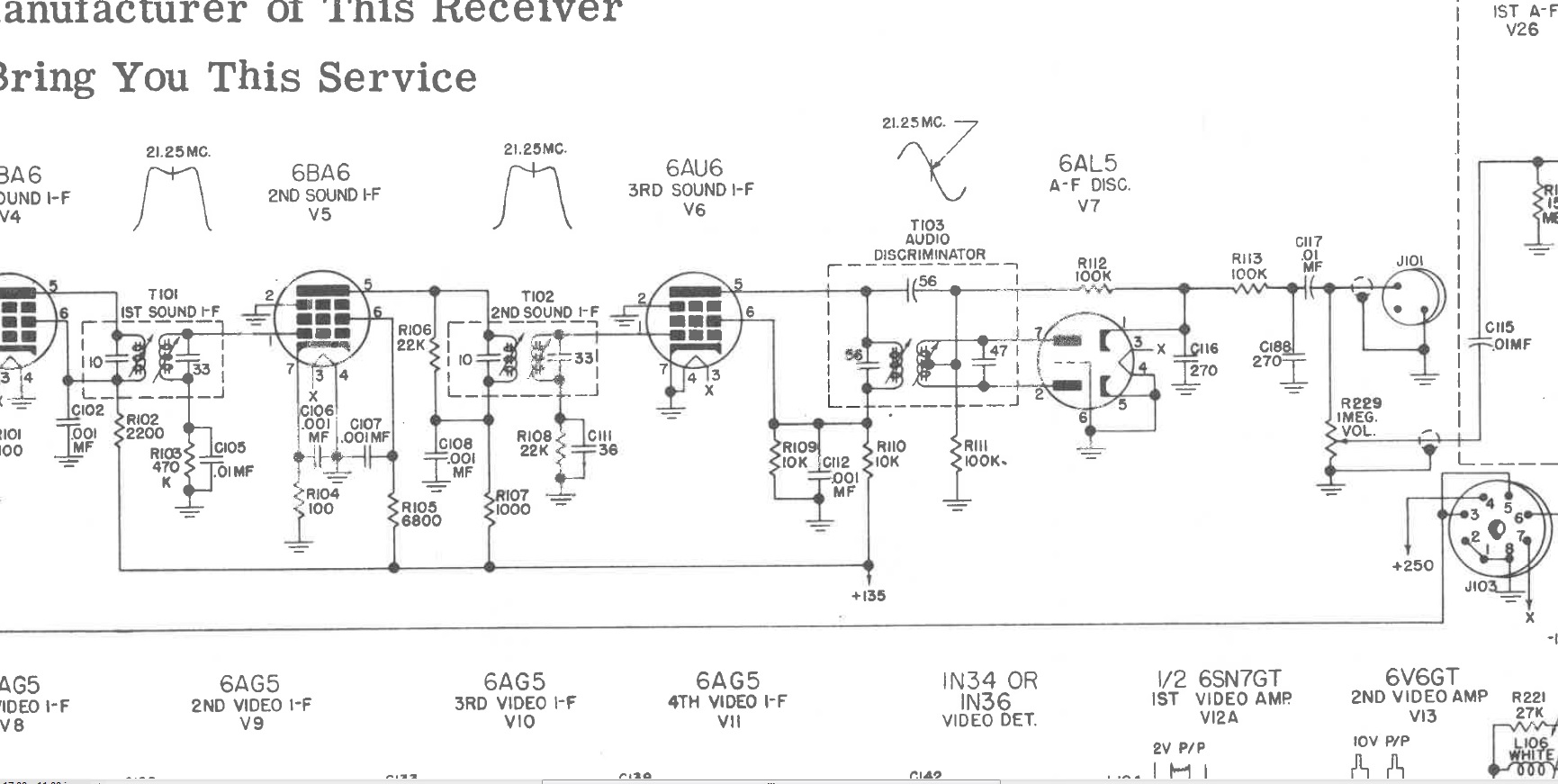

any attempted adjustment is gonna be a pain however.
http://suzaku.live-evil.org/maggie-sound.jpg
as T103 is one of those that has both top and bottom adjustments, the top is easy to get to, but not the one on the bottom without propping up the chassis and powering it up.
ONLY the sound discriminator should need tweaking, the IF 1/2 seems OK

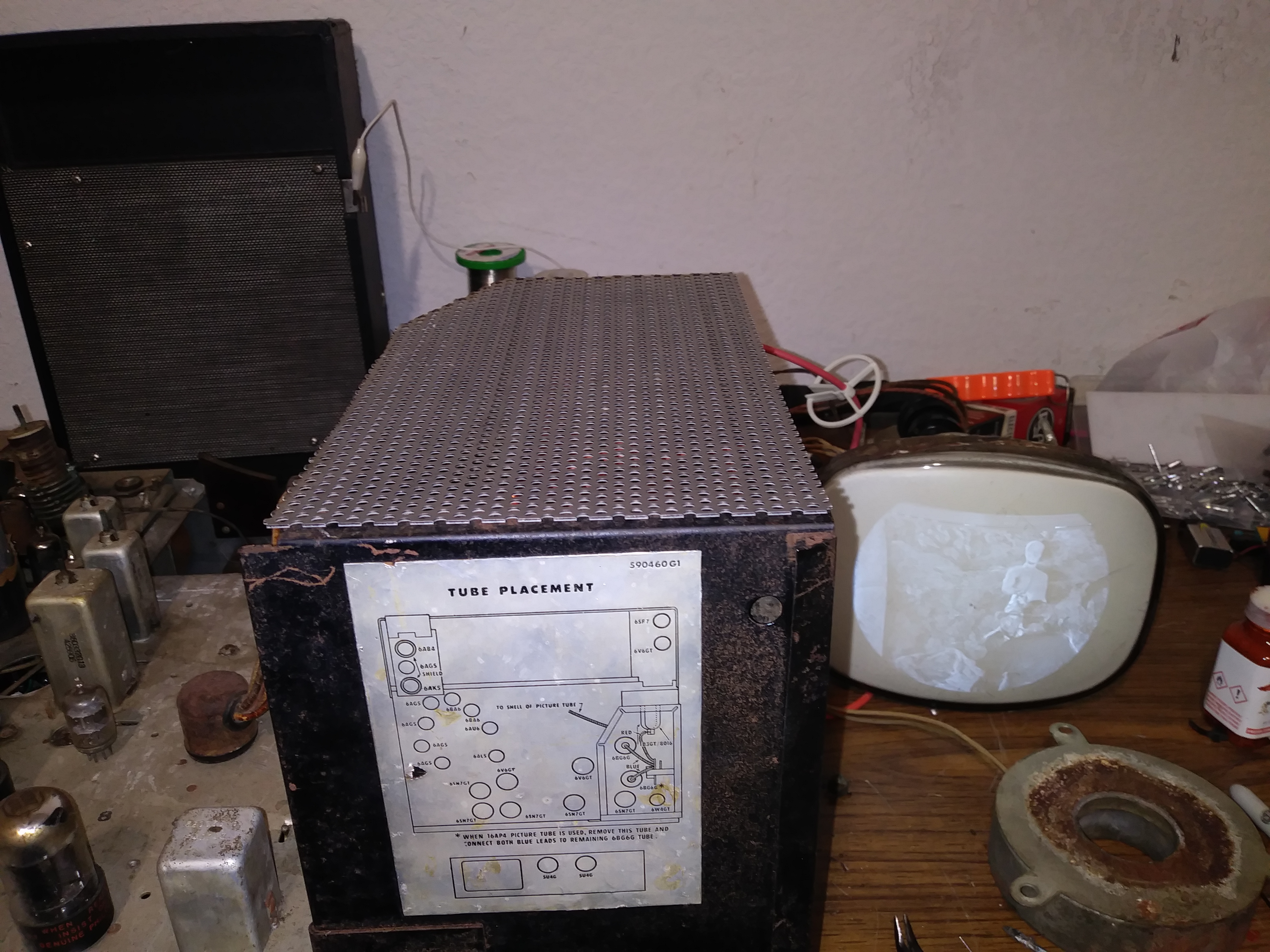

Cover for HV box made..
http://suzaku.live-evil.org/0508251932.jpg

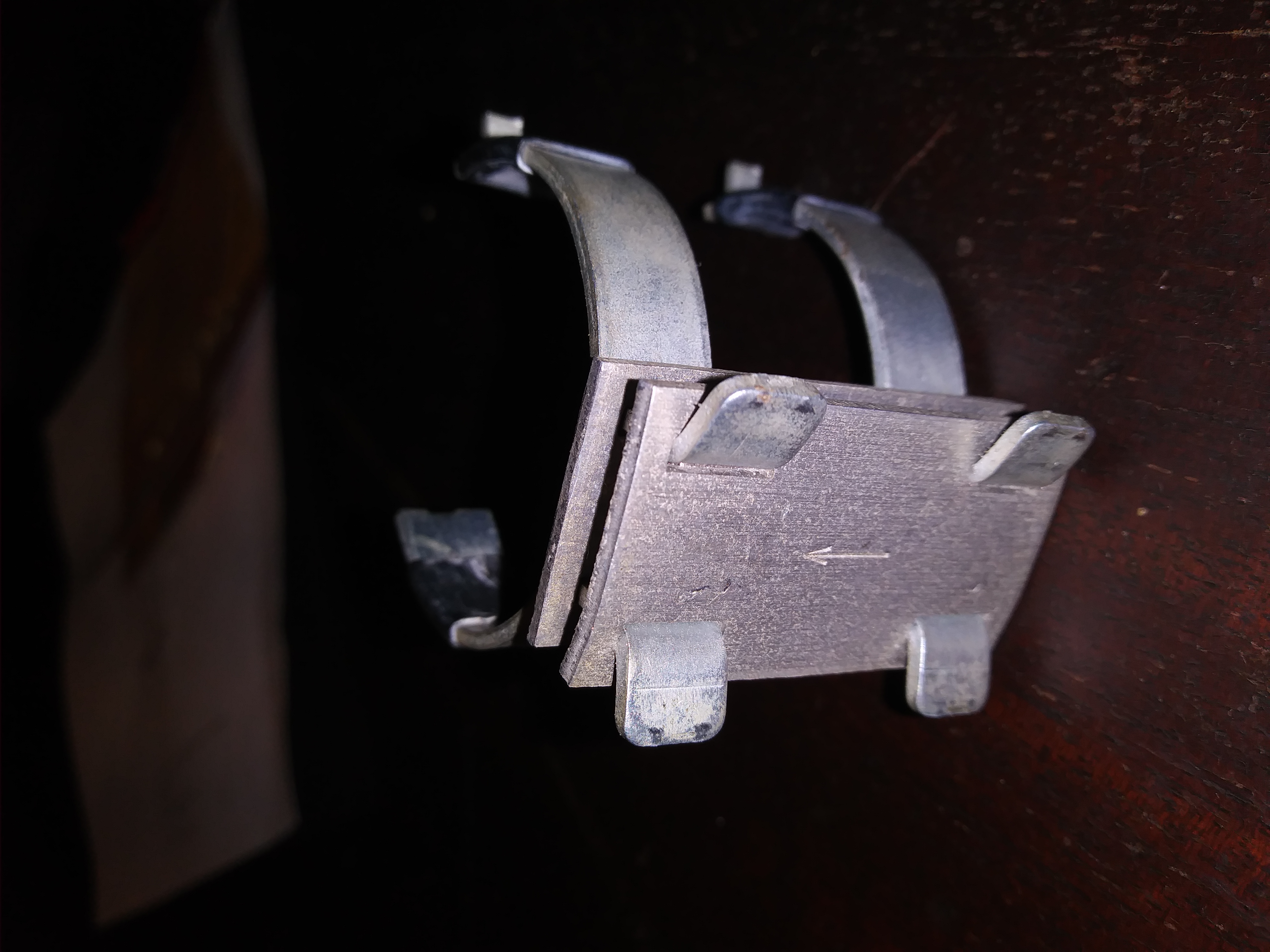

And this is the only other dual ion trap I have,
It's an after market one, not sure which way it goes
http://suzaku.live-evil.org/0508252006.jpg
I assume arrow to the screen?

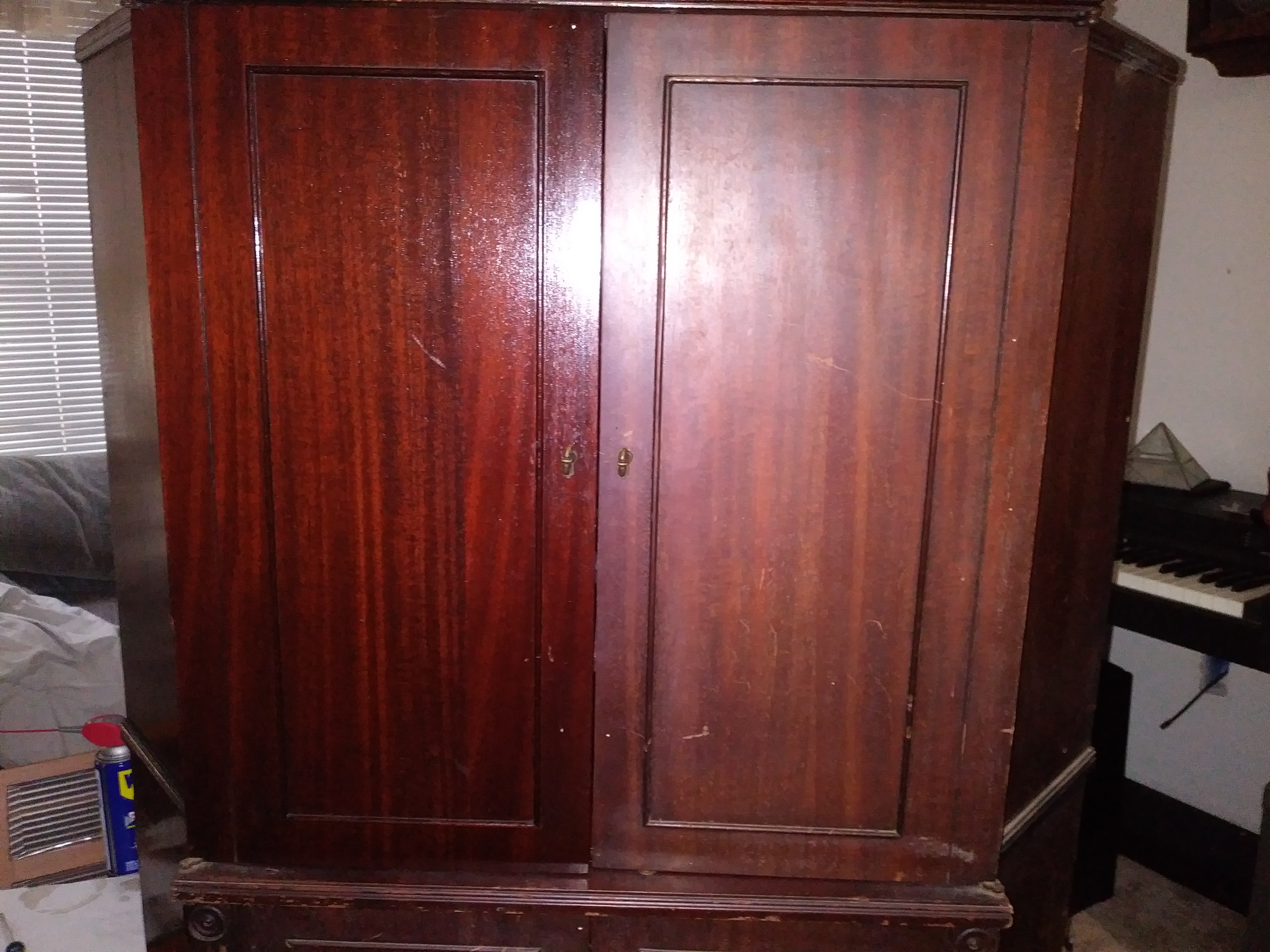

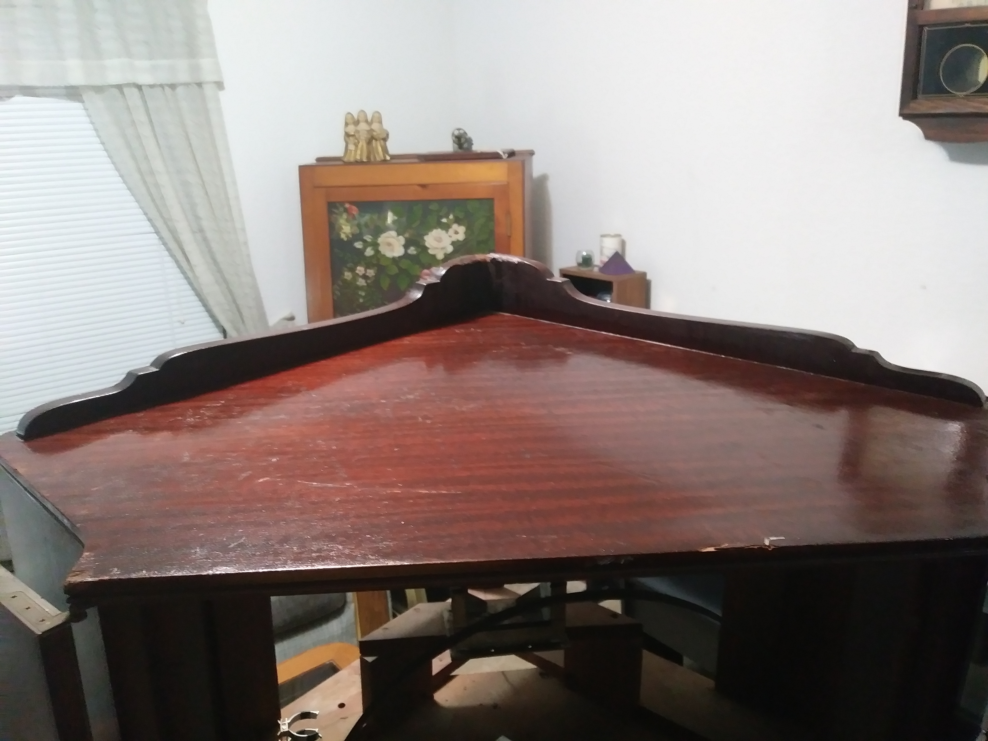

some cabinet work
http://suzaku.live-evil.org/0516252227.jpg
top looks much better, from something left in a barn /garage, exposed to elements and chewed on by squirrels, dull, dirty, dingy.
it will never be perfect, but it's better.

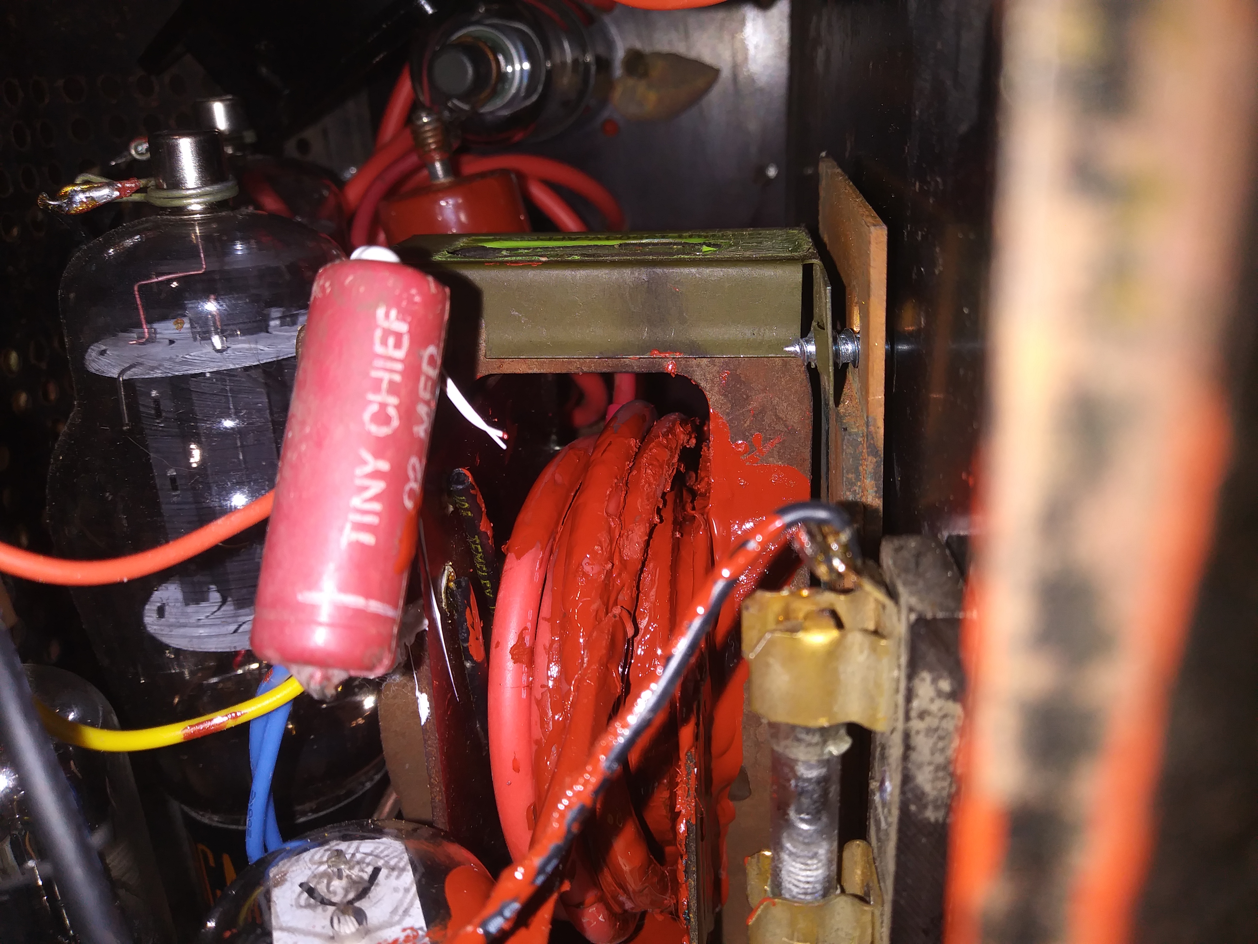

This silly FBT has started to arc to the outside core, and it;s hard getting to stop.
http://suzaku.live-evil.org/0309252037a.jpg
some of the thin wax is already gone, you can see where part was chipped away, i tried putting corona dope all over it, but it takes forever to cure, held for a little wile, and shorted again.
put more on gonna wait 1 day and put silicone on top of that, and see if that stops it.
THIS stuff...

Its a mess in there now.
http://suzaku.live-evil.org/0518251300a.jpg
but I think the coils are OK
it was arcing at the very top to the frame
the stuff it almost dry, have to push the heater wires aside to see it clearly
silicone will be here Mon, will fill in the gap when i get it.

While i wait for the Idiots at Amazon to get me my Silicone, i will do what i can with the cabinet, it will never be perfect, but a LOT better than it was!
http://suzaku.live-evil.org/0519251910.jpg
