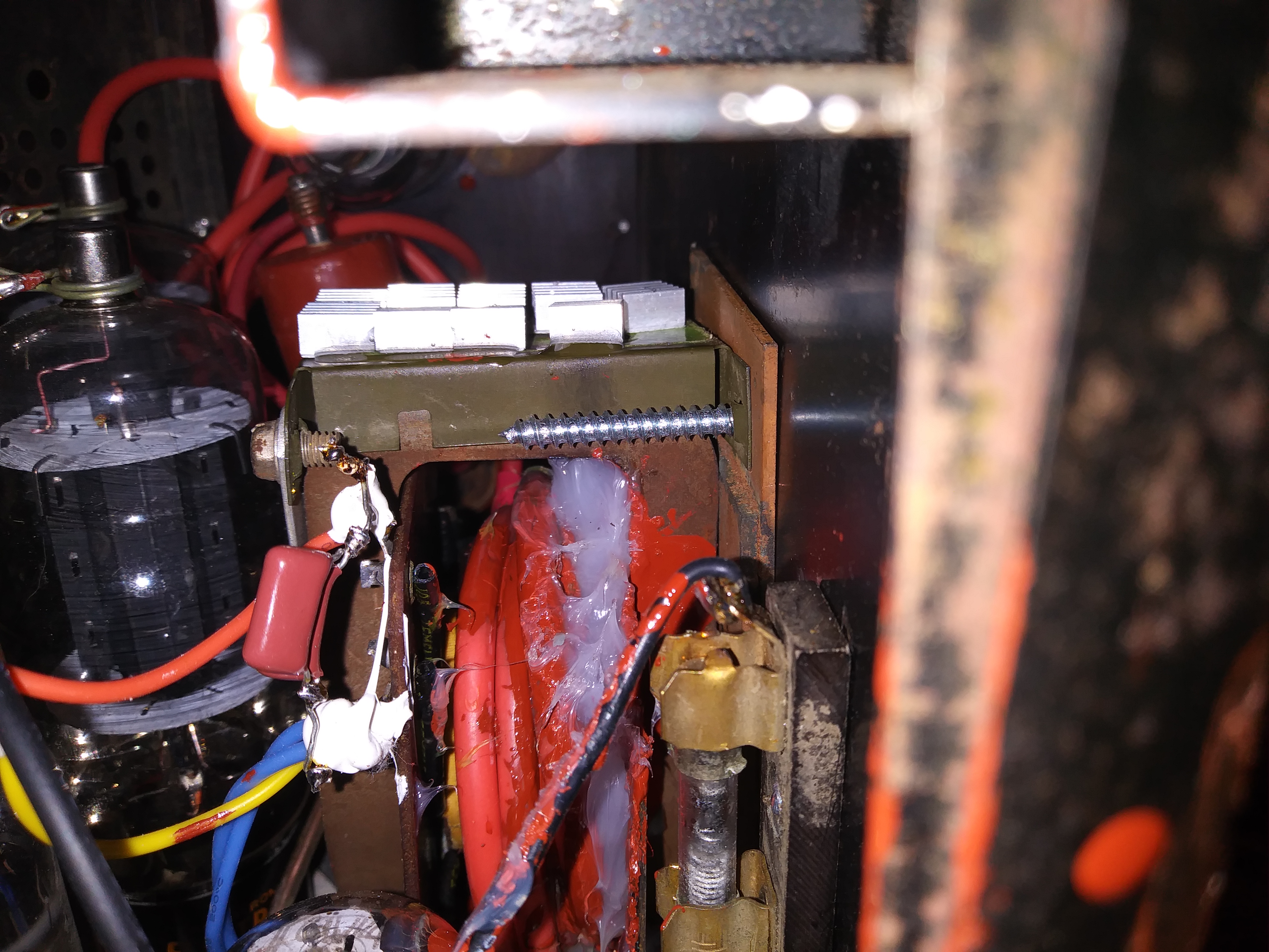

I don't think it will be able to jump that gap again!
http://suzaku.live-evil.org/0520251839.jpg
looks like crap though! but it was made from 2 broken transformers.

If this flyback transformer patch does not work, or fails again, I have found a way around it, but it would doing a “Shango066” with it, I have found a RAM type FBT made for RCA 630 circuits, 13kv output like this needs, but w/o the voltage doubler, b+ is the same, boost is slightly higher 510 vs 500, very close.
  #153
Old 05-21-2025, 08:26 PM
Posts: 3,204
Ran it for about 15 min, no smoke, no fire, no arcing, so far so good!

Ran OK for about an hour last night, no major issues seen, the FBT is getting a bit warm, i guess that they are driving it hard, not to mention there are 5 tubes around it, gonna try some small heat sinks on it and a bigger fan.

http://suzaku.live-evil.org/0527252003.jpg
So, perhaps this and a big fan will help it keep cooler? a bit perhaps. :P

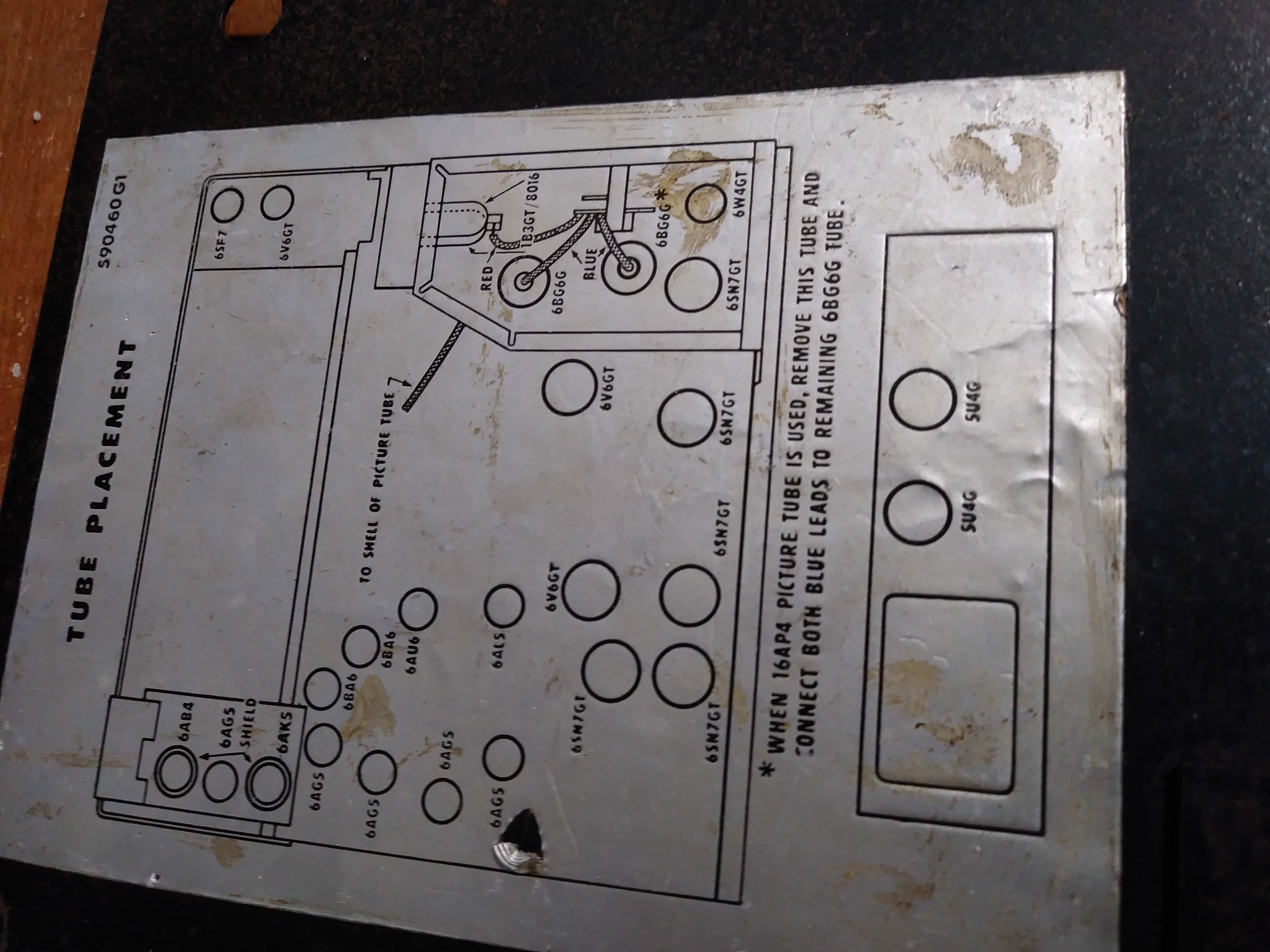

http://suzaku.live-evil.org/0528252248_Burst01.jpg
It does say to use one tube for the AP4 and 2 for the EP4, and I did get it with FP4 but am putting in a LP4 that has an angle closer to the AP4, so I guess the dual is not needed, but if it means the FBT will be cooler... who knows.

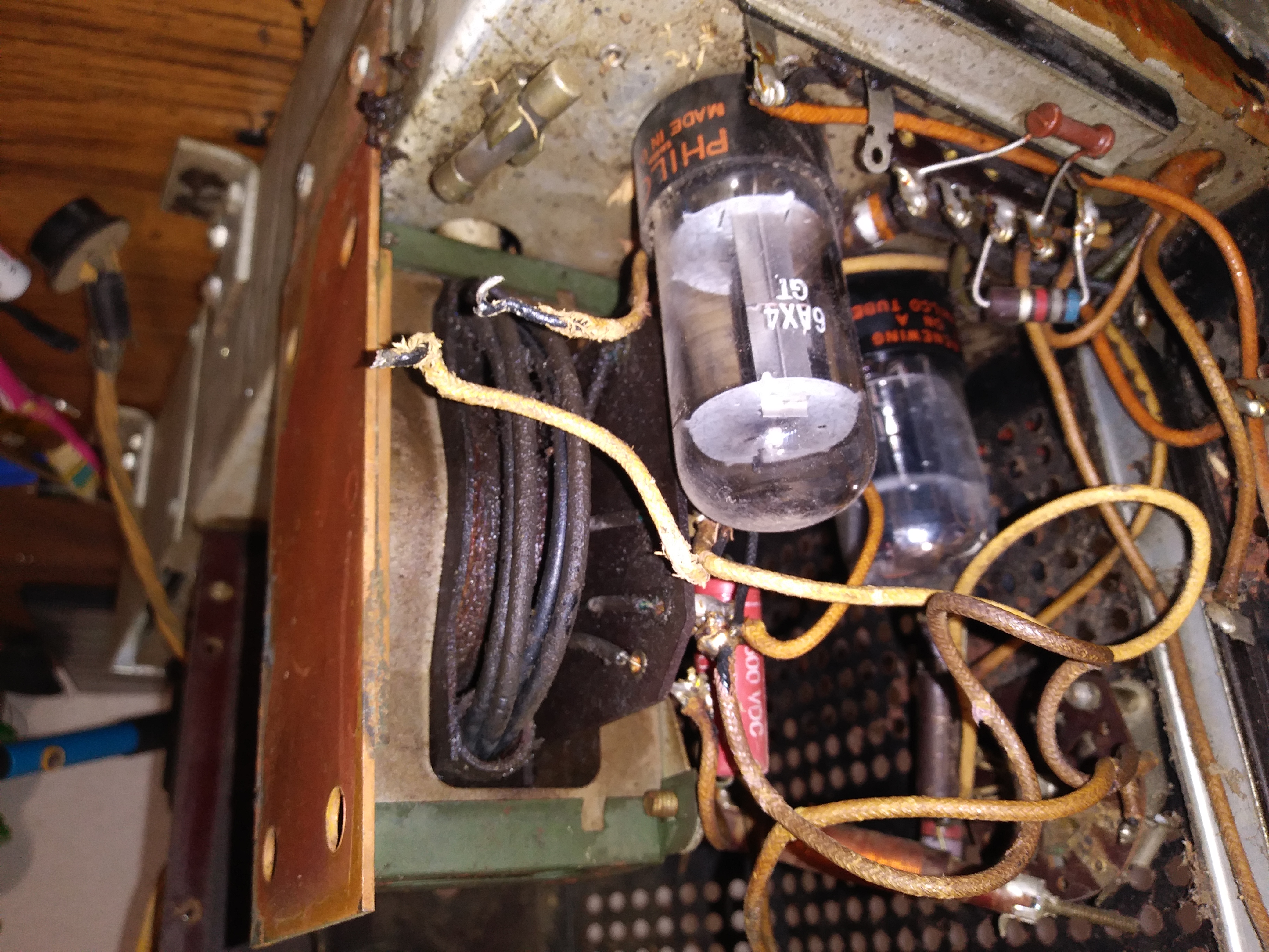

I'm starting to thing that this silly thing just runs the FBT hot, and they knew it when they made the set.
Like see the pic of the old one.
http://suzaku.live-evil.org/0226251827b.jpg
they had it bolted to that copper plate, that was not for ground, or mounting, it was to cool the damn thing off!
and even so, it still got toasted!
I'm gonna put a big Vantec 80mm Tornado Case Fan on that thing!
