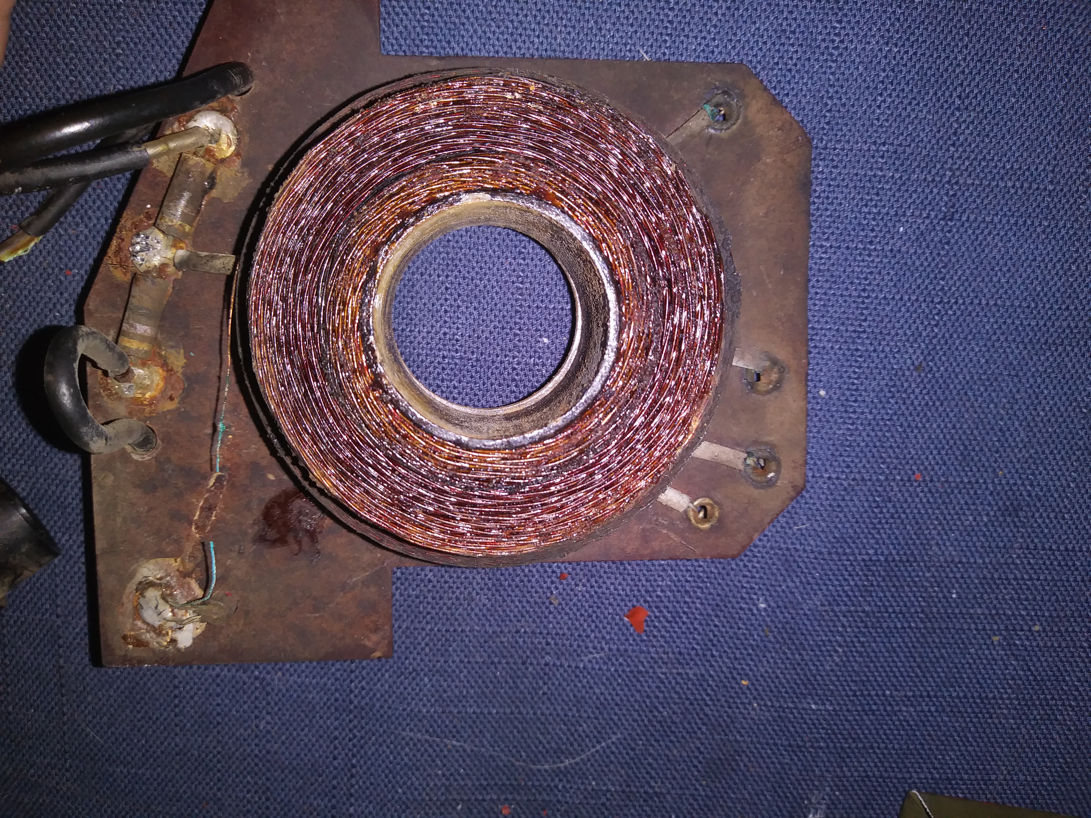

OK
first the OEM
that was in BAD shape, you can see the corroded wires and contacts, which prompted me to replace it.
http://suzaku.live-evil.org/0605251956.jpg
readings
1-2 39.5 ohms
2-3 23 ohms
6-5 0.6 ohms
5-4 6.9 ohms

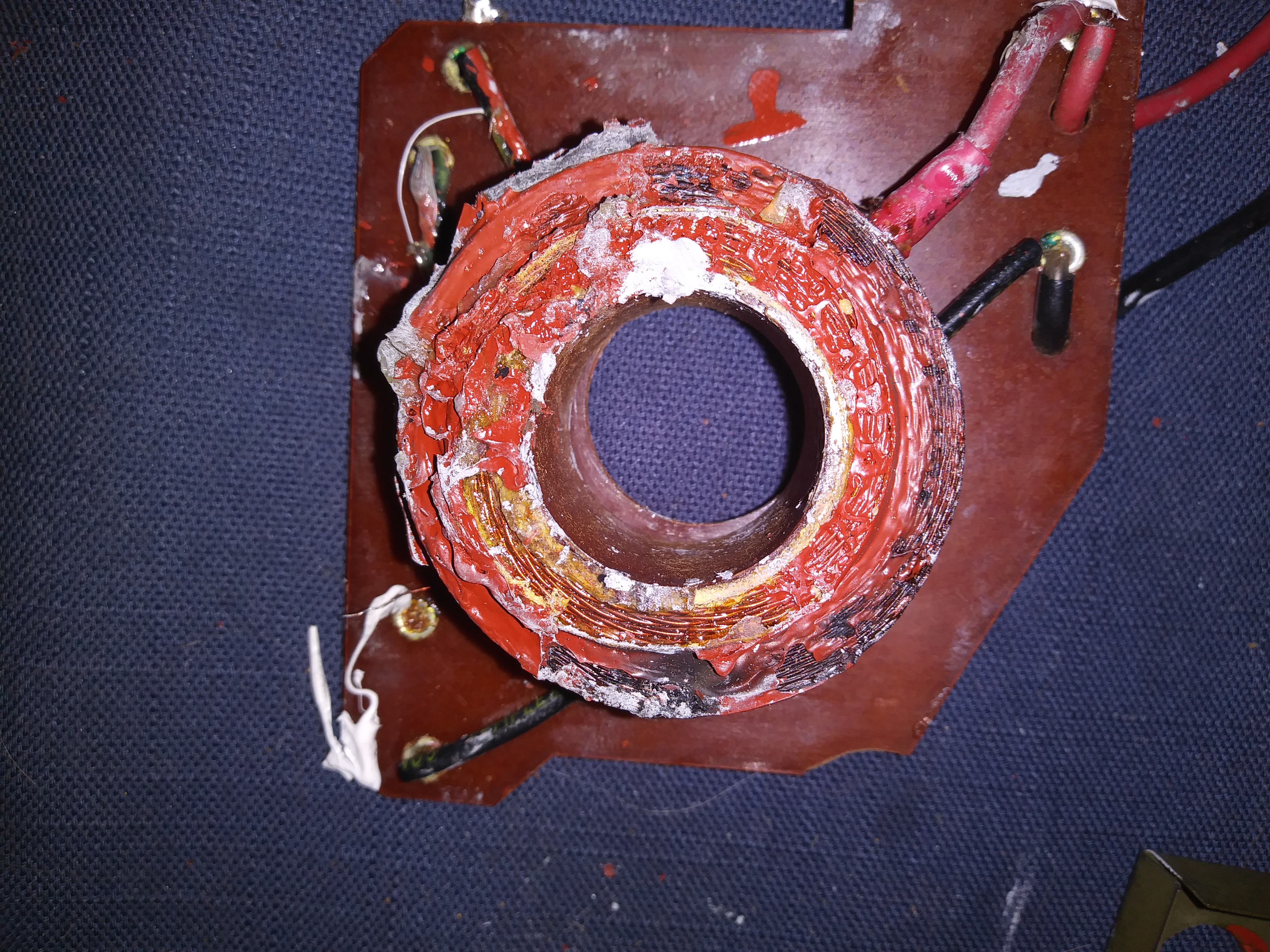

the dead hvo-5
http://suzaku.live-evil.org/0605251957.jpg
it seems to have thinner wires than the OEM for 1-2, perhaps that;s why it burned?
readings.
1-2 1.8k OUCH!
2-3 40 OHMS
6-5 .0.6 ohms
5-4 6.8 ohms
http://suzaku.live-evil.org/0605251958.jpg

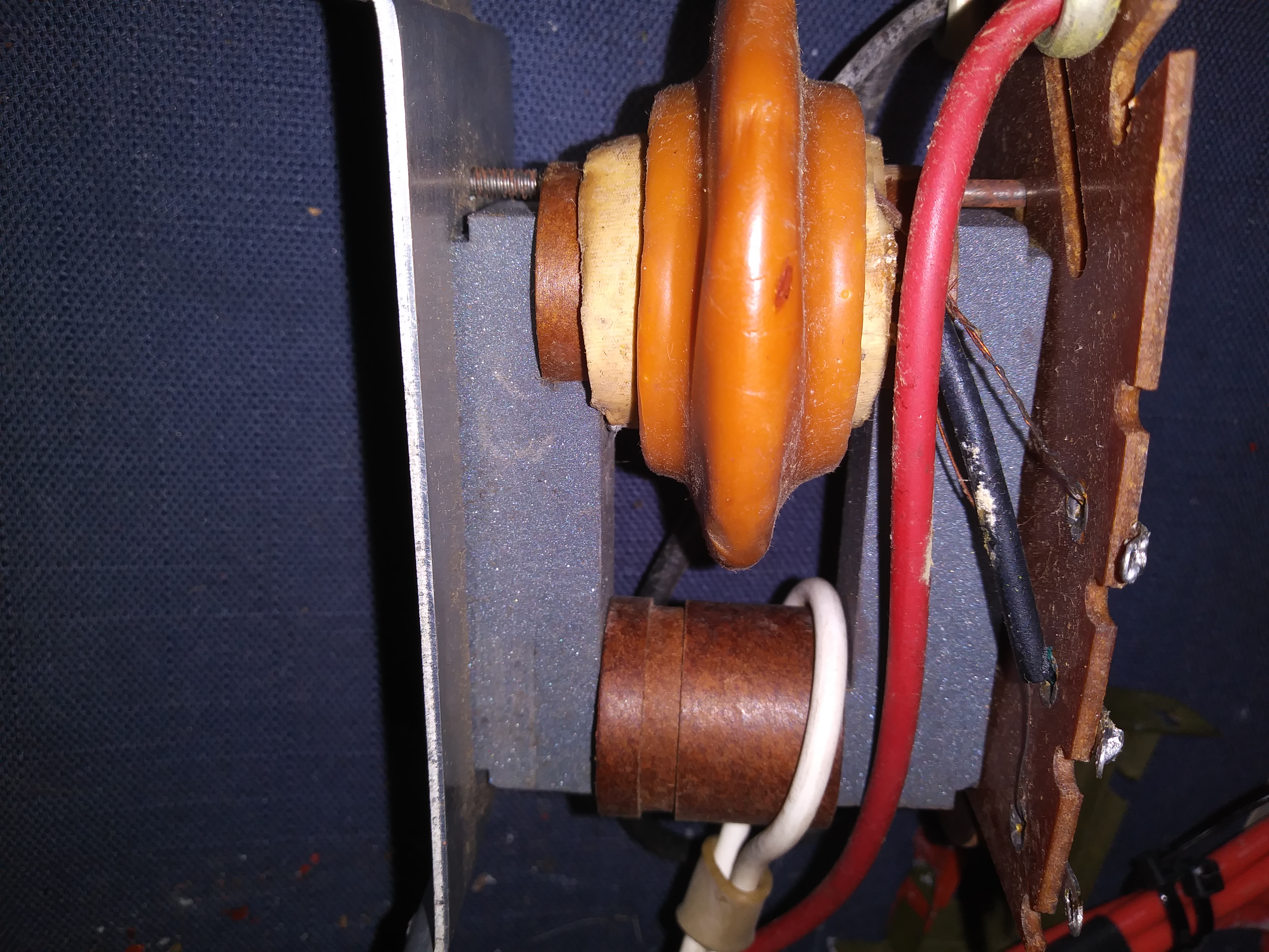

RAM 0x32
1-2 36 ohms
2-3 317 ohms not surprising since its a 13-14k, output.
5-4 0.6 ohms
5-4 6.4 ohms
5-7 9.3 ohms
one note. the heater for the HV rect has only one turn where the others have 2 , this will have to be changed.
with all this, I do think this will work, unless someone else sees something i have not.

More complicated will be the issue of proper matching with the yoke. They interact in final image width and linearity. Some are sensitive and affects the HV level due to dependence of the yoke load/resonance.
  #187
Old 06-06-2025, 08:55 AM
Posts: 3,204
no problem!
the maggie yoke is 360330-7 which the RAM replacement is Y70F08, which is the one it says to use with this flyback, so it should be OK.
  #188
Old 06-06-2025, 09:00 AM
Posts: 8,821
I would not add another loop for the HV rectifier filament. If there's enough power going though it to produce the proper deflection and HV, the filament voltage/current will be correct.
All the B&W rectifier tubes use the same filament power. 1.25v @ 0.2A.
