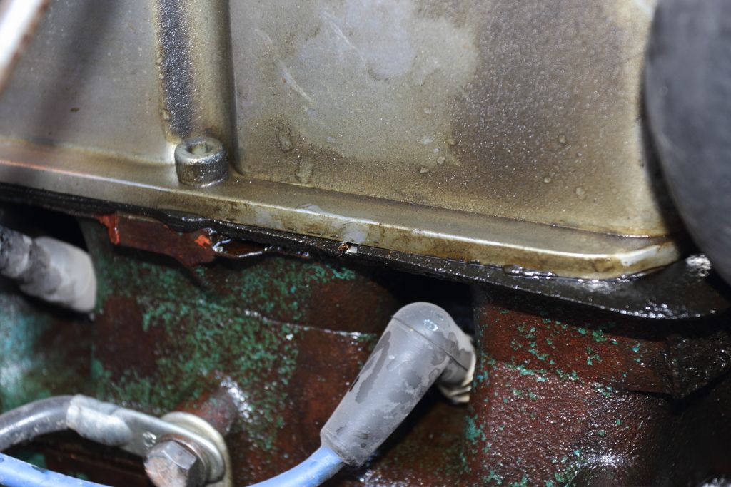

People sure were not wrong when they said the 258's valve cover is impossible to keep oiltight. It started weeping through at the back last spring but then three weeks ago I started noticing oil dripping down from the skidplate. An inspection found the valve cover was leaking towards the front and today I noticed that the gasket split above spark plug #1.
From there I can't tell if it's related or unrelated but oil is starting to appear around the harmonic balancer. If a new valve cover gasket makes that stop then I'll ignore it until I degrease the engine again but it it stays I'll have to pull the balancer off and service the front oil seal, the timing chain cover and what the hell, lets also replace the timing chain as well since we are 265000km into its life probably.

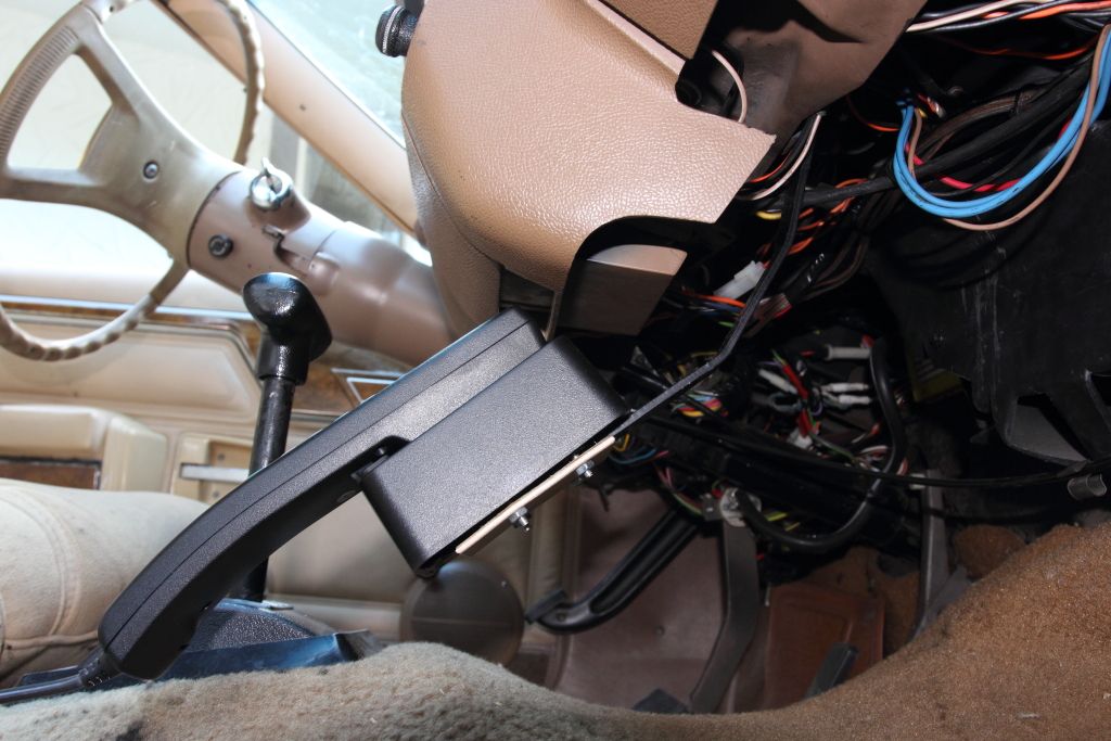

On the inside I finally got around to fabricating the mount for the Car Phone. The metal frame under the dash and above the ashtray already has a bolthole so I grabbed the most rigid piece of steel I could find and bent that into shape with a bolt welded to the end.

Is that a cork gasket on the valve cover? Cork gaskets are shit. Buy a FelPro rubber gasket, like one of the nice ones. I forget what they call them. It's like a problem solver or something like that. Molded rubber, not just die cut. PermaDry! That's what they're called.

Rubber gaskets seem to be discontinued according to Lordco, plus they are not recommended if you have the plastic valve cover still. (but I don't have that, so we're all good! )
There's a bunch of different methods to seal the valve cover and most use a lot of RTV. I could only imagine how much nicer it would be if there was an aftermarket silicone compression gasket.
My Fel-Pro gasket is the VS 50244 and it's about $40. It's different from the one you suggested in that one side of the cover only uses three bolts and less ribbing.

I'm getting mixed signals. Can't tell if that's a cork gasket or molded rubber. PermaDry would be ideal. $40 for a cork gasket is a joke. That better be a molded rubber, in which case, it's worth $40, even if it's not PermaDry. The only other thing I could recommend is to clean the mating surfaces until they are immaculate, and use only RTV with NO gasket. And it'll work. Bead size depends on whether the valve cover has an indentation for the gasket or not. If not, a 1/8" bead is more than enough.
However, it's a very long area, and it's an iron head and aluminum cover, so even the silicone will scrub through eventually. Maybe soon. Not sure.

I'm going to try an all-rubber gasket and see what happens as it was $20. the plans next summer is to take the head off and decarbonize things while inspecting what we have for wear on the lifters, pushrods, valves and replacing a few seals. We're also going to do the timing chain at the same time. If the gasket fails again we'll go with what you got.

Otherwise, the valve cover gasket got to be changed in the dead of winter which was just as fun but hey, oil consumption has stopped. Likewise the rebuilt coolant switch failed AGAIN. It didn't electrically fail or come apart but I can see oil weeping around the epoxied rim. JB Weld simply cannot handle the thermal cycling and I can't think of any other adhesive that is heat, chemical, vibration and oil resistant, so I fabricated a metal bracket which clips around the entire assembly and harness plug and presses it together.
