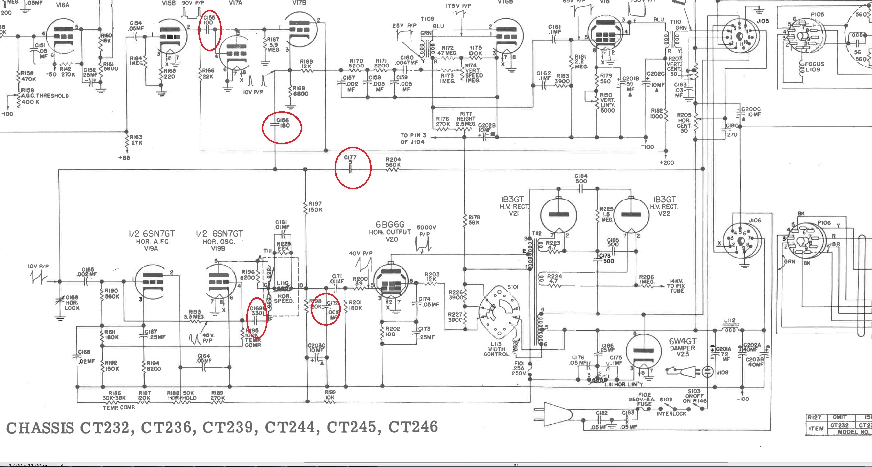

Posts: 3,204
The stupid focus potentiometer fried again, and smoked the new 560 ohm resistor that was feeding it, both being rated at 500v 5w, this happened as soon as it was mounted back to the chassis and it's ground, it had been working fine all this time out in the open, not sure why it did this, the 560 ohm resistor is hooked to the main filter choke through the H & V centering pots, (30 ohms), seems that the entire LV bias is fed through the centering pots, sort of like the early RCA sets, then the focus coil (409 ohms) / focus potentiometer & resistor then to the voltage divider network.
The only difference I see from this set and early RCAs is that RCA had the focus circuit in series with the -100v line, and this has it in series with the +250v line, other than that, they seem the same.
Since I can't get an original OEM pot, I guess I will have to keep the focus pot isolated from the chassis, and mount is elsewhere, not sure why it burned through the dielectric of the pot again, it's not like it is being hit by huge voltages or something. :/

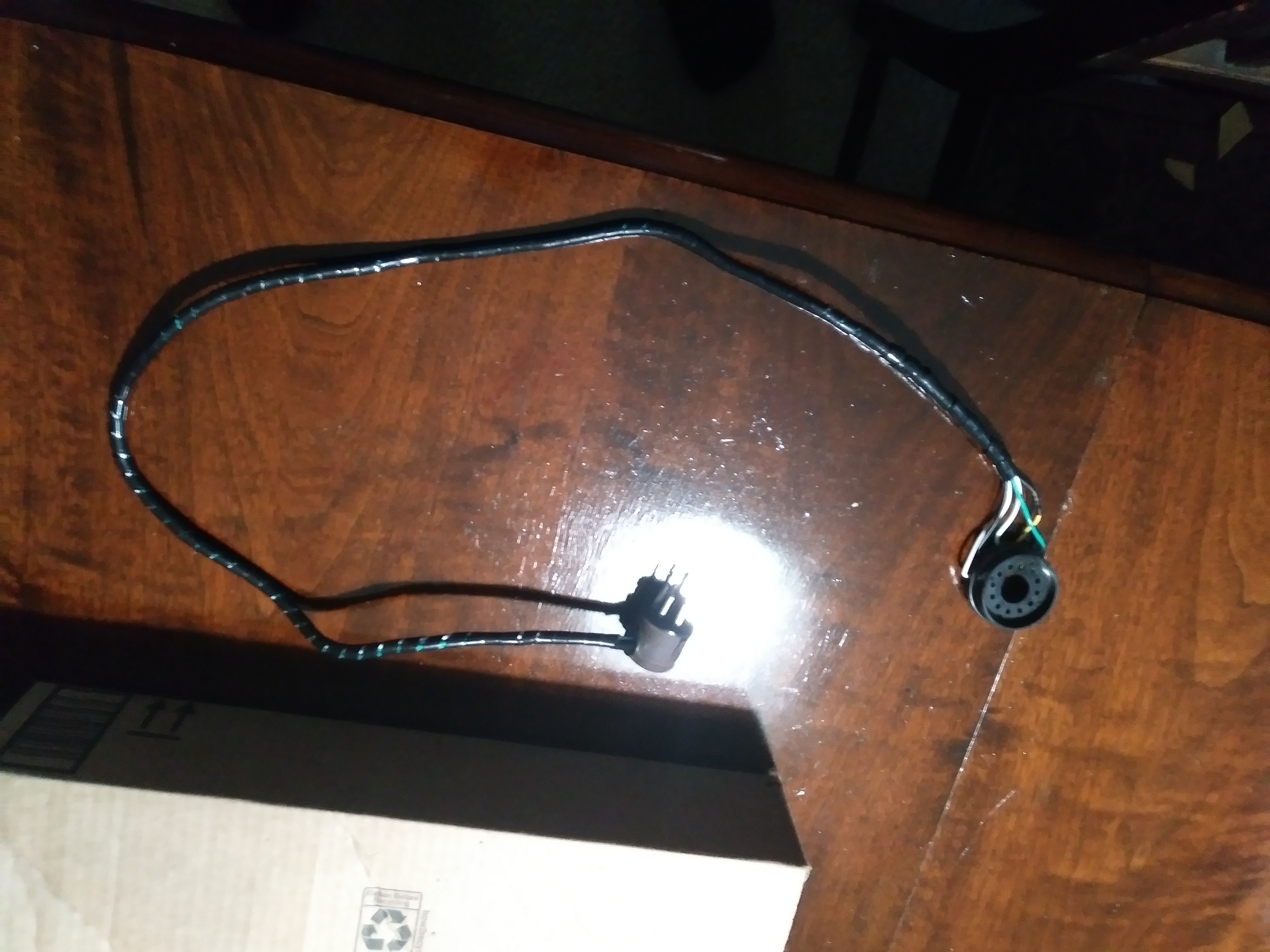

  #216
Old 06-17-2025, 08:11 PM
Posts: 3,204
old CRT wiring...
http://suzaku.live-evil.org/0616251826.jpg
vs the new.
http://suzaku.live-evil.org/0617251947.jpg
took me a bit longer to finish as the nylon wrap was delayed,

Old 06-20-2025, 11:46 AM
Posts: 3,204
Ran for over an hour last night, no smoke or fire, FBT gets a bit warm, but no dripping wax , so far.
Running OK with one output tube, the h-sync system on this seems to be VERY picky, wanting to lose lock when shut off and on, this seems to have been very common as it looks like the “ horizontal speed” slug had been turned very VERY often before I even go it, not sure how to get this more stable, though it SEEMS to be rather locked now, only time will tell.
Not sure what else to hit with this silly set, all the paper bombs are replaced, resistors are in spec, only thing left are the mica caps in the area, but, they rarely go bad, right?
I don't want to mess with them if i don't have to.
  #219
Old 06-20-2025, 02:50 PM
Posts: 15,466
Sweep micas do fail (in electrostatic deflection sets they're almost a must replace proposition) and they aren't critical to alignment so they're worth replacing if you can't test them to their ratings and everything else has been verified.

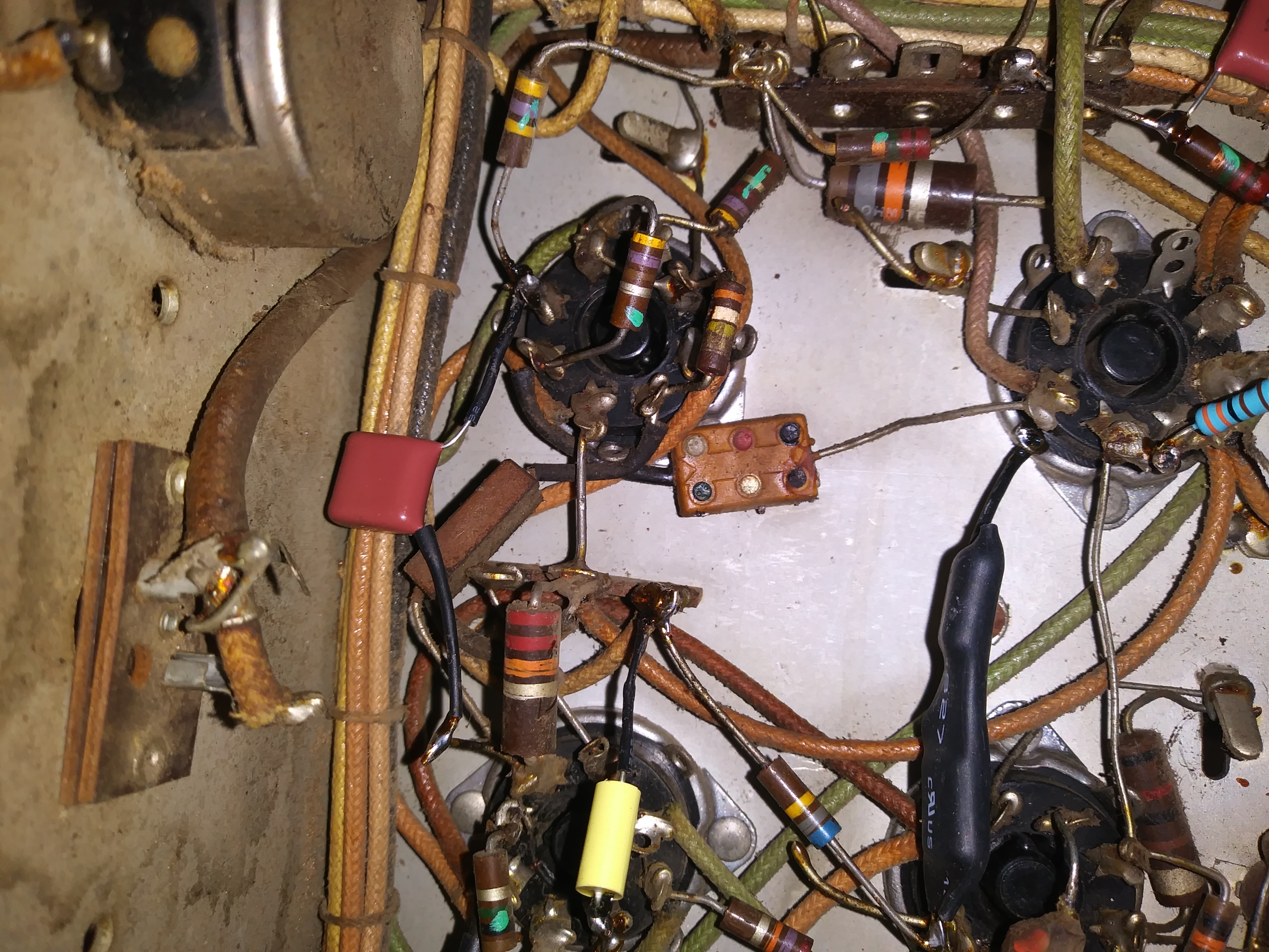

Old 06-21-2025, 01:43 PM
Posts: 3,204
Well it seems stable at the moment.
But it has 5 of the old domino type mica caps in the area.
http://suzaku.live-evil.org/magie-mica.jpg
2 of which I ordered, but not put in yet.
mouser-
598-CD15CD050DO3F
598-CD19FD331FO3
To replace or not to replace, thus is the question!

Old 06-21-2025, 06:16 PM
Posts: 3,713
mouser-
598-CD15CD050DO3F
598-CD19FD331FO3
In the sweep I would replace them for sure they do take a beating.

  #223
Old 06-24-2025, 08:06 AM
Join Date: Jan 2021
Location: Brazil (Paraná)
Posts: 515
In oscillator places is good to maintain same dieletric due to tempco, or oscillator will drift distinctly than the original one.
EDIT: that said, some are non-critical ones and not suffer from change.
  #224
Old 06-24-2025, 08:32 AM
Posts: 15,466
ordered and about to ship.
Mouser parts.
5982-15-500V180
598-CD17FD101JO3F
598-CD19FD182JO3F
to go with the ones i have.
598-CD15CD050DO3F
598-CD19FD331FO3
These Mica caps sure are $$$ compared to film types. :O
In sweep circuits you can usually get away with C0G ceramics in place of micas. If there's a published or readable temp coeff for the original matching that is probably best.

Old 06-24-2025, 08:44 AM
Posts: 3,204
I can't really tell what they have in there, other than the parts list says the value and 500v, thus I picked 5% parts, which are most likely better than what is in there, the dots on the old caps are so faded, they are almost unreadable.
