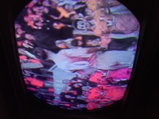

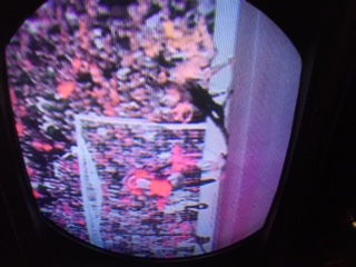

As you saw with the posted pix of my RCA when I was working on color, with the color all the way down, you should see no color bands/ rainbows, just a BW screen, if setup is right, and very strong red / greenish bands if its all up and no lock, for some reason your color is looking very weak.
This is not related to the oscillator, if you have rainbow bands, it means the oscillator is running, but not able to lock.

So after changing the xtal besides the oscillator is there something else to adjust to get all the colors back I sent 2 more pics

you had lock on the old crystal!

Did you get the 2 more pics they have color in the pics except blue

http://suzaku.live-evil.org/IMG_1035.JPG
http://suzaku.live-evil.org/IMG_1037(1).JPG
You had lock here, the wrong colors is another issue.
put the crystal back that got you this pic.

These pictures are from the new crystal the new one is in and I degaussed and this is what I have

If that's what you have now, the new one, and it is locked in well, the next step would be to set the tint to center, and tune A19/L31 till the colors are correct, if you cant get them right, there are other issues.
