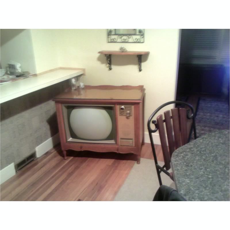

Wondering if the 24NC31 chassis Zenith cabinet has some vertical decorative wood trim on the back edge and partially on the side edges of the top of the cabinet? If so, this seems to be the model Zenith my parents bought as their first color TV in 1965! Been looking for this particular set for sentimental reasons for YEARS!!...Nice find, wish I was closer, would love to make a deal on it with you

Is this the style you are looking for? Early American I believe?
From Captain Video, 1/4/2007
That is the style of the top of the set I was speaking of, but the rest of the 24NC31 chassis Zenith cabinet as shown in Marty59's photo is exactly what my family's first Zenith color TV set was...Brings back a lot of great memories just seeing it! Was a very solidly built set; my brother and I use to climb on top of it and jump off it over and over again, and it never budged!
