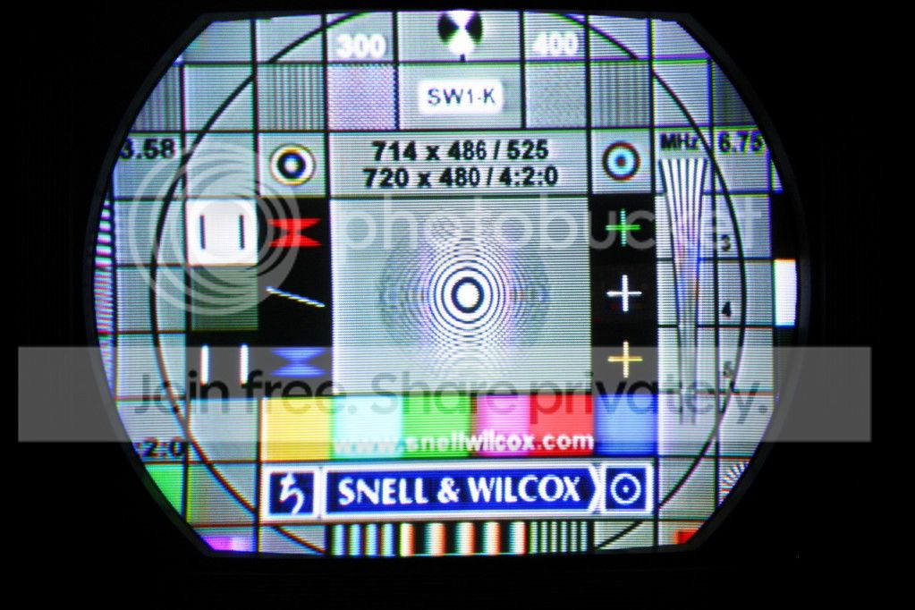

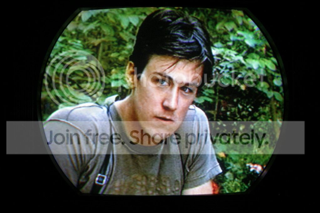

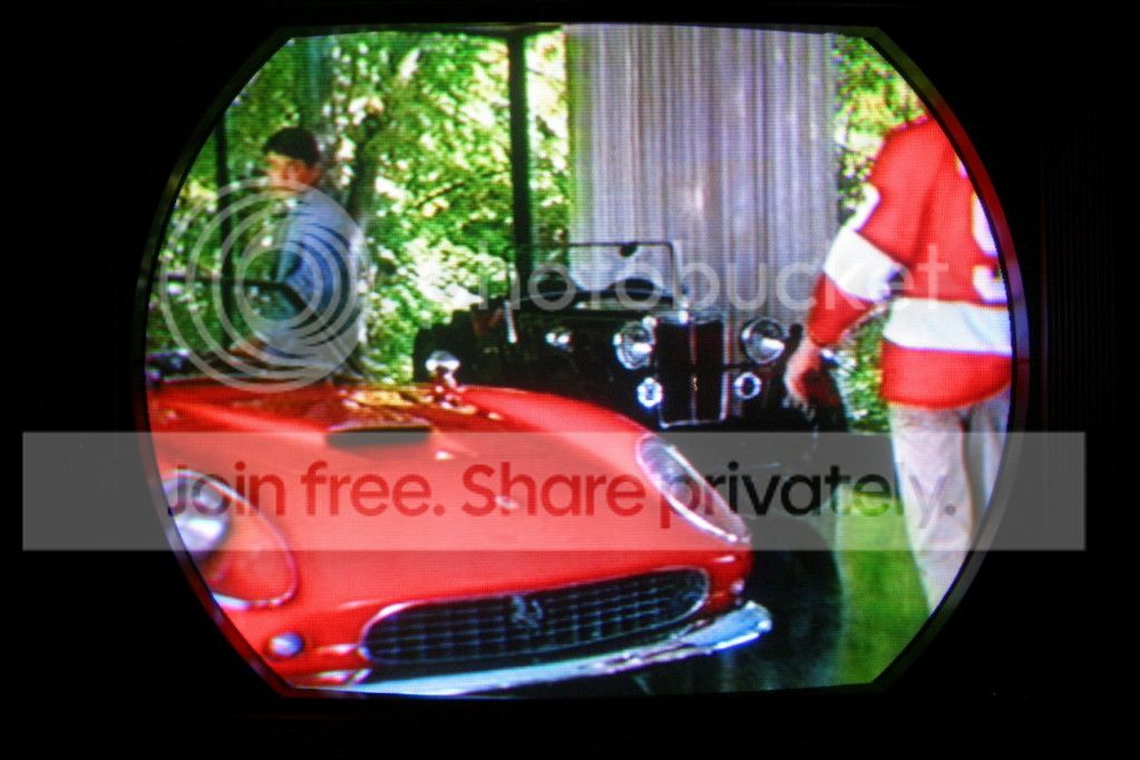

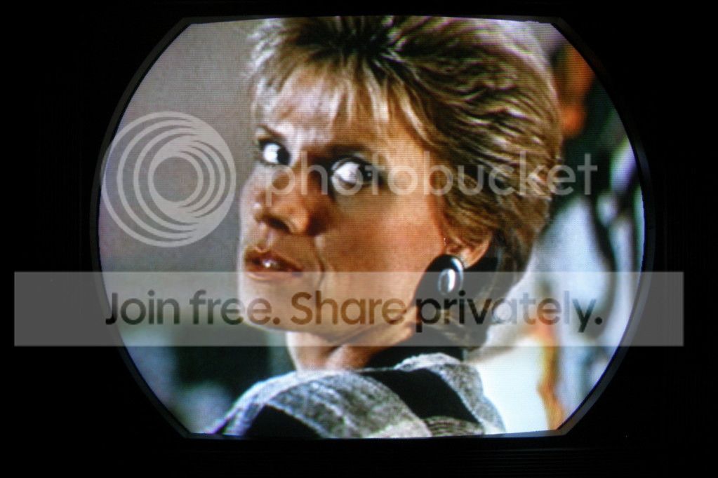

More BIG Screen Shots
Got back to the 21CT55 after 16 weeks “sanitizing” my “bought new” 1980 BMW 320i sports coupe. The CRT set came right up with nominal voltages, same as last operating. At 115vac in, B+ is 420v, Boost is 750v, FBI is 190ma, Ultor is 28kv and Focus is 5.1kv.
Took a few screen shots with my Olympus SP550UZ on full auto from 64in distance at 120 iso, 1/6 sec, 3.9 F.

That is a really good picture, and very good convergence..... Nice job....
And really good pictures....

Is that line pairing on the test pattern, or just a fast shutter catching one field?
