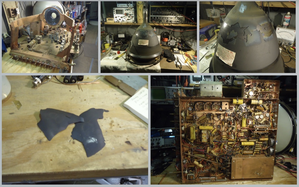

UPDATE, August 12, 2018
From Mike. OK, onward to removing the chassis and crt. This will be sent over a few emails due to the number of pictures.
Pictures 1 and 2 Front panels and knobs being removed.
Picture 3 Broken knob (the white one). Not sure of its function just yet.
Picture 4 Chassis on the bench. Note: there were NO chassis bolts holding the main chassis to the cabinet. The power supply chassis is mounted in the lower part of the cabinet and it will be removed soon.
Picture 5 and 6 show magnetic shield mis-alignment bottom and then top. I believe when this piece is properly installed it should mate nicely with the other parts.
Picture 7 These pieces fell out from under the chassis as I removed it from the cabinet. One screw that I might likely find the place for later, the second looks like a tuning slug from one of the tuned transformers. (the next picture shows where this possibly came from). And then, what looks like a broken tuning slug core from some tuned transformer.
Picture 8 a tuned transformer with seemingly a missing tuning screw. The core piece may be inside the transformer.
Picture 9 Chassis top left.
Picture 10 Degassing coil plug.
Picture 11 and 12 Disconnecting the High Voltage connector.
Picture 13 Blocking the face end of the crt before removing screws. This insures minimum loading on the neck of the tube as the screws are removed.
Picture 14 Removing the necessary 3 screws on each side to unmount the crt from the chassis.
Picture 15 CRT removed.
Picture 16 CRT on bench. The tube will be boxed and placed in another building with my other CRT’s until I am ready for it later in the restoration process.
Picture 17 Serious issues with the quality of the aquadag on the CRT.
Picture 18 These flakes of “DAG” were found on the chassis after the crt was removed. I guess it’s a good thing that I purchased a supply of aquadag liquid from Scott Avitt before he closed up Hawkeye. This issue, I’m sure, will be a very easy part of the restoration process.
Picture 19 The chassis bottom.
Thus far, I have been doing some thinking on how this restoration will go. I will be doing this one a lot differently than ever before. Most of the repairs will be done without a crt at all and using only test equipment to breath life back in to the individual circuits. That way the CRT stays “safe” until I am ready for it. I may use a monochrome crt mounted to the chassis for some of the testing process. The signals from the individual circuits can then be patched in to the monochrome gun one at a time so the quality of the images can be seen as needed. This way, the Luminance and Chrominance signals can be evaluated without the use of the 15EGP22 being in the set.
Let the games begin.
Mike

Posts: 15,473
Slip plate is a good substitute for aquadag...It is just a paint on conductive coating so dag flaking is not an issue for an unrestored non-working set. (were the set run with flaking dag there is risk of the fallen flakes causing shorts on the chassis, and if the flaking leaves dag islands or disconnects the ground connections for the CRT that could be bad) Any competent TV restorer knows to handle dag issues before power up.

I’d like to point out in pix# 2, a user “convergence” control. Pix#8, notice the cable leading to rear mounted hue control. I’d like to rig the cable forward and exiting at the bottom of the cabinet. In this way I can actually see the adjustments on the screen. The mirror idea seems ridiculous on a restored set. For purists, we can easily restore to it’s original position. Pix #13, blocking while releasing tension loading.
We shall see as the restoration progress’s.

Has Mike even looked at the schematic for this set?
That isn't a degaussing coil; it's the field neutralization coil. A small amount of DC current passes through it to help counteract the existing magnetic field at the face of the tube (from the earth itself etc) to allow for decent purity.

From Mike late last night: I have been studying the Westinghouse documents and learned that the degaussing ring on the front of the crt is in fact the opposite. Interesting to me, it is a gaussing coil that actually sets up a magnetic field that is adjustable, at the faceplate of the tube. So, I think we can change the wording on the page. IF I learn differently I will let you know. And again, Let the games begin. This will likely be the biggest accomplishment yet for me in my restoration projects. I remain optimistic. And it looks like I have a lot of parts to order for this one.
A piece of the wiring fell out of the high voltage cage when I set the chassis on the bench. It looks like a wire from one of the filament leads to a high voltage rectifier but I have yet to figure it out for sure. Also, I noticed that the metal cover is missing from the high voltage cage on the right side. This will be easy to make but it will not be of the original material unless I can find copper clad of that size locally. Not a big deal, just an observation that I will have to deal with. I suspect that a tech has left it off to give more cooling to the flyback. Maybe not a bad idea to leave it off but we can discuss that sometime.
