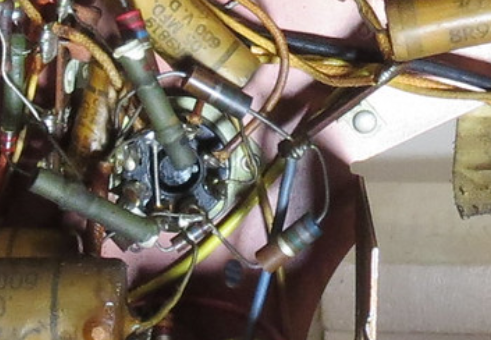

Rats! After running about 10 minutes, reception dropped off considerably. I hate chasing down intermitent issues. No tapping or wiggling helps. Only leaving it off for a while helps.
Wow is that ever a minty little Motorola.
As for intermitents, have you tested these two resistors warm? 6 megs and looks like they toasty.

No, but I did measure all the resistors in the HV divider cold. They're within spec, but all have between 600 and 1,000 volts across them. They appear to be 1 watt resistors which have a max spec of 500 volts so I suspect all of them.

OK, time to stop screwing around and get out a scope!
I monitored the output of the detector and waited for the image to fade out.
Sure enough after about 10 minutes the video signal dropped to almost nothing.
DC voltages and waveforms in the IF seemed OK so I went after the detector assembly. I took the covered off and hit it with a little compressed computer duster can turned upside down to cool it. Bam! image was restored
Now, I just need to determine if it's one of the resistors or the 1N34 diode. My bet is on the diode. I'm not wild about having to perform microsurgery to replace it, but I'l give it a try if I have to.

My bet is on the detector diode too. I've had a bad one in a VT-71 before and I've seen others have it go on that model too.
I'd just snip the leads fish it out then do the soldering to reduce the chance of overheating or physically damaging the other parts there.
The nice part about the video detector is that unless someone decides to open the can it's in for some reason nobody else will ever see the modern replacement.
I have had the same issue with that diode. Remember it is an ancient germanium diode. I replaced mine and the picture was immediately restored.

Yes, it was the diode. It measure open in both directions. Replacing it with this germanium diode did the trick.
