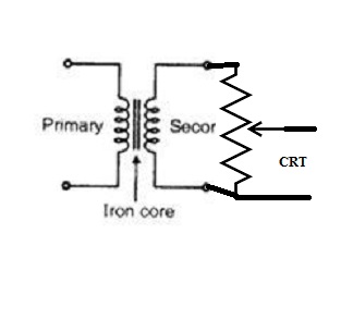

The way that Bandersen describing is one way to do this, the adjustable power resistor is another.
Using a resistor such as, https://www.digikey.com/en/products/...WA210/11644319
Very cheap at under $7, and 1k won't put any real load on the filament transformer at all.
To be wired up like so, http://suzaku.live-evil.org/CRT-POWER.jpg
And starting with the resistor slider set to the lowest extreme, (0 volts) just slowly raise it up until you get the 0.55 volts you need on the heater for the tube.
This is how I'd do it anyway.

So using the 1k adjustable resistor there may not be enough current and the question is would there be a large surge upon turning it on for a nano second which don’t take much to open a heater filament like this one @ only.55v ideally I would like to measure voltage & .830v then plug the tube in and see .50v or alittle more but I can’t do this because no load shows full voltage.
Old 05-16-2023, 10:36 AM
Posts: 3,204
1k on the filament transformer places no noticeable load on it at all, especially with the heater being 3.4 ohms, with the CRT unhooked, the transformer and resistor should hardly get warm at all, and all power would go the crt when hooked up and adjusted right.
