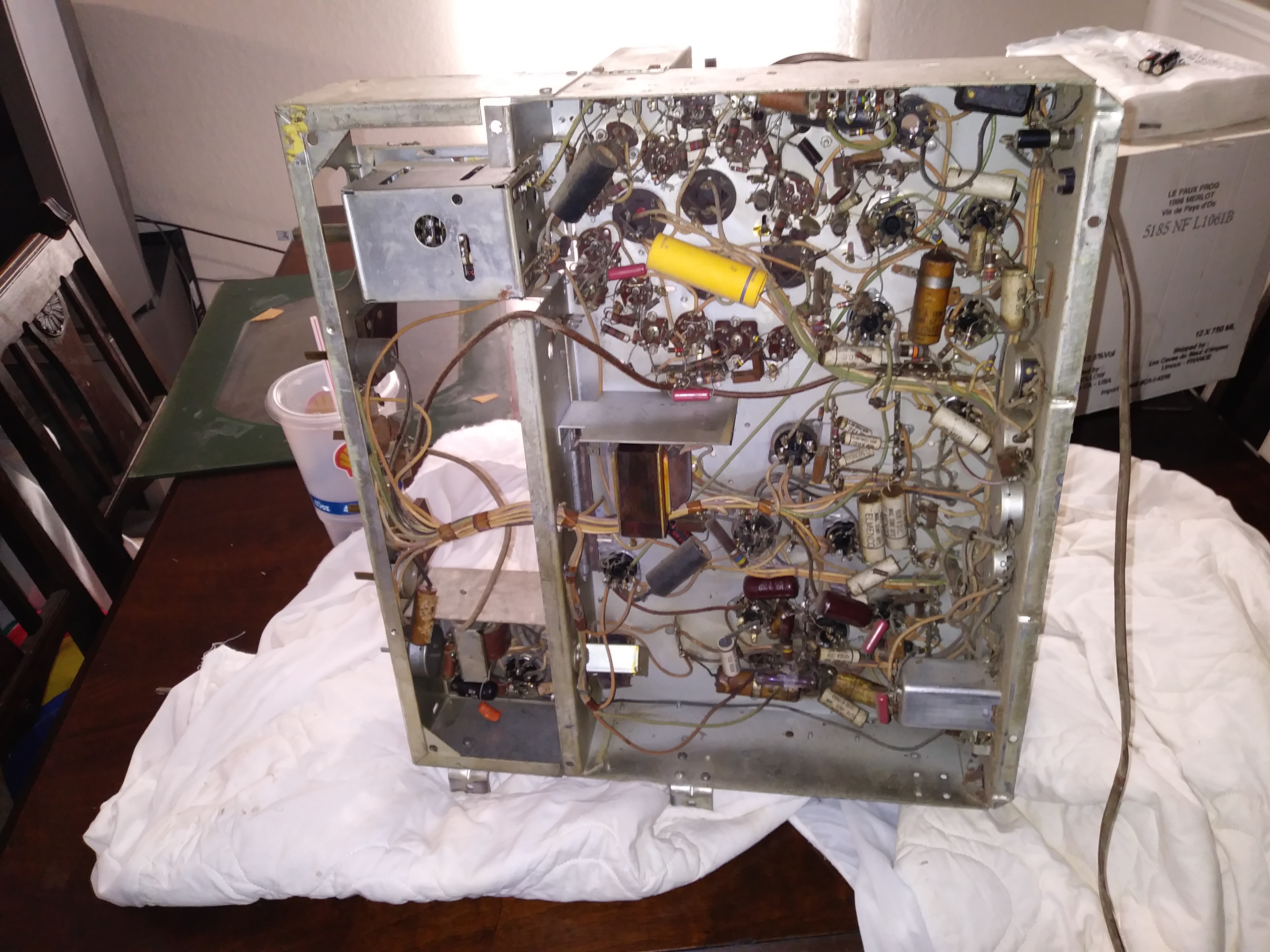

Chassis removed.
http://suzaku.live-evil.org/0223251338.jpg

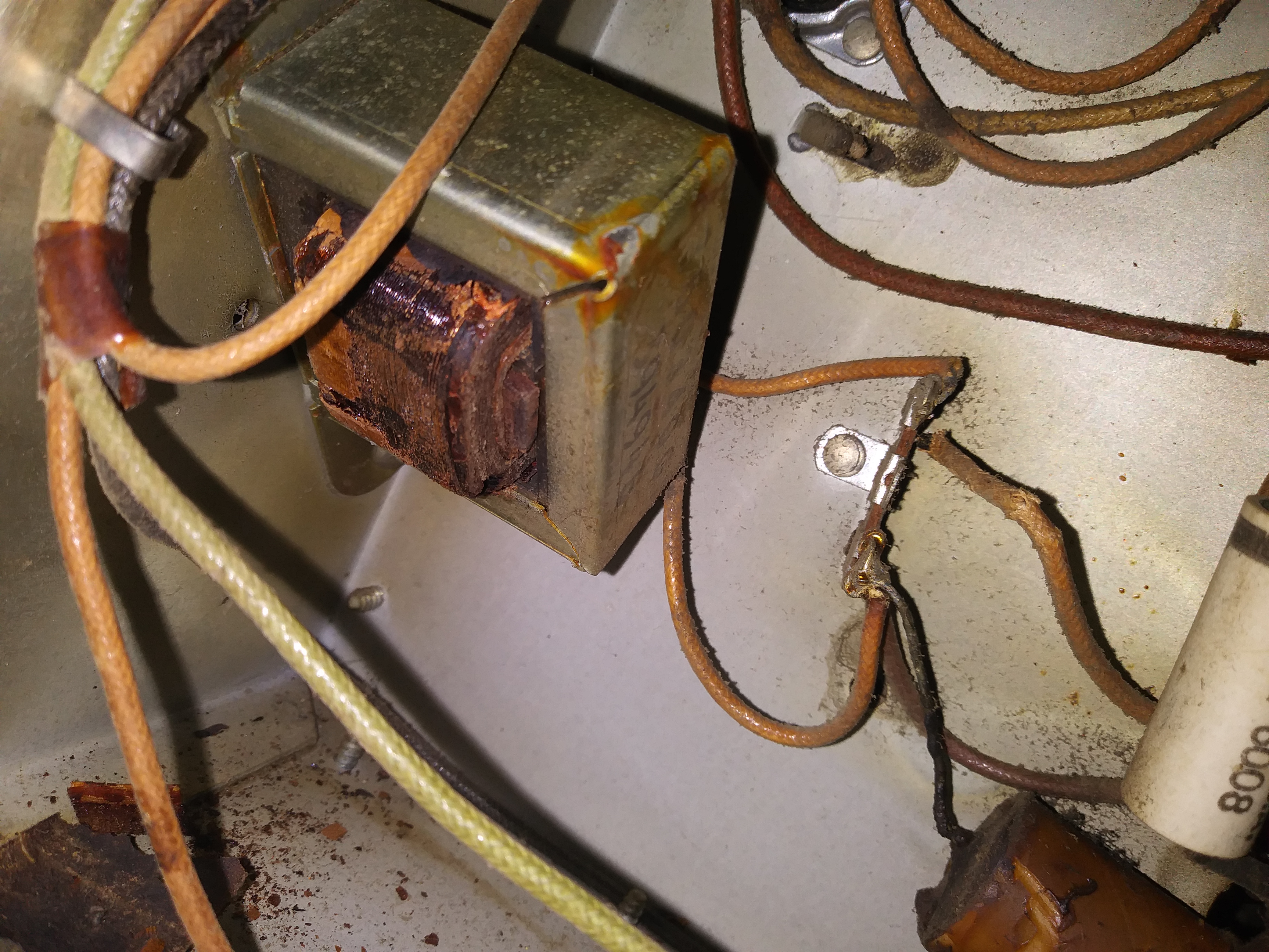

Looks like it's been worked on before, those orange drops are not original, the multi section capacitors are shot, looks like they got hot, one is bulged.
The filter choke looks awful, (L112), looks baked, dark enamel , exposed copper, seen on the lower left corner of the main section, it does not test open or short, but it looks toasted, as if C201A had shorted and overloaded it.
And since there is no type info for replacement that I can find yet, but this horizontal output section seems to be very close to the RCA 630TS, having the same pi filter feeding the damper, I tracked down the replacement shown in the SAMS for a RCA 630TS, (stancor c-2326) for $13, my guess that it's correct enough to work.
With that, does anyone know if there is any other service info on this set, other than the SAMS I found with just the schematic? Cause w/o a guide to what is what and where, it's gonna be a royal pain!
Don't forget the horizontal output transformer has two filament windings. 10 and 12" CRT varieties only used one. It's possible you could move the HV filament loops from your old flyback to a replacement, but there could be other subtle differences in the other windings. I wouldn't assume yours is bad until you get it operational. Have you figured out what this TV's model number is?
I have that in mind, I'm not sure if the flyback in this set is good or bad yet, I'm hoping it's OK, I just know that so far that the filter choke looks like hell, will post a pic of it later.
If by chance the FBT is bad, i still have the RAM replacement that I have for my FADA, 895, that should work, i would just have to add a 2nd winding.
the chassis is a ct-245.

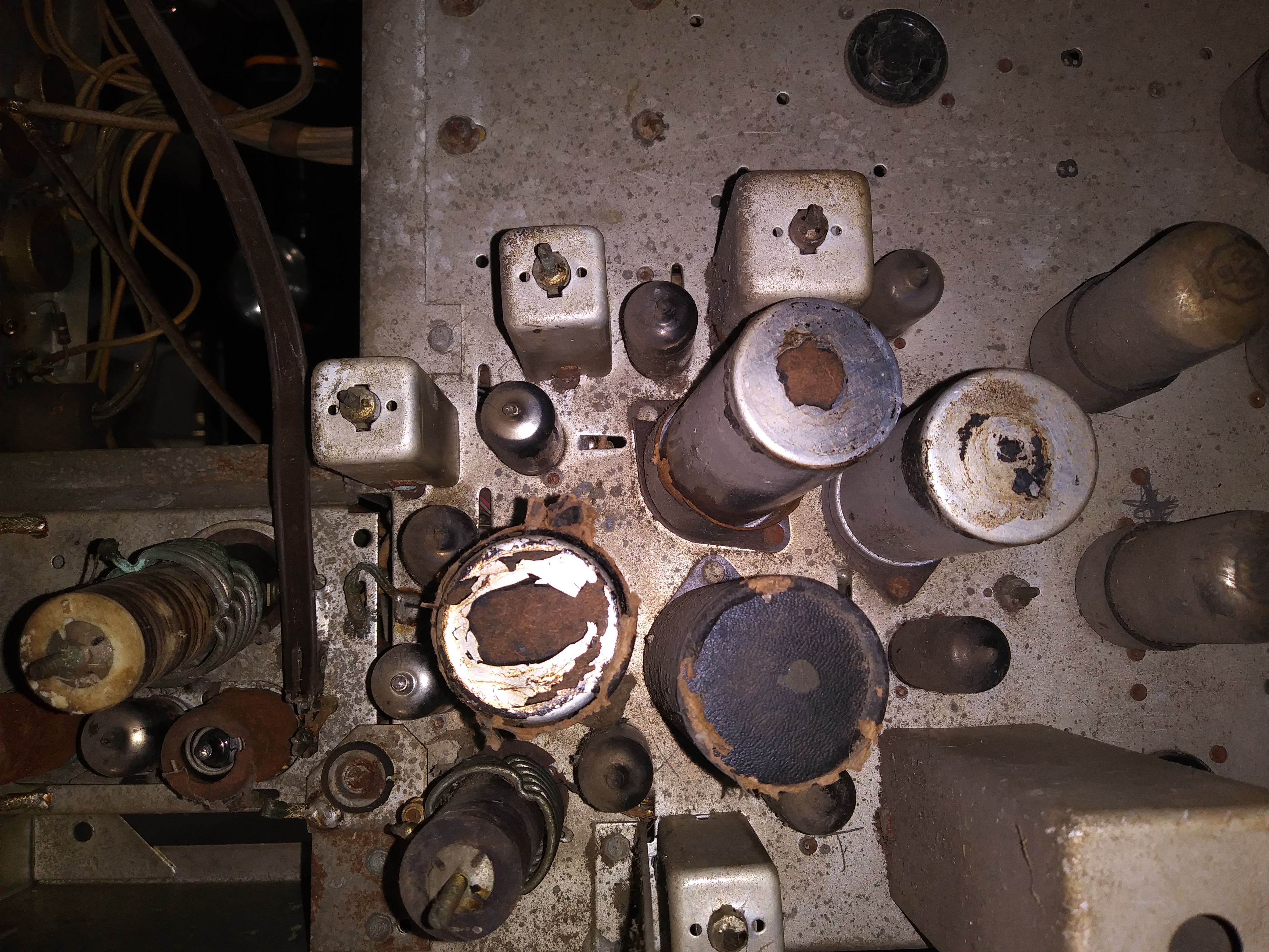

They seem to be missing a parts detail of the audio amp area.
Something has been chewing on the caps in that area
http://suzaku.live-evil.org/0224251601a.jpg
sad looking filter

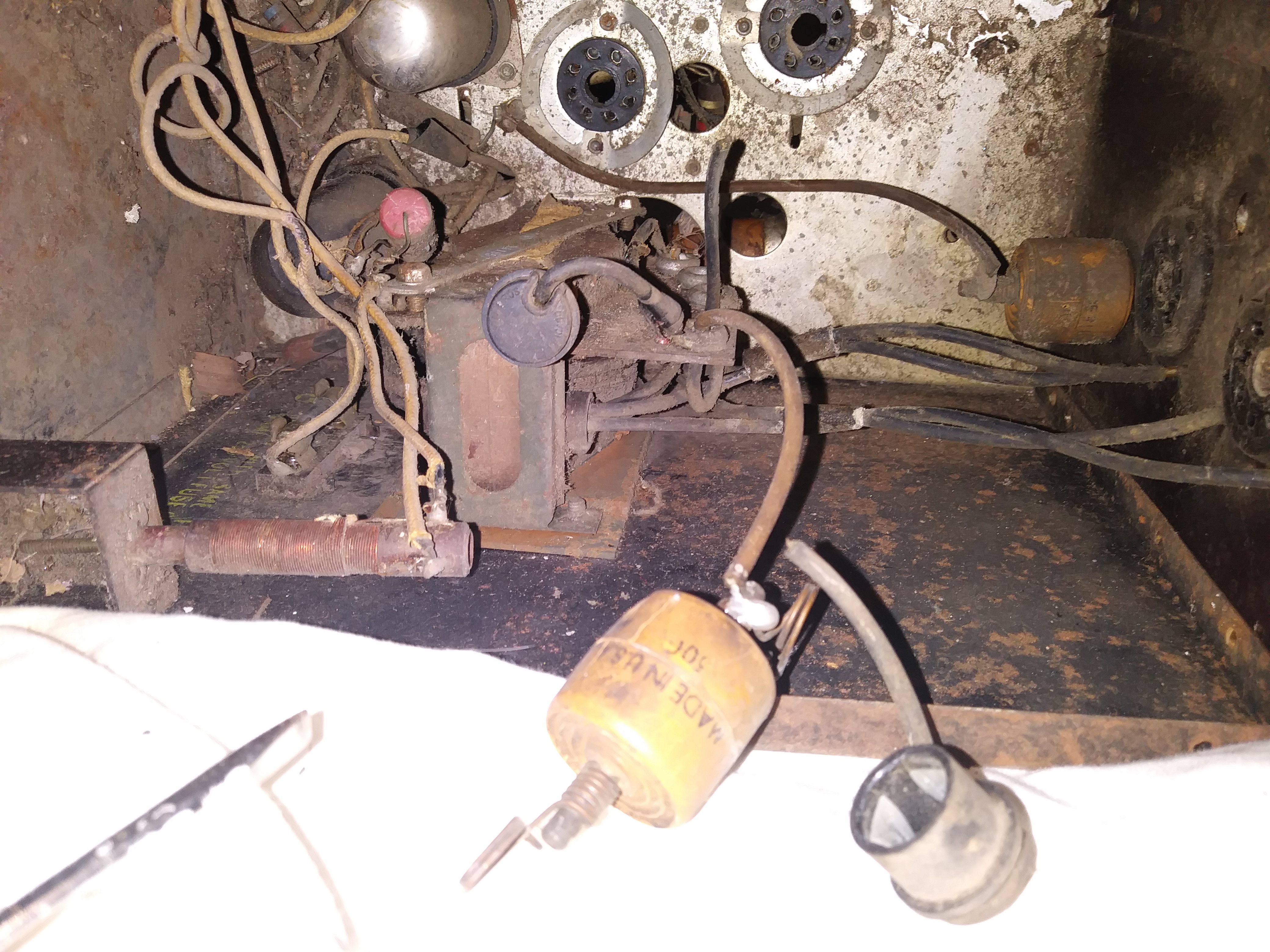

http://suzaku.live-evil.org/0224251603c.jpg
FBT
Wire broke off when i removed the cap from the tube

Any opinions on that crappy looking filter coil?
If it works brush some polyurethane on for additional insulation and wrap paper around it for appearance.
