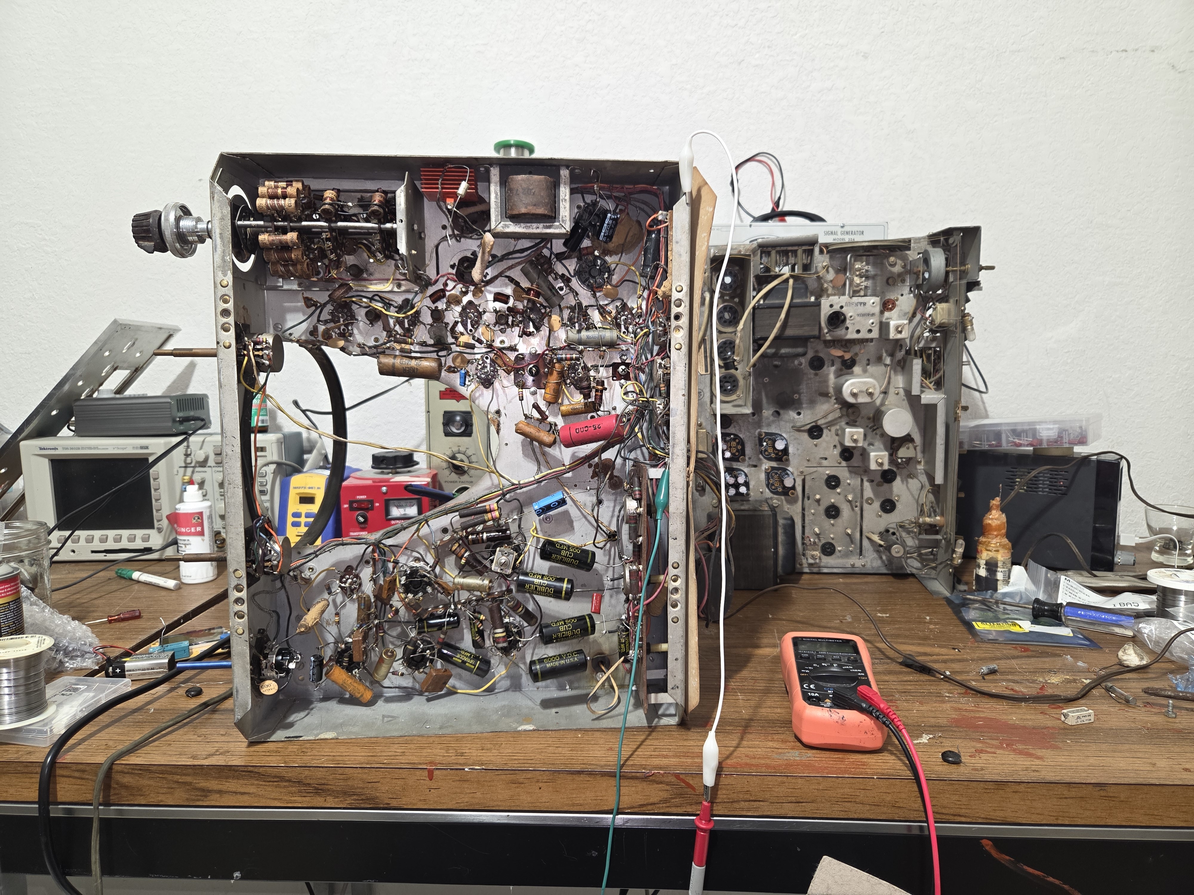

Old 04-03-2026, 11:25 PM
Posts: 3,212
A pic of the chassis. not done anything to it yet.
http://suzaku.live-evil.org/20260403_230850.jpg
You can see, someone has been at it before...
Old 04-04-2026, 12:55 PM
Posts: 3,718
Looks similar to the vt71 series Motorola
