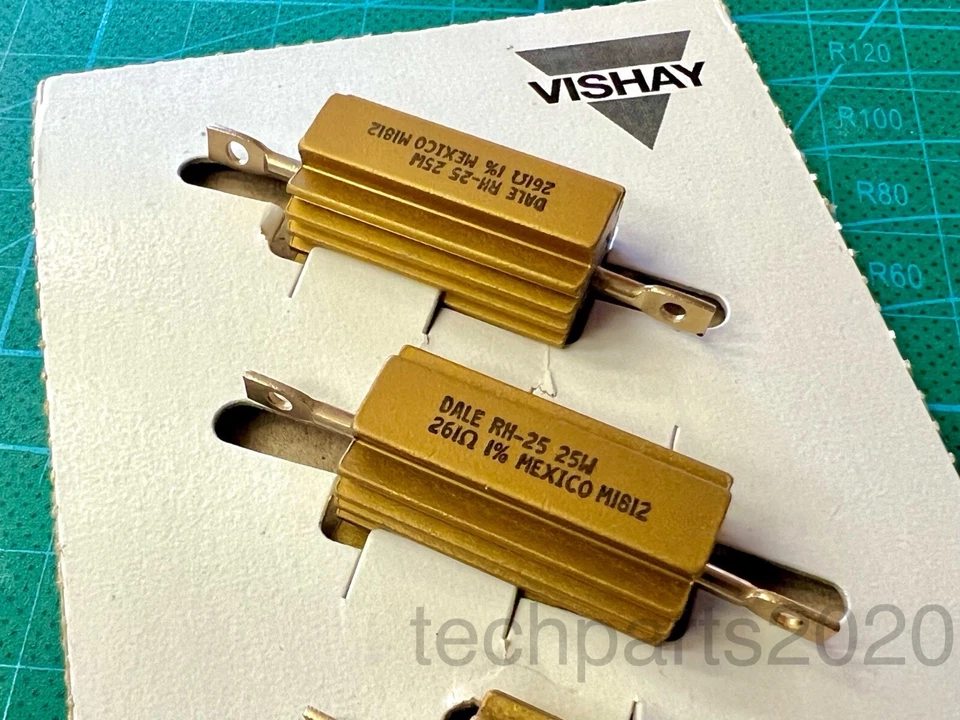

Was trying to adjust the Width and lin a bit more today and suddenly lost brightness and vertical height, it would sometimes come back, but quickly fade, HV was fine, but something was clearly wrong, did not take long to find that one of the resistors that I had left alone ( candohm ) had failed, R215, (260 ohms 11w), so, ordered now is a RH025261R0FE02 261 ohm 25w, the closest I can find. will be here thurs, since I missed the window for them to ship it today.

Yop, Mouser just shipped it about an hour ago.
Tiny little thing for a 25w resistor, looks like this.
https://i.ebayimg.com/images/g/pWYAA...lE/s-l960.webp
Much smaller than the failed 11w one that I opened to look inside.

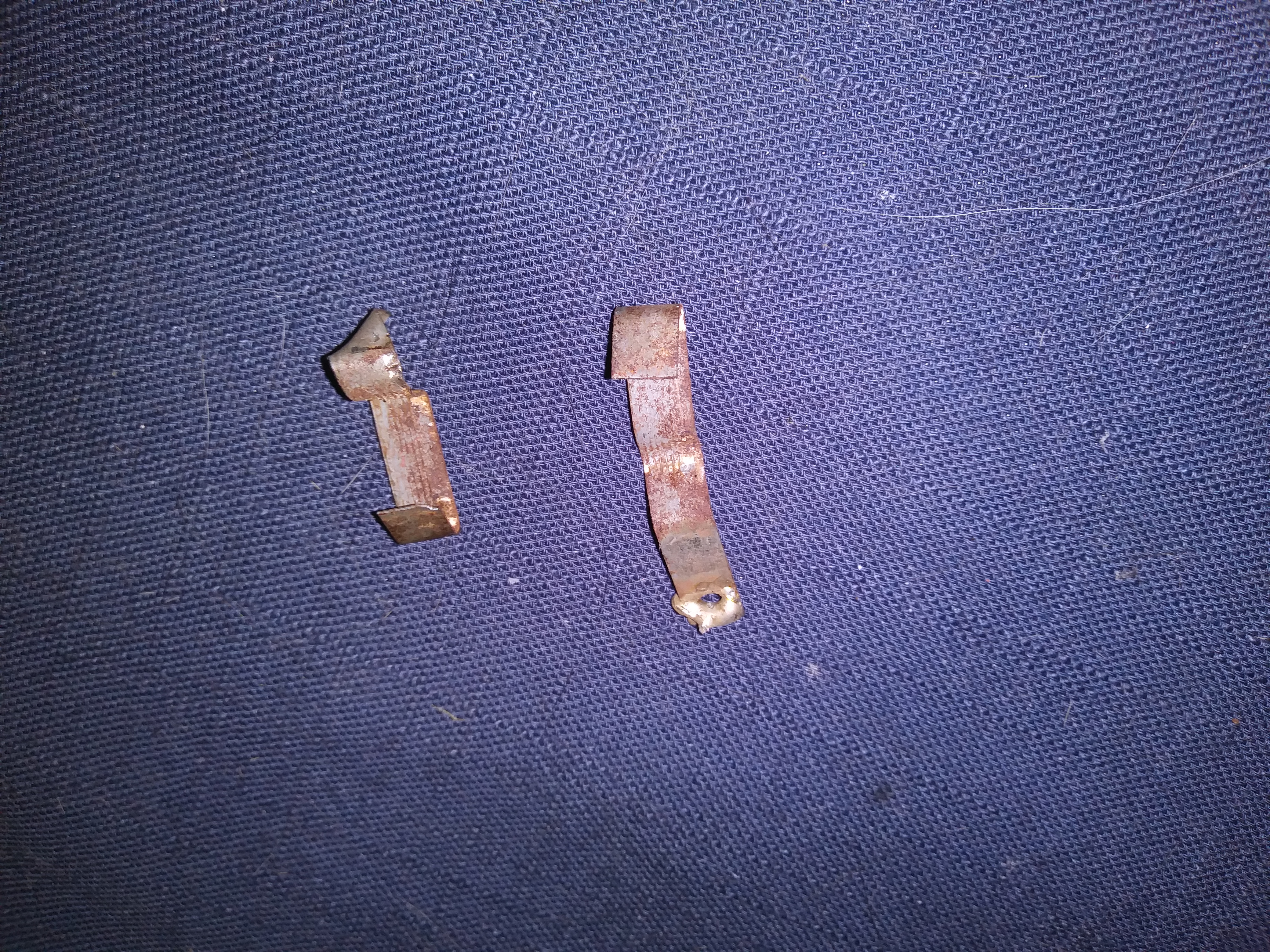

It had not burned open or anything, but failed due to corrosion where the metal clamps to the nichrome resistor wire inside, I must have disturbed it too much bumping the HV case where it's mounted,when trying to adjust the horizontal linearity that is right near it.

Resistor came yesterday, and all is working again!
back to where I was before, trying to get the linearity as good as i can, for now.
http://suzaku.live-evil.org/0801250534.jpg
fail point on the old candohm.
