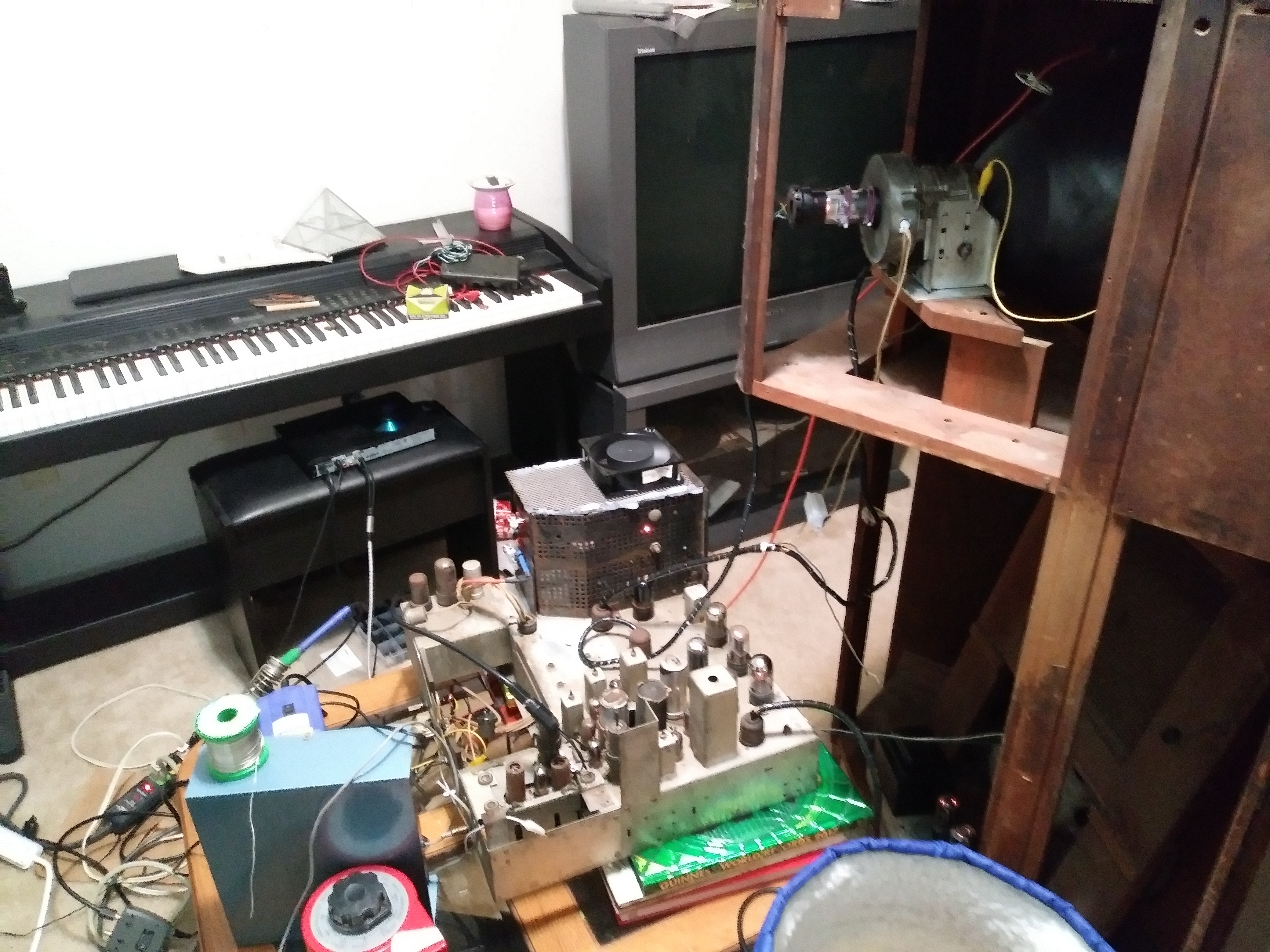

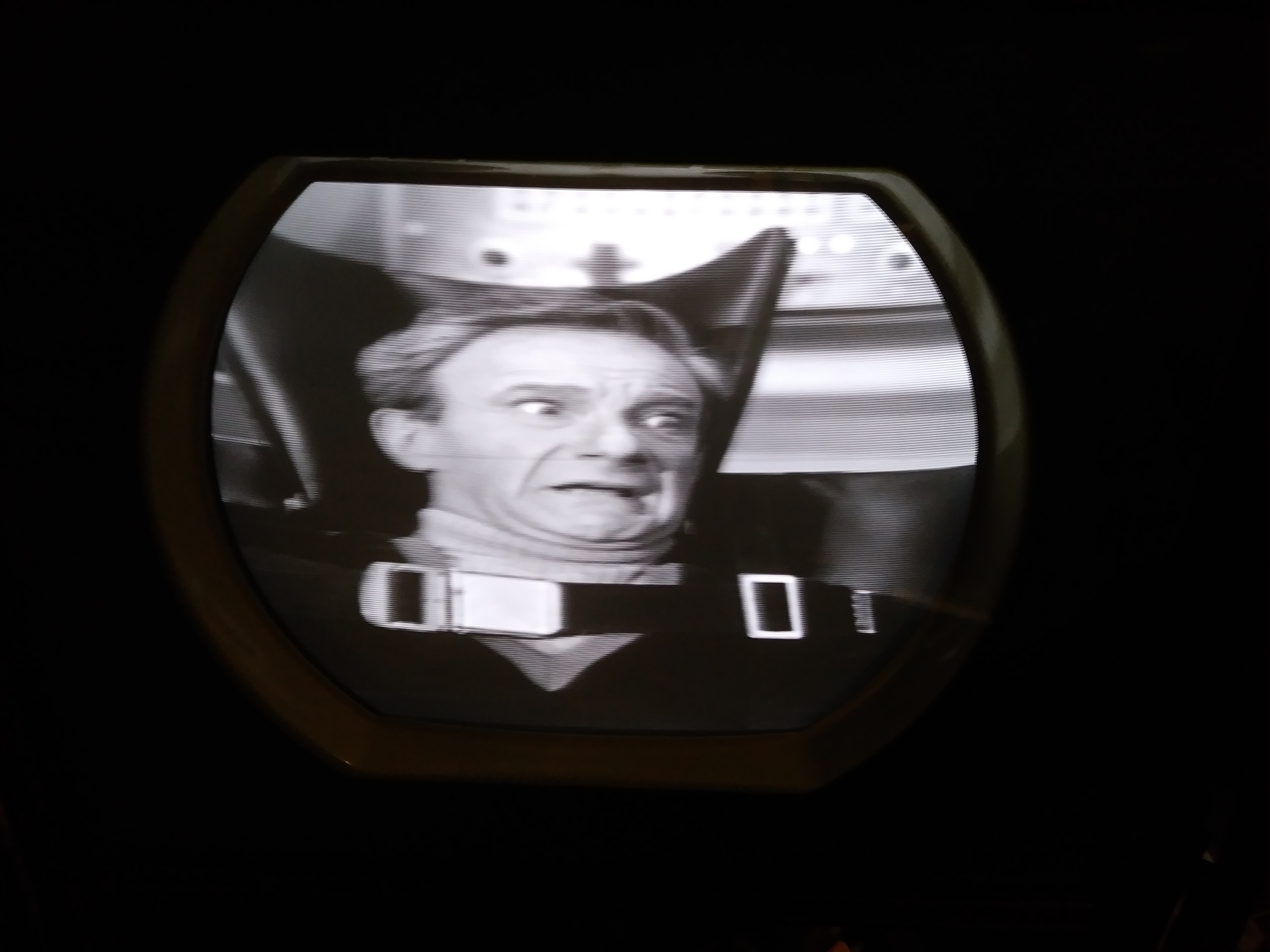

OK, now that it looks like the site is working again.
After much time and testing, I'm pretty much at the point to where I'm ready to put the chassis back into the cabinet, still no wax loss from the FBT, come up stable every time, horizontal linearity still not perfect, but a LOT better then it was before.
Not sure what else I can do to it.

Chassis ready to be put back in, as mentioned, not quite perfect, but much better than it was.
http://suzaku.live-evil.org/0922251958b.jpg
http://suzaku.live-evil.org/0922252001a.jpg

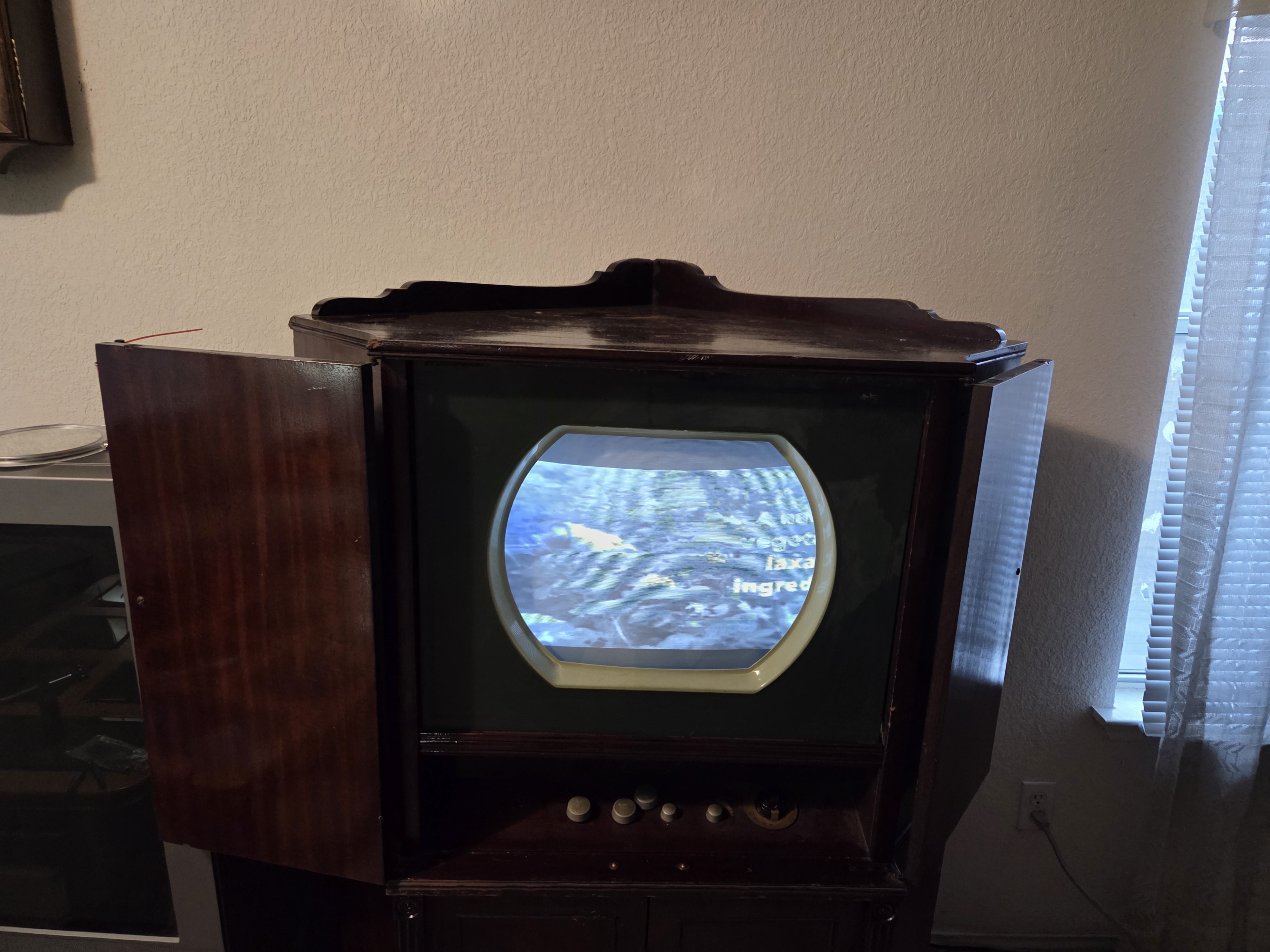

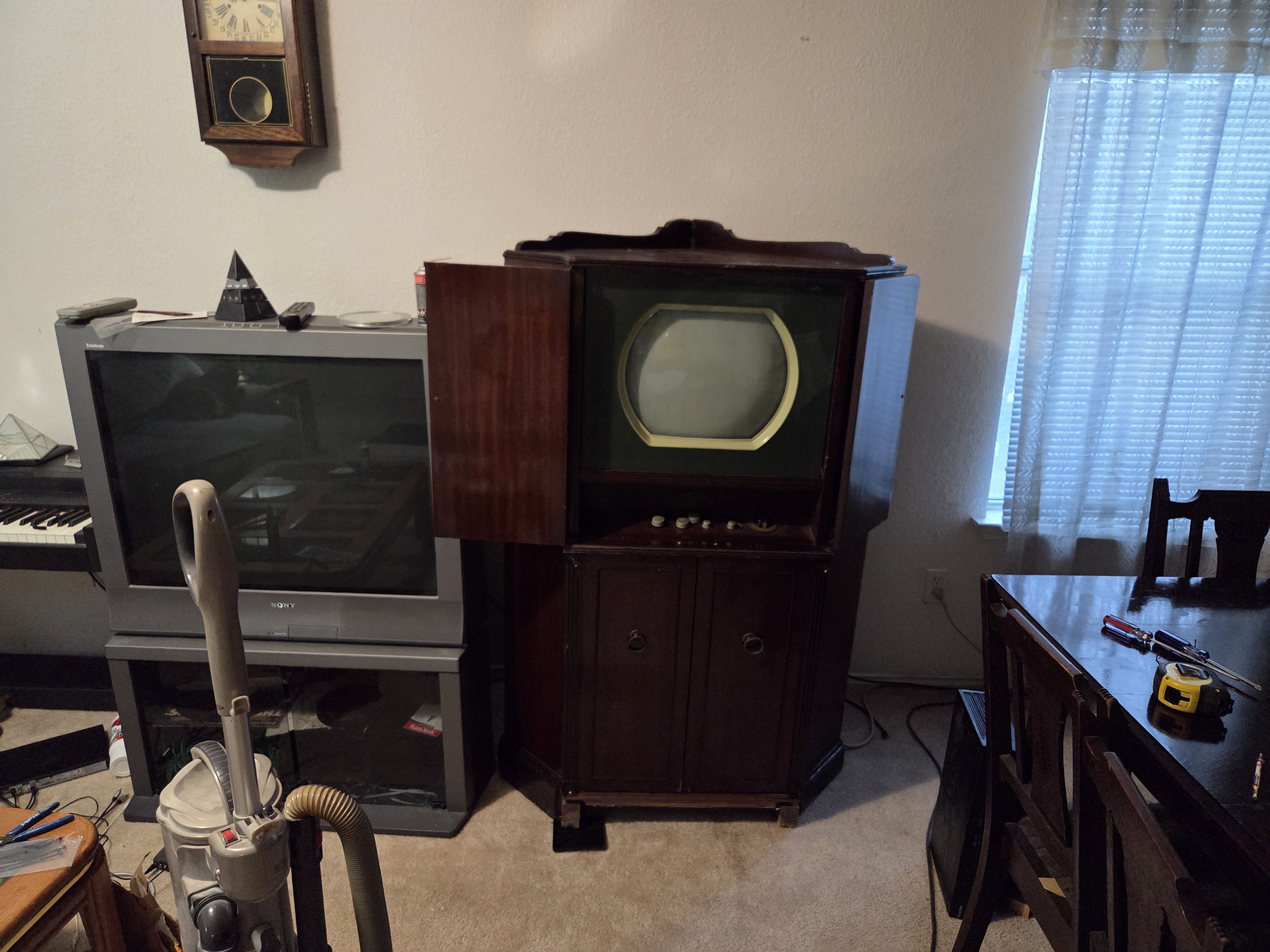

Chassis is now back in the cabinet.
http://suzaku.live-evil.org/1014252118.mp4
I have done all I can till i get the right FBT.

http://suzaku.live-evil.org/20251108_165833.jpg
http://suzaku.live-evil.org/20251108_165718.jpg

Probably should have changed some more of the resistors in the vertical oscillator area even though they tested OK 15% of what they were rated, as it's hard to get lock when first turned on,cold, but after warm 10 min it's VERY stable and fine for hours.
