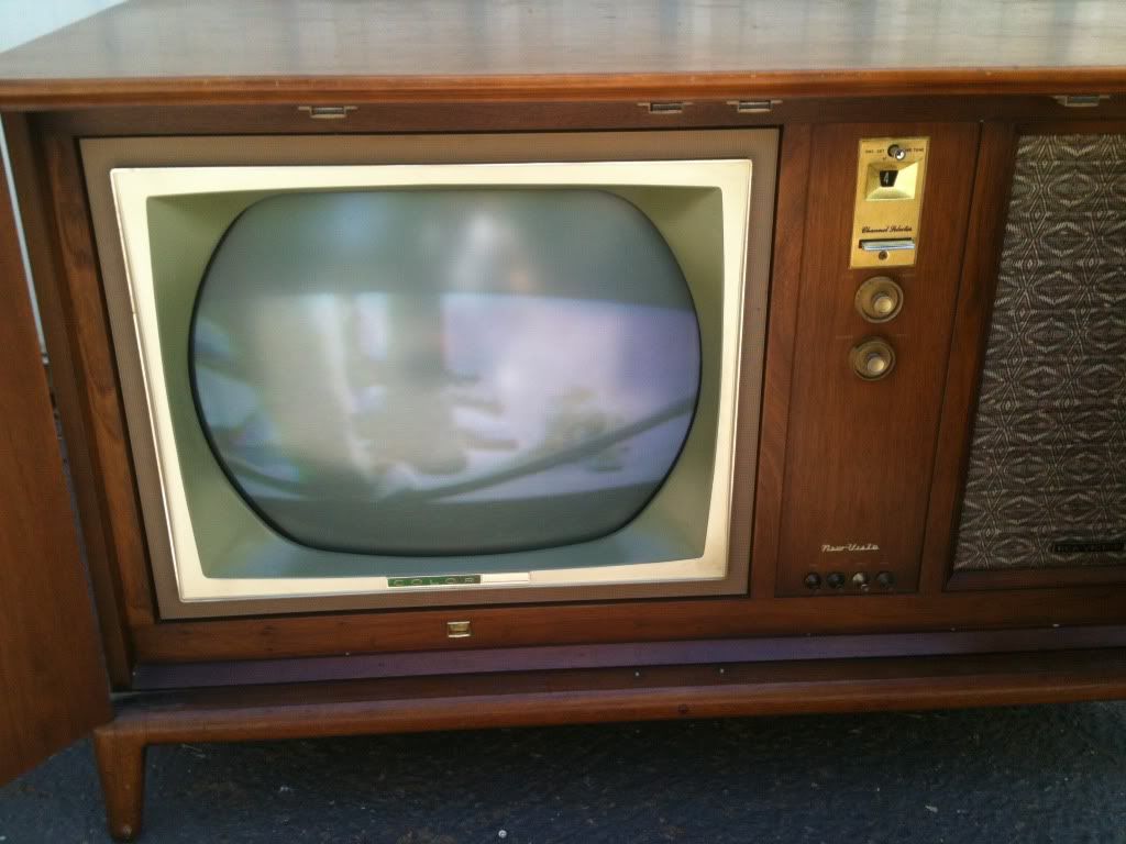

Right. No way a safety glass was on this set. It was built
Without. Oddly enough I cannot seem to find this puppy on the CTC-10 catalog. Possible rarity here? Oh and what was the original CRT? The tune diagram in the cabinet someone markered over the tube type. Not a cyp nause of the bonded safety glass.

Here is a pic of how the CRT looks and this is really cool too!
http://i845.photobucket.com/albums/a...u6/photo03.jpg
http://i845.photobucket.com/albums/a...u6/photo04.jpg

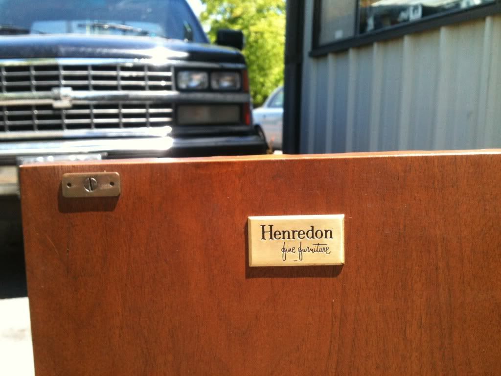

Henredon fine furniture. That company is still around too!
  #37
Old 06-29-2012, 05:05 PM
Yeah, Henredon's Top-Flight stuff. That was a BUX-UP set when new...Did you go over it w/Pledge or something, or is it just THAT Purdy ?!? (grin)

Old 06-29-2012, 05:15 PM
Did you get the brightener to come off? If so, it looks like there's life in that CRT.

Posts: 1,778
Nope it was just meticulously taken care of by the original owner.
The CRT brightness still on it. I figure let er cook at 8 or 9v for a few more hours then I'll get it off and check the CRT.
  #40
Old 06-29-2012, 05:21 PM
The heat may help loosen it too, you said it was stuck on there pretty good. Good luck with it, I hope nothing breaks.

Posts: 1,778
Well red green and blue all well into the bad range.
  #42
Old 06-29-2012, 07:03 PM
Give 'er a whack with a tester, what tester do you have? I've had amazing results with a Sencore CR-70.

Semcore cr-161.
And. Yep I did. I let the CRT cook overnight so I figured what to I got to lose.
And the results were.
Red. 1/4 in the good
Green just barely good
Blue half in the ?
So I plugged it back in did a quick convergence and purity alignment with moderately impressive results. Then....
It started to look hazy and dim in the blue. Then a little darker.
So I tested the guns again and all but red were in the bad again.
Red was in the ?
So I started running it with the juice bumper again and it looks a whole lot better. Sadly I think this CRT has seen brighter days.

Sounds like the tube is gassy, the cathodes are becoming contaminated. Time for a replacement.
