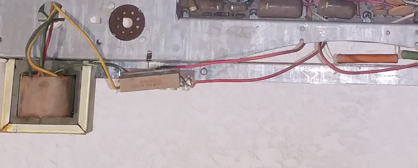

Interesting. They are only in the VHF tuner.
Gave the chassis a good look over and found no more problems. Crazy how pristine it is. Really want to minimize replacing parts.
Here it is after a bit of cleaning. Axial electrolytic and two white ElMenco caps have been replaced. Also replaced the thermistor.
Will resume trying to reform the original caps with a slow power up.

The right hand side of R204 needs attention it looks like, where the red wire is hooked, Terminal block looks dark, as does the resistor lead, i replaced the entire thing on mine, new Terminal block with a 20w resistor
no where near as bad a mine was! :P
http://suzaku.live-evil.org/burned.jpg
Looks OK to me and measures dead on.
So did mine, but it's a high stress point, due to the heat and oxidation, it will fail sooner or later, not quite as bad as the bleeder nets in the old RCA BW types, but you may want to deal with it now while you have the chassis out, then having to do it again a year or so later, cause due to the heat involved, it will go at some time in the future.
And a new terminal block which I'm sure you have on hand, + this, https://www.mouser.com/ProductDetail...52Bhysvw%3D%3D is worth the investment to having to put it apart later if you can avoid it,
Consider it preventive maintenance, all color sets seem to have a 18+ watt resistor in them in the voltage divider, winch always seems to roast the resistor and the tie points, I always make it a point to replace these with slightly higher wattage ones and new terminal blocks when I re-cap, even if they check OK, cause I don't want to be bitten by it later.

Going over my old pics, before I replaced the old one, it blew out my IR camera at over 400F, which is what prompted me to put in the 20w, which ran quite cooler.

Why would I replace the terminal strip? It's pristine.
I could not see it very clearly.
mine was toasted!

I see (feel) what you mean now that I've gotten it up to full power!
Spent a couple hours reforming them caps without incident. Then popped the remaining tubes in and went for it.
Yes! We have raster. You can really tell when the HV kicks in!
Now I can also see just how bad that cataract is. No way you could watch the set like this.
