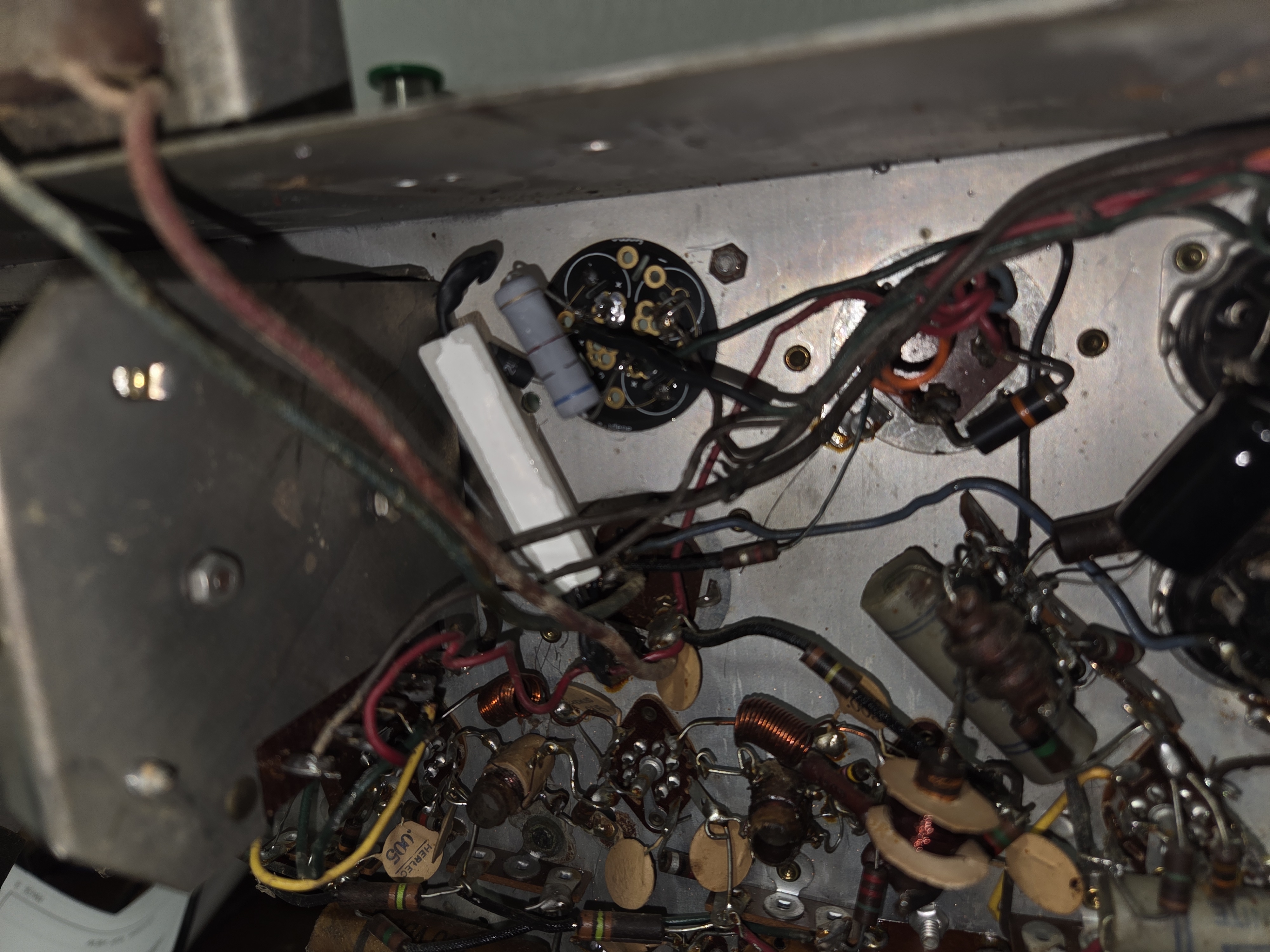

Question is, what to replace that ugly 18 ohm sandbar resistor with once I replace that selenium rectifier with modern diode, random guess is 180 ohms, but what does people who have done these sets think?

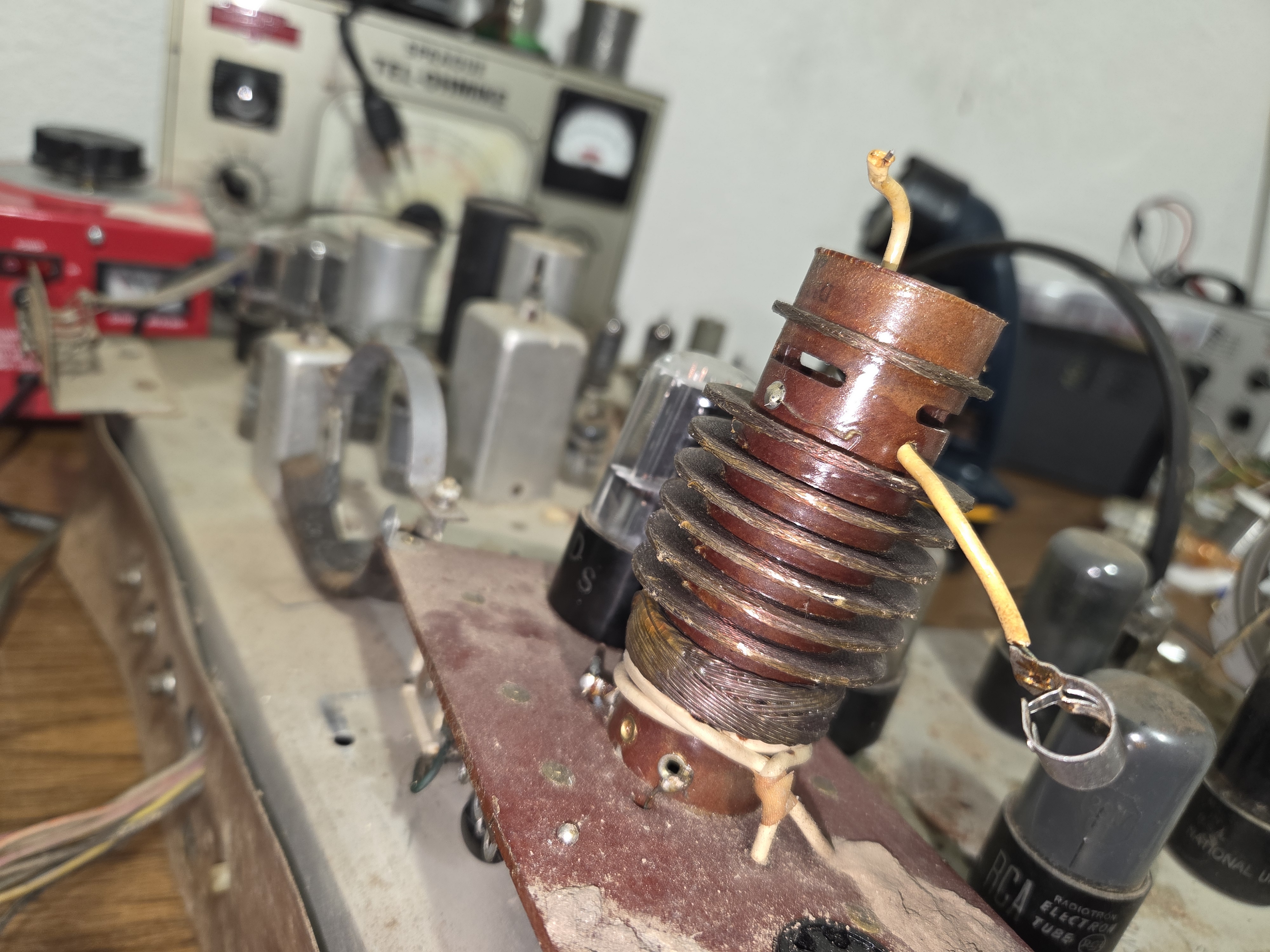

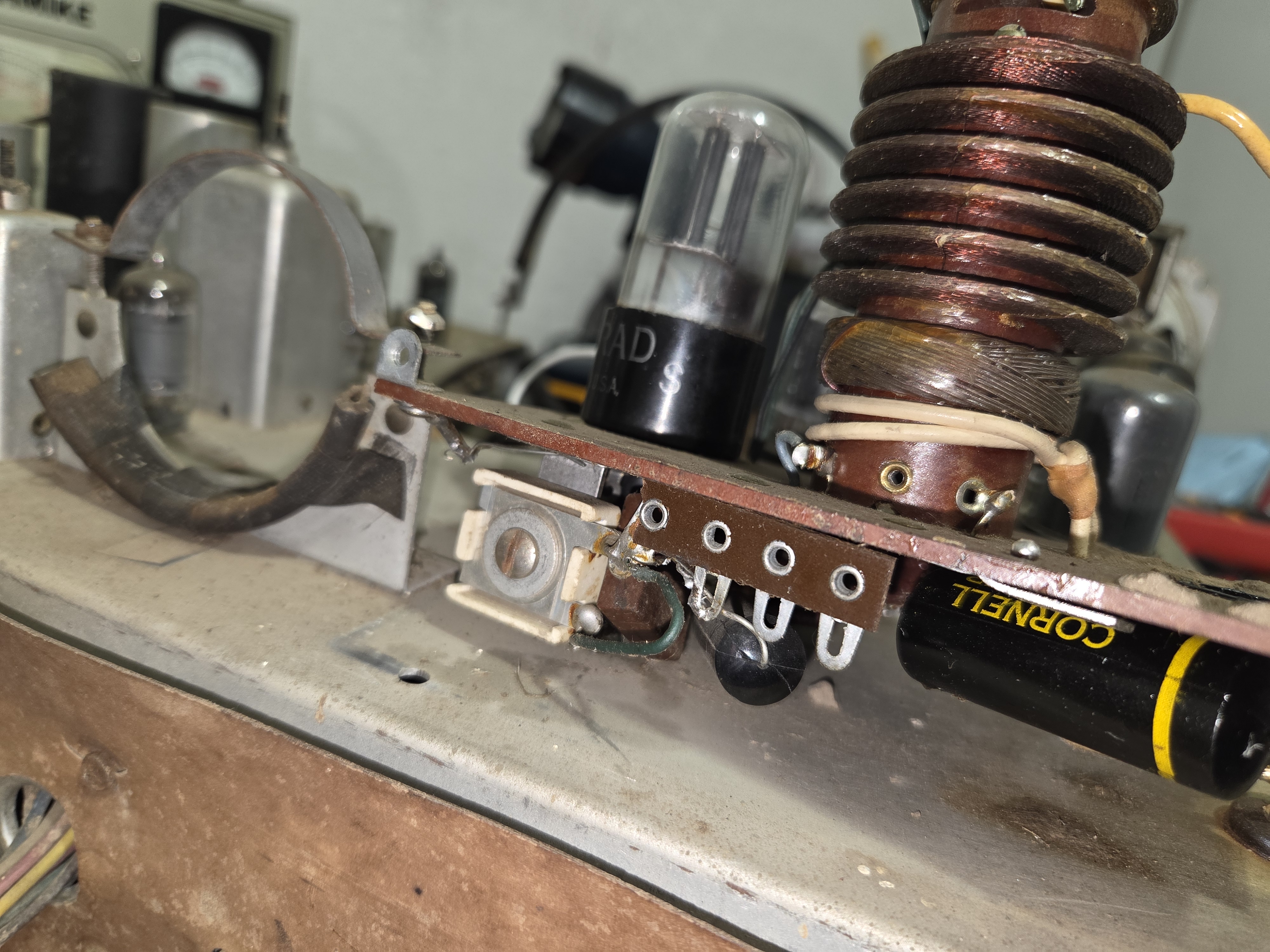

Posts: 3,210
the HV transformer look OK
http://suzaku.live-evil.org/20260406_202205.jpg
Except for the wire to the Rect tube broke.
It's very brittle
http://suzaku.live-evil.org/20260406_202224.jpg
that cap down there is shot.

Old 04-07-2026, 10:36 AM
Posts: 3,716
Those black caps were probably the best back in the day

resistance check of where that wire SHOULD go, to ground, checks OK, meaning the main HV coil is good.
For lack of any better idea, I will try a 180 ohm resistor in place of the 18, when I replace the selenium rect with a modern diode.
  #37
Old 04-07-2026, 11:40 AM
Posts: 8,823
No, that's much, much too large. I'd leave the 18. It's there for surge protection.

Most places say to add 100 ohms when you remove a selenium and replace it, anyway, I'm out of large adapt-A-caps T_T, I used 4 in my sansui, need more now.
Oddly enough, the 18 ohm sandbar was OK, still gonna replace it with a 20, and the 680 ohm was bad, REALLY bad, 1.2k ohms bad.

Old 04-08-2026, 10:45 AM
Posts: 3,210
SAMS says 5w for the 18, and 1w for the 680, though they look to be bigger due to they are old dogbone sand types.

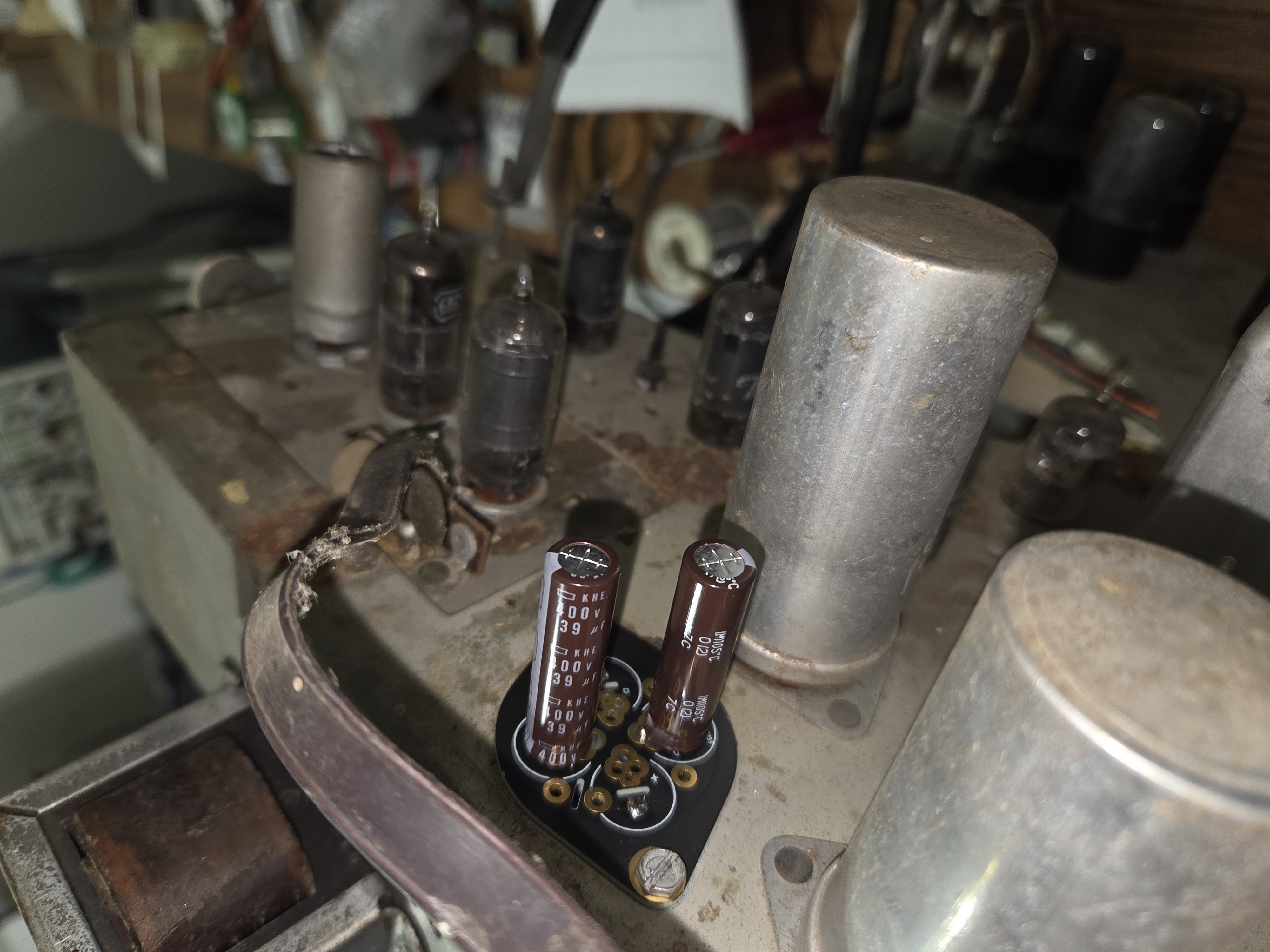

Posts: 3,210
first cap done.
http://suzaku.live-evil.org/20260408_194417.jpg
http://suzaku.live-evil.org/20260408_194444.jpg
Waiting for more adapt-A-Caps
