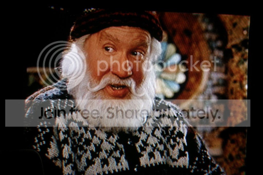

Santa Sweater Mystery
Suspecting a camera problem, I re-did the display of the Santas on both 21CT55 and 27in Sony.
Judy and I agreed both TVs produced identical coloration of the two Santa's sweaters. I screen-shot both TVs and downloaded the camera.
I was astonished to observe the "fuller Santa" was black/white on both TVs while the "lesser Santa" was black/white on the Sony but blue/white and his hair was bluish on the 21CT55! Why this should be is not understood by me.

Skinny Santa has some blue highlights in his hair, too. He looks a little punk rock! I think it may be your camera's white balance, though.

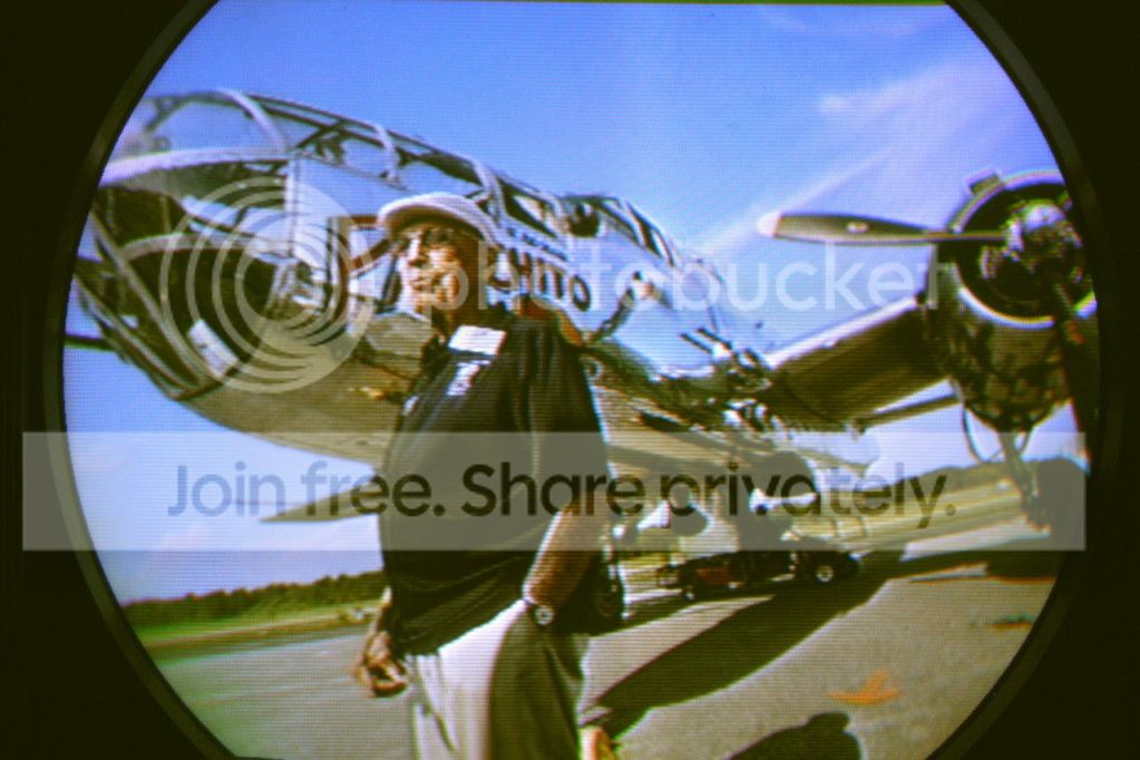

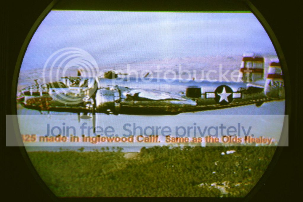

Still no resolution of the “Santa Blue Sweater” issue. Since this thread is a documentation of 21CT55 video monitor screen shot picture quality, I am including my Flicker photo site’s new Photo Stream format I recently discovered. Again, the stitched photos show the 21CT55 shots on top with the Sony comb filtered shots below. Flicker Photo Screen presentation size is much bigger then the early grouping previously presented. Relative picture detail of the RCA vs Sony is readily discernible.

Several of the stitched shots (but not all) are bluer on the top.
Do I understand correctly that all these appeared to match to the eye?
Is your camera white balance set to a fixed setting (daylight), or is it set to automatic? You cannot get consistent results on automatic white balance, as the camera is trying to guess the lighting conditions, and slight variations in the content can cause it to move one way or another.

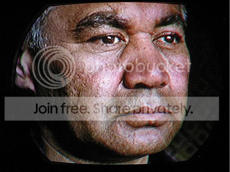

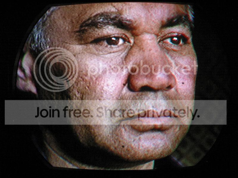

Testing New Screen Shot Process

Wow, looks like a terrible level of block/line artifacts on my screen. Maybe this is from converting the original to a smaller resolution?

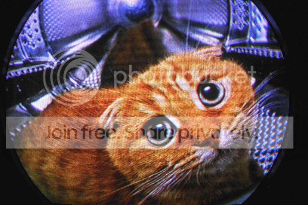

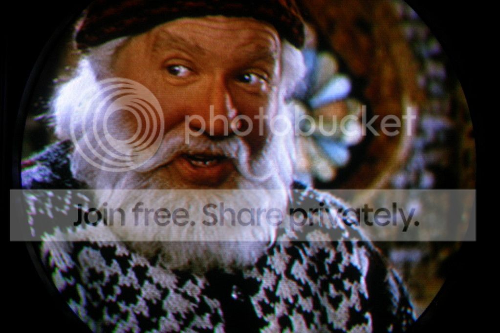

Wayne....Does the guy look better in this screen shot? The Photo Bucket seems to over-drive on high detail photos. The new guy has less intense detail.
The cat is in a silver steel drum but displays in deep blue. So I'm going to work on the cat screen shot and find out the problem. Surely this anomaly would have been obvious to the human eye viewing the 21CT55 crt......Tom
  #57
Old 12-03-2014, 05:20 PM
Posts: 7,763
It's better, but not completely clean. Not a good endorsement for Photobucket!
