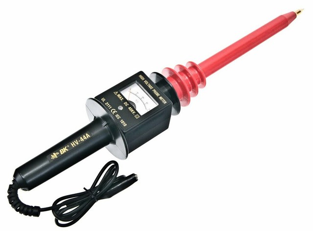

Posts: 1,778
On my BK HV probe, it was off by a mile. Tested it on the Sony KV-2643R. thou HV should be 29kv, it read 20kv. Luckily the probe has an adjustment potentiometer so I set it to what I believe that Sony should be running at 29KV. I tested a few other sets around the house and high voltage on my CTC39 was it 24KV.
On the CTC16, we were at 21kv. I bumped it up to 24kv.
If this high voltage has been running low for quite some time I wonder if this can put undue stress on the fly back. I'm sure I'm answering my own question but I noticed the other night when I ran the set for about 30 minutes the fly back cage felt warm. After I adjusted the high voltage up to 24KV I noticed after a 30 minute run the high voltage cage stayed cool..
My question is, has anyone else had to re qualify a high voltage probe like this with a known good high voltage set So you could use your meter to check other TV's? Is it's a good way to re qualify a high voltage probe?
  #51
Old 09-26-2019, 11:47 PM
freakaftr8's Avatar
Convergence freak!
Posts: 1,778
Inside the probe there is a very long 600 meg Barber Pole yellow and black resistor that was only reading 530 meg. But sure after time and age these things have a tendency to drift.

Posts: 3,189
which probe you got?

It's a BK precision HV-44
  #54
Old 09-27-2019, 10:10 AM
Posts: 3,189
I also have the HV44A, I know about the adjustment to zero the meter, I did not know there was any other, or that it could be opened up to see a big resistor.

Yes if you're looking down at the meter needle it'll be on the handle right side. It's a very small hole that you can insert a flat head into to adjust the calibration.
It didn't take much to move the needle so I'm concerned that excessive jolting around of the probe or possibly a drop could cause the calibration to go out of whack

Posts: 3,189
that explains it...
the BK HV44A and the HV44 are not the same.
Mine is newer, all sealed, no adjustments factory calibrated.
