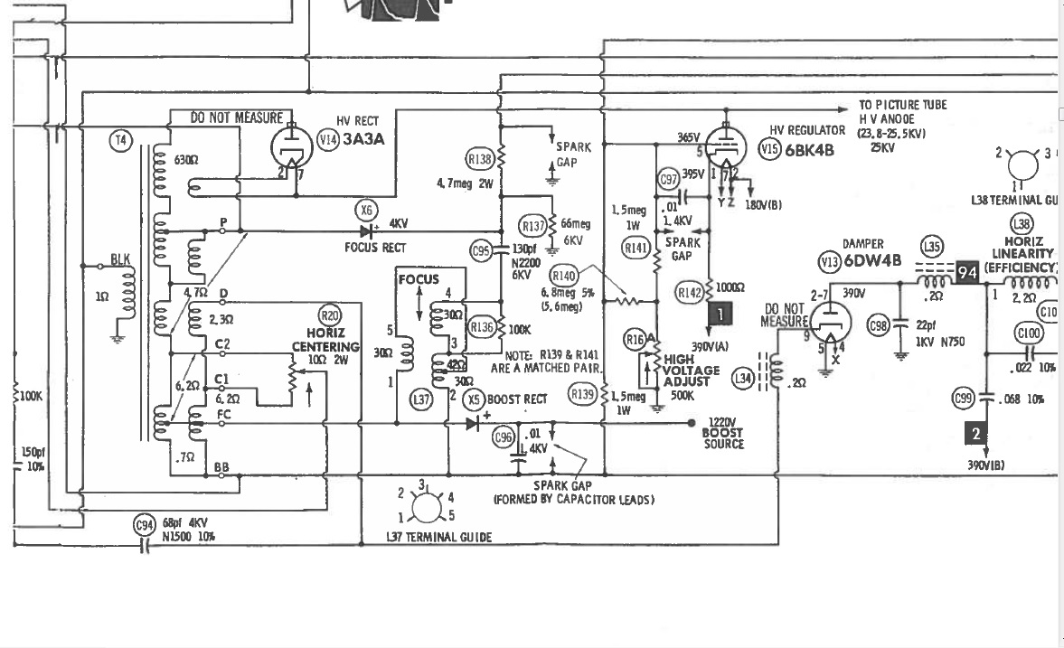

http://suzaku.live-evil.org/0717222342.jpg there were some cracks in the outer " doughnut " that was allowing arcing. but unlike the ones in the roundies, this one seemed ti be made of tar or something and not rubber. there was no carbon tracks that I saw, just cracks and so on. as far as replacing the heater winding, i really don't have the type of wire to do it right now, or really know what to even get to use.

Thinking conservatively, it would be rather foolhardy now NOT TO replace the burned wire now while I have the FBT out of the chassis with it easy to get access to.
Not really knowing what type of wire to get, I made an educated guess. Copper Core Flexible Silicone Wire Cable Red 10M 32.8Ft (22AWG 40KV) 40KV, well above what this set should generate, 22AWG, should be thin enough for the clearly 2 turns that I see around the core of the FBT, and hearty enough to power the 3A3A/C

http://suzaku.live-evil.org/0716221404.jpg You can clearly see 2 turns on the heater winding on the core, should not be too hard to replace with the new wire ordered. You can also see the crack (cracks) in the FBT outer layer which looks to be made out of some kind of hi temp tar, which was easy to melt with an soldering iron, there was a tendency for corona arcing from these cracks but saw no real carbon, and thought it very risky to try to remove it, so I covered it with several layers of dope.

Amazon SHOULD bring the new HV wire today, with which I hope to re-wind the newly doped FBT and try again with the 3A3C. Did a resistance check on it. http://suzaku.live-evil.org/fbt112.jpg It all mostly agreed with what SAMS says except fot the one 4.7 ohm reading which was about 10, but I have seen this before, where what they had listed did not match real time with what was in the sets and there was nothing wrong. Especially when there are 2 different FBTs listed in the SAMS, Hoffman # 033-013000 & 033-012700 both replaced by merit hvo-234c / stancor ho-601c / triad d-304. And if worst comes to worst and this CRT is no good, ETF does have at least 1 or more that will fit in this thing, :O

OK... this just got a bit stranger. the replacement FBTs listed in SAMS are FOR the RCA CTC-15 . was the same one used in the 17? this is odd its not SAMS that makes the subs, but merit/stancor/triad right?
=^-^= Yasashii yoru ni hitori utau uta. Asu wa kimi to utaou. Yume no tsubasa ni notte. いとおしい人のために |
The CTC-15 was a roundy the CTC-17 was a rectangular...The deflection angles are different between the two so RCA definitely used different flybacks in the 2 chassis, and I have a hard time buying that Hoffman could have made a roundy fly work in a rectangular set.

Then the list in SAMS must be wrong, just as DJ ran into 50 years ago! ![]()

The Sams was wrong!
Redone FBT ready to go back in!
http://suzaku.live-evil.org/0719221857.jpg https://www.youtube.com/watch?v=xos2MnVxe-c http://suzaku.live-evil.org/0719222043a.jpg and there is color! dirty! o http://suzaku.live-evil.org/0719222046.jpg the repair to the broken pin DID work! the video is sloppy, prob some weak tubes, many orig ones still in there, but now I know all I need to to move on to the restoration stage,
