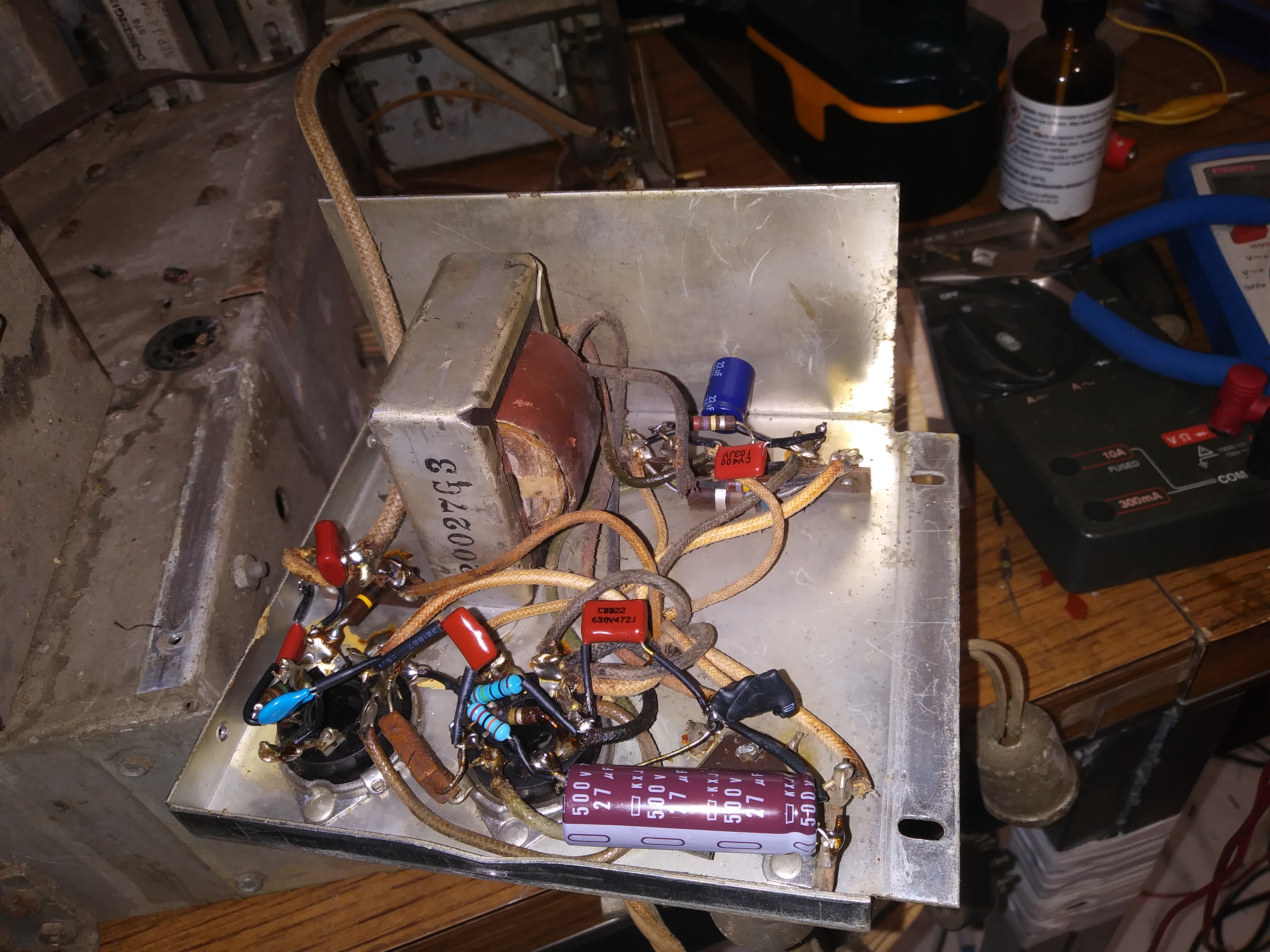

Status update.
Not much to report, did not have much time to work on it this weekend cause of computer problems (RAID-5 headache ).
16L/CP4 paid for, waiting shipment, (thanks ETF! )
Ordered the broken core HVO-5 seen on E-bay at discount, may give me a baseline to test what is in the set, not even sure if it's original. And if bad, perhaps with the 2, a good one could be made, failing that, there is a 3rd option.
Will soon start on the main electrolytic capacitors.
There are several candohm resistors mounted in the HV case not shown in the parts locator pages, this is most likely the bleeder network, will need close attention, as will the CRT anode wire that has broken off at the 1m resistor, which will need a new HV resistor.

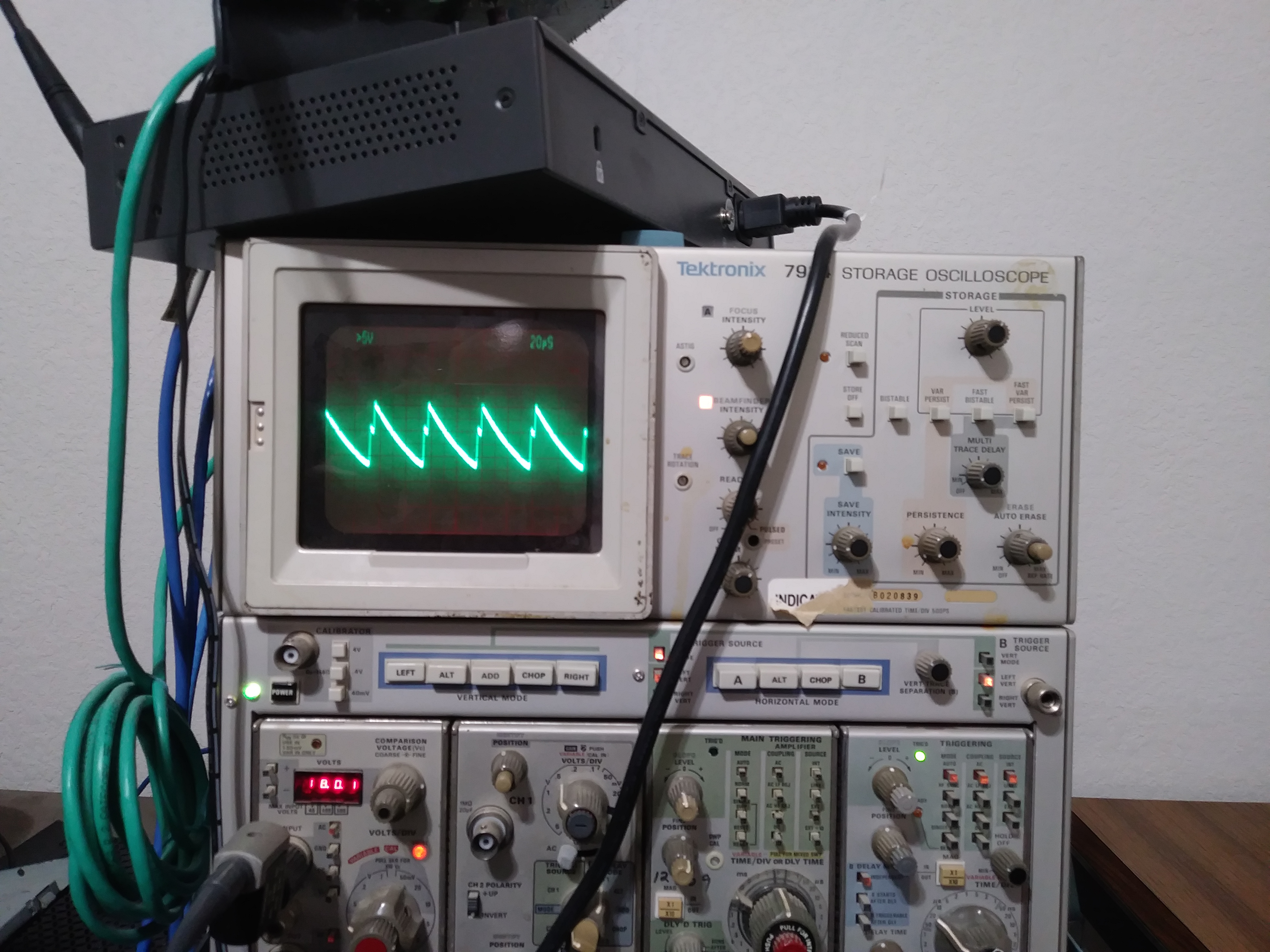

After replacing the main pi filter caps this week, I decided to risk powering it up slowly with 2 new 5U4GBs, and after a while when voltage seemed stable and one paper bomb exploded someplace, not sure where yet I decided to hook the scope up to G1 of the horizontal output tube, well one of the pairs...
https://www.youtube.com/watch?v=NmPhaG1ud38
All the critical bits are working!
I can now move on to making it good as new!

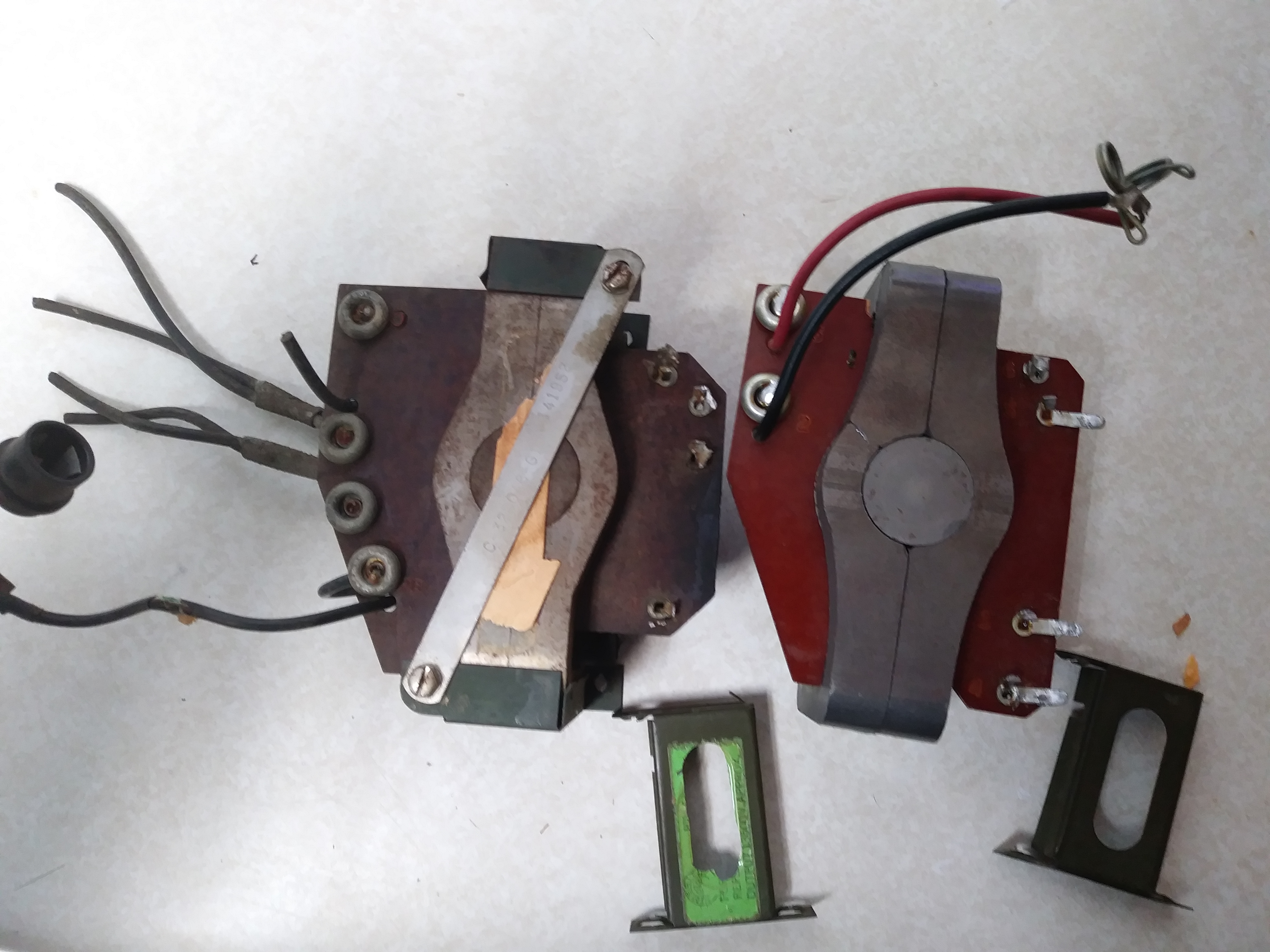

Furthermore the broken core Merit hvo-5 came today, and my guess was right, it's physically identical to the FBT in the chassis now, meaning I can swap the broken bits from it to fix it, most likely Merit made this FBT for maggie in the first place.

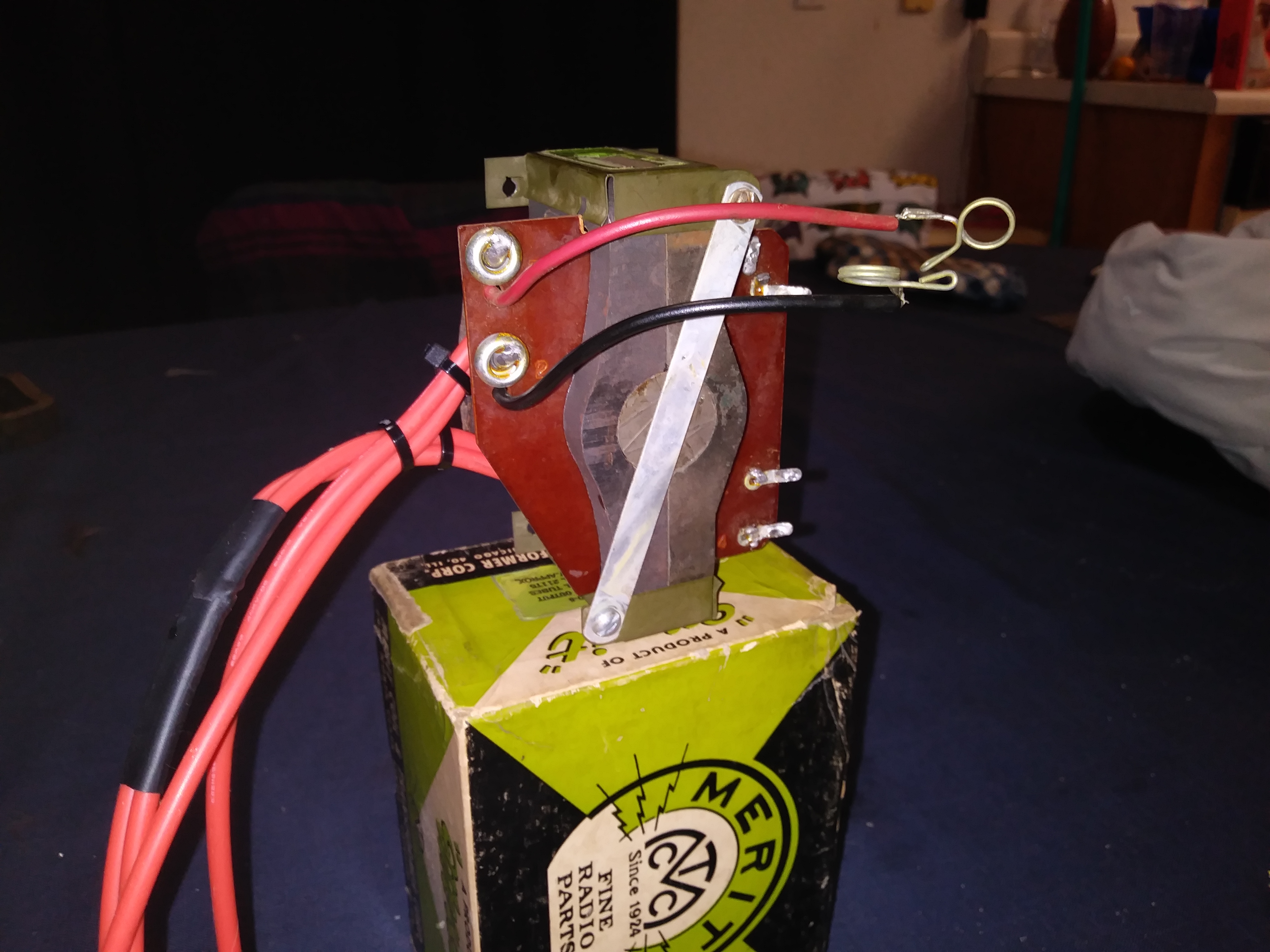

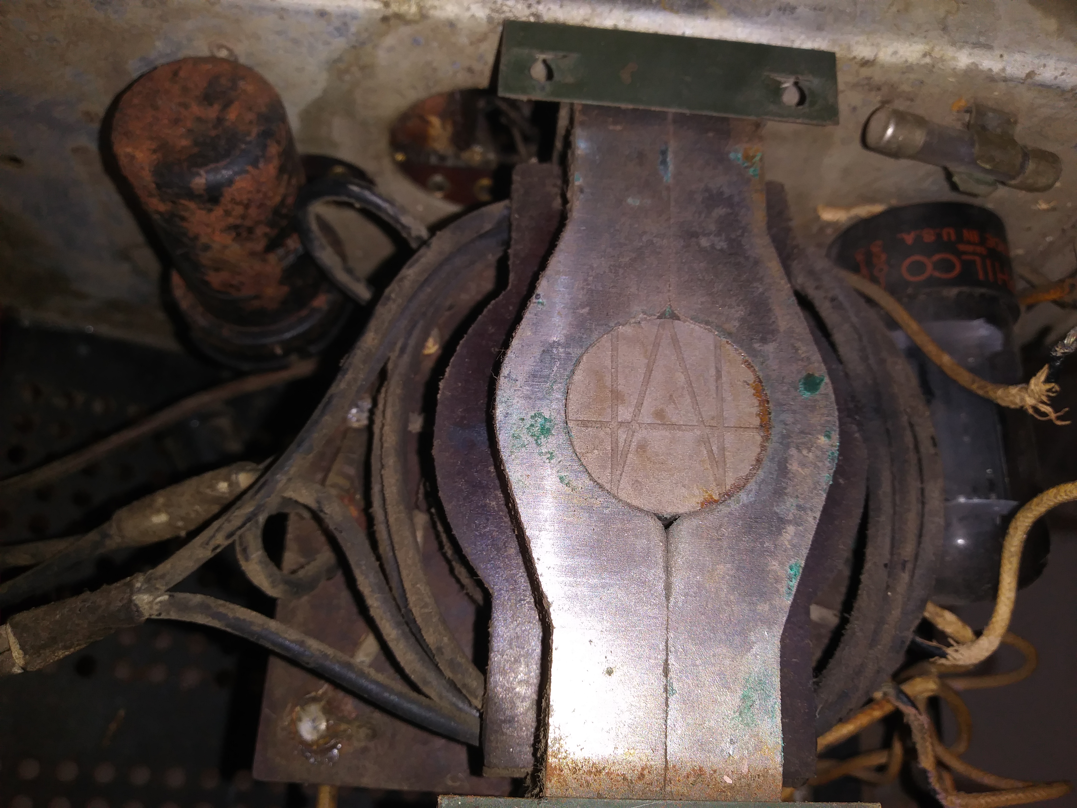

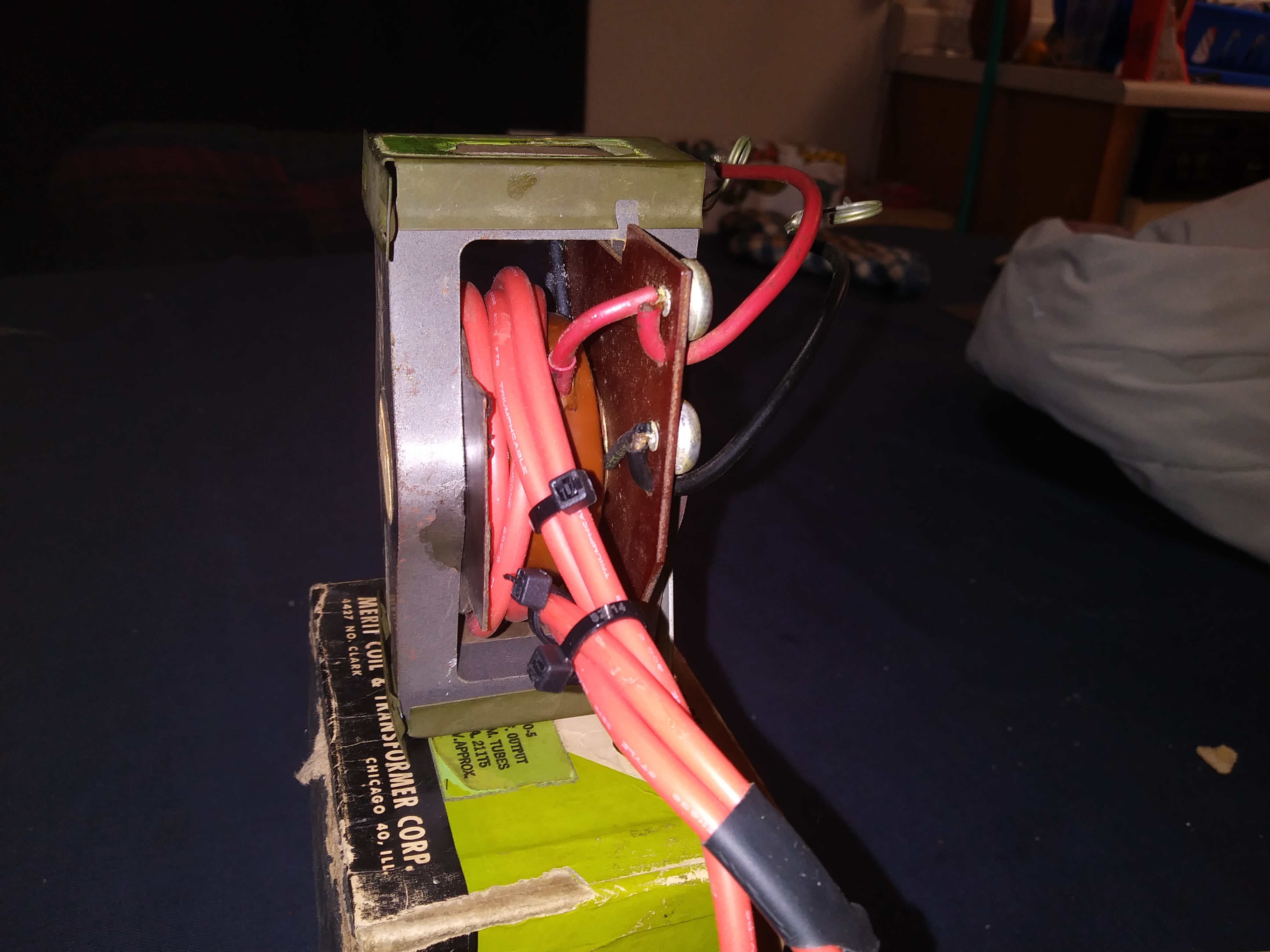

new FBT vs the old..
http://suzaku.live-evil.org/0309251302.jpg
http://suzaku.live-evil.org/0309251304.jpg
http://suzaku.live-evil.org/0309251303a.jpg
It's indeed a merit made unit!
i can swap the broken pats!
the wires in the HV cage is awful. falling apart, needs to be replaced.

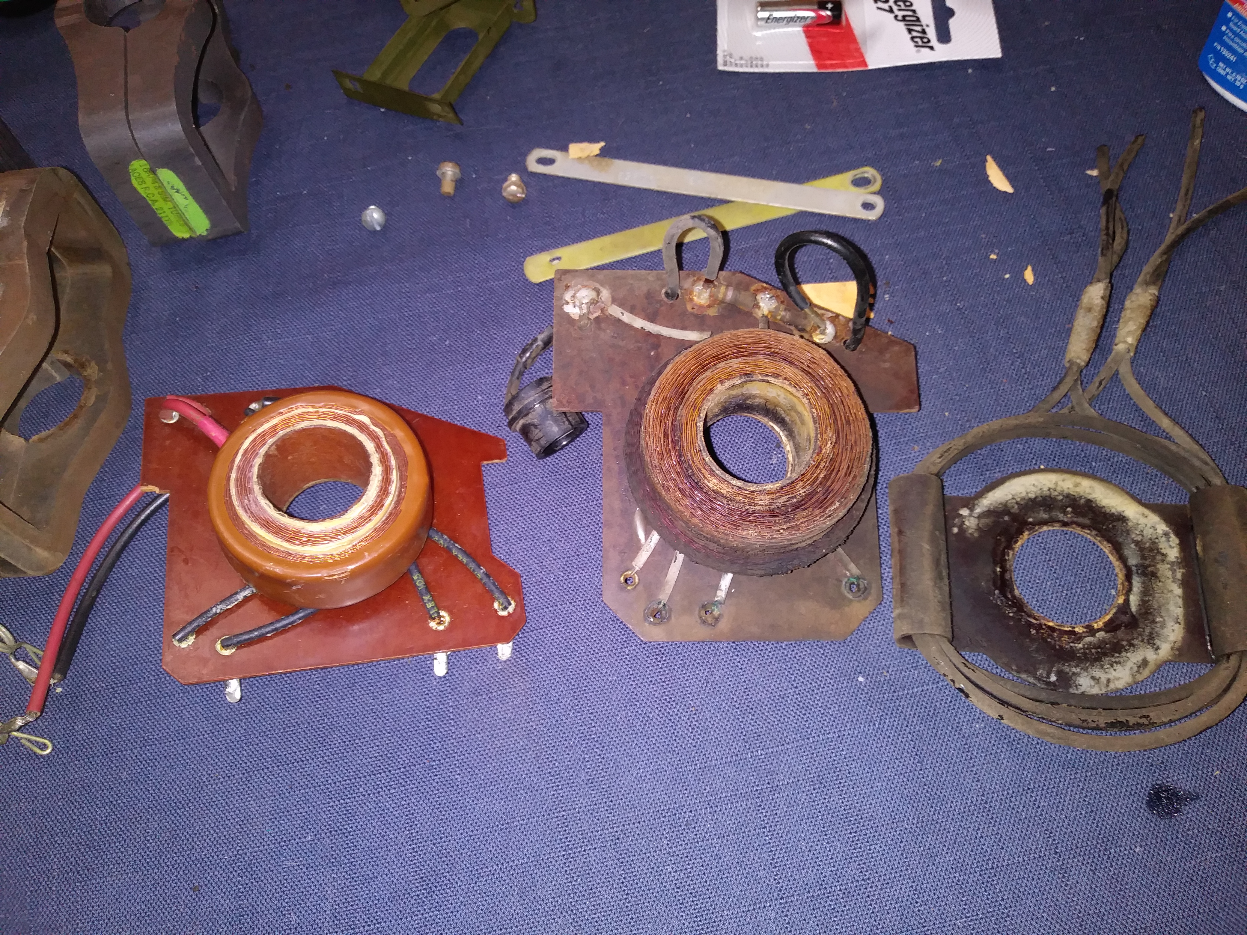

Old windings vs new.
http://suzaku.live-evil.org/0309252037a.jpg

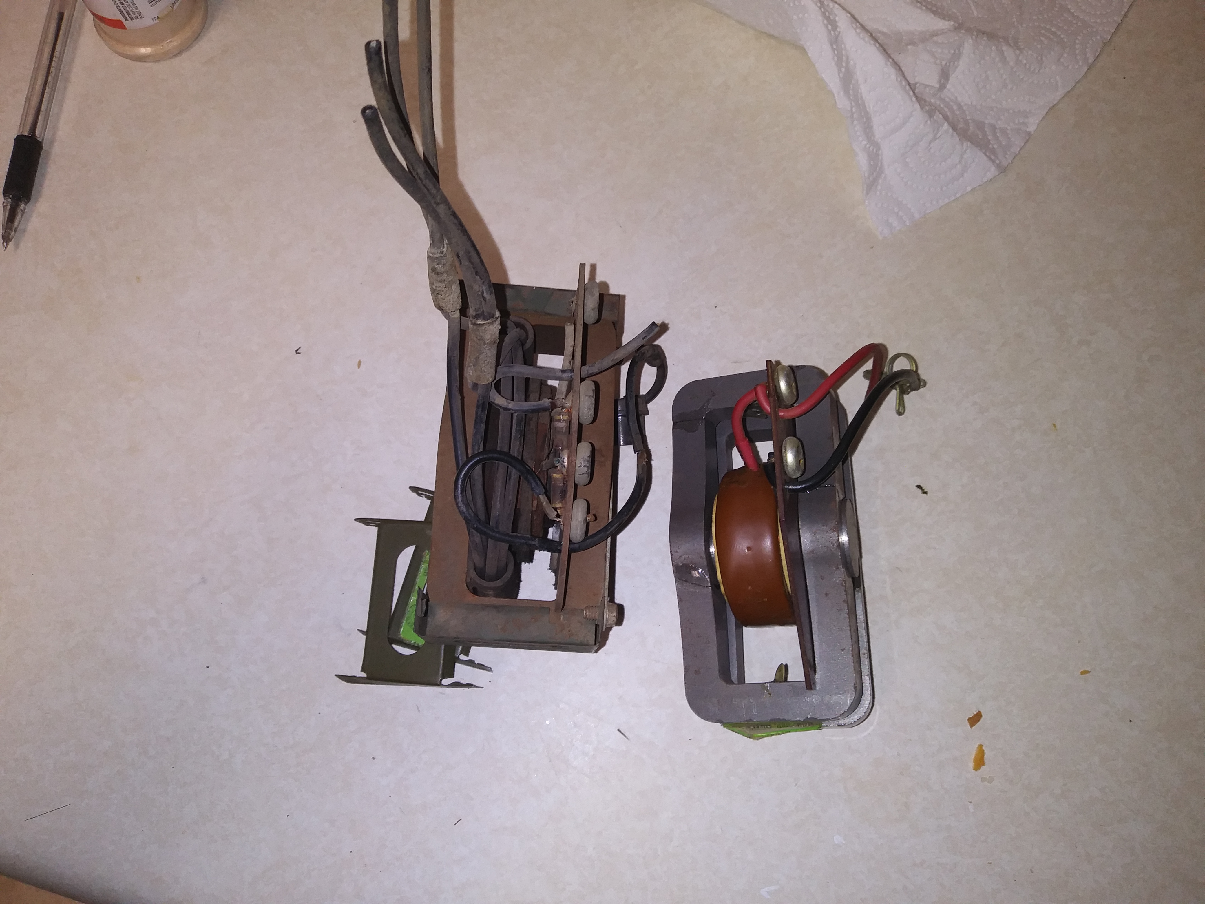

It's Frankenflyback!
http://suzaku.live-evil.org/0310252008a.jpg
