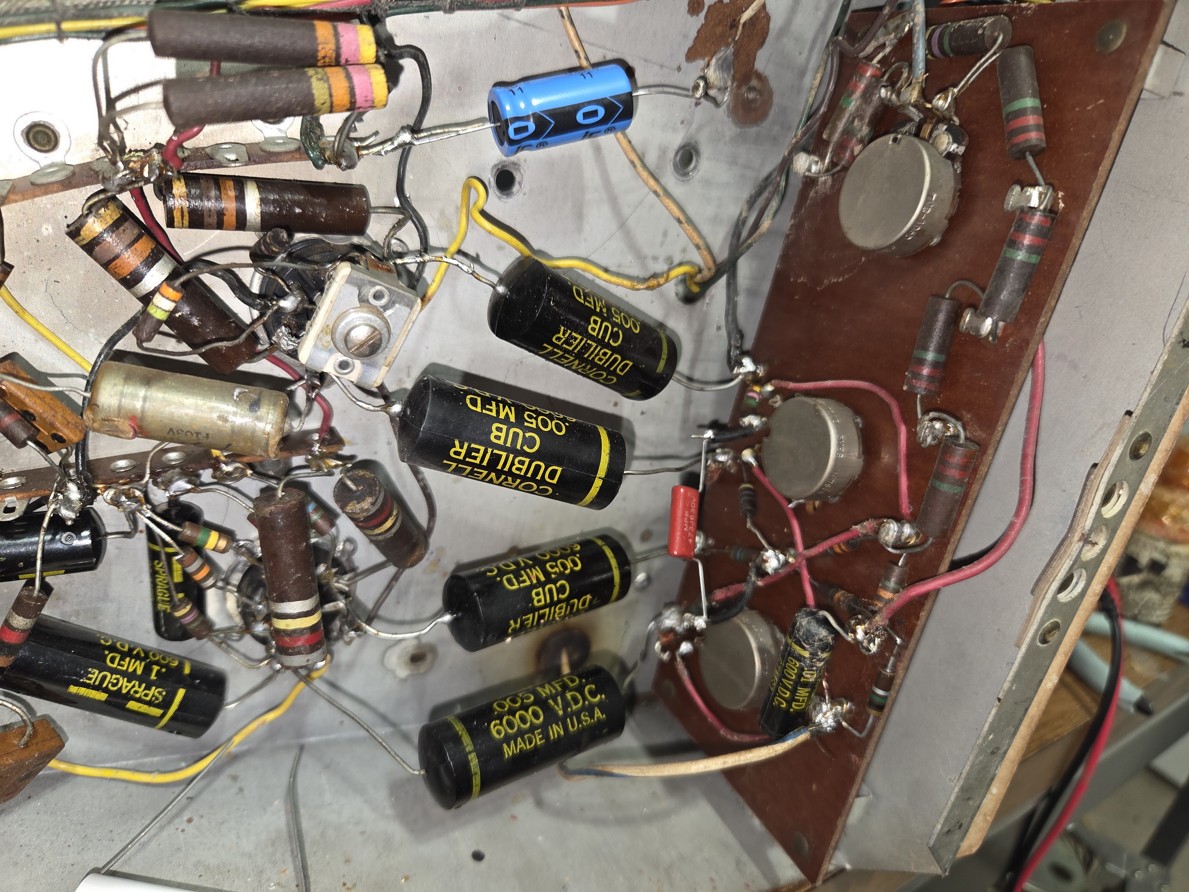

Someone did some sloppy work in the HV part down there.
http://suzaku.live-evil.org/20260411_000050.jpg
frayed wires, pointy bits. all the things you dont do.

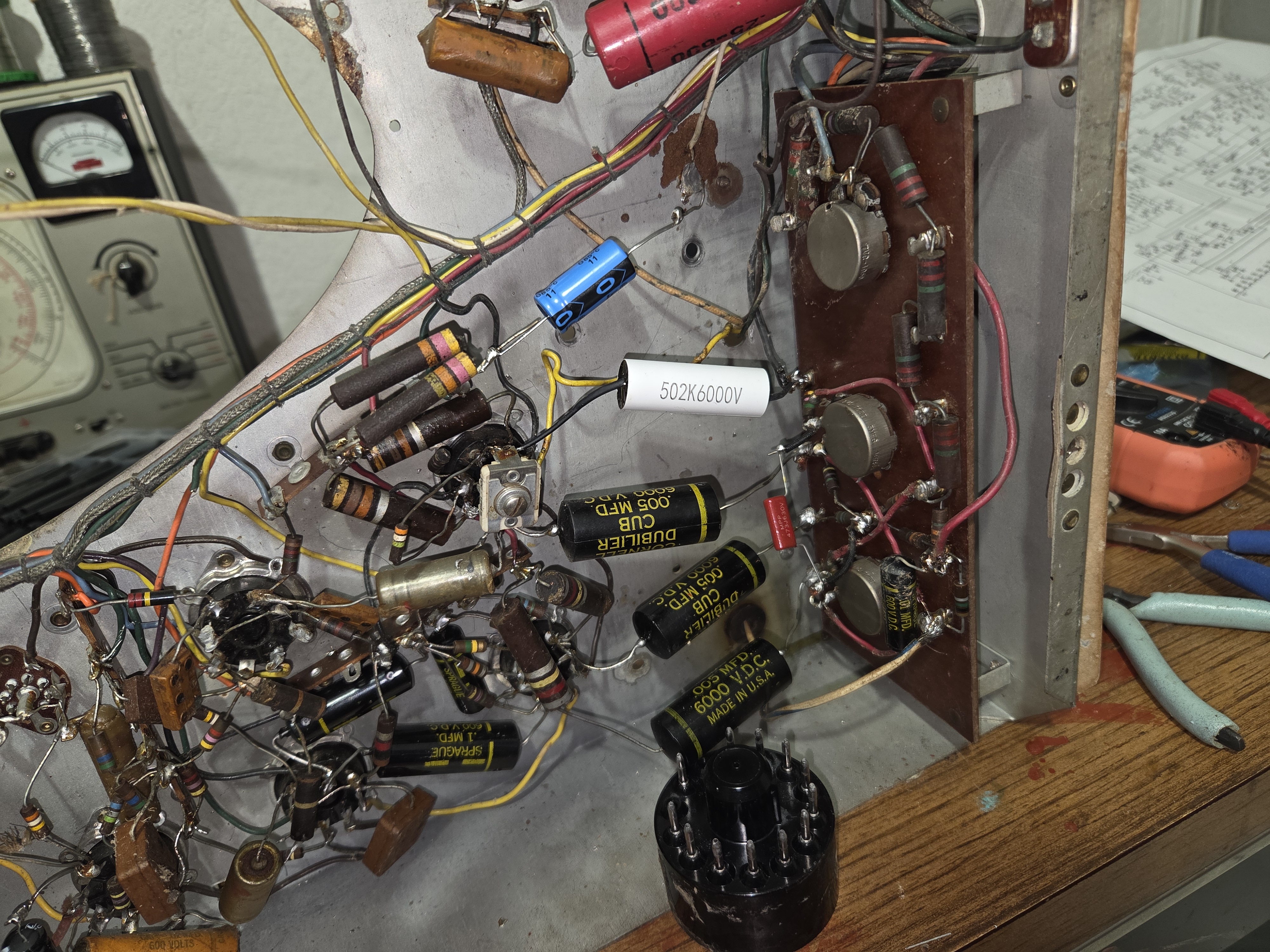

Here is a better shot of the nightmare waiting for me in the HV deflection control area, I test fit one new caps, just to se how it's going to go, someone has been there before, cold solder joints in the resistors, peaks, burned wires, burned Cap?
I also snuck in a cameo of the new pin cap for the 21FJP22A.
http://suzaku.live-evil.org/20260412_154430.jpg
Still waiting for more adapt-a-caps, want to do the PWS section first.

Nightmare? That looks as nice as open as I've ever seen.

It's almost as if that area was built from kit, or someone re-built it who did not know what they were doing, frayed wire connections and peaks are a big no-no when it comes to 5kv+ circuits, I'm going to get some 6k rated wire when I redo that area, gonna use regular 1w film resistors, one of which is just wrapped around the post, no solder, I don't think this set ever worked.

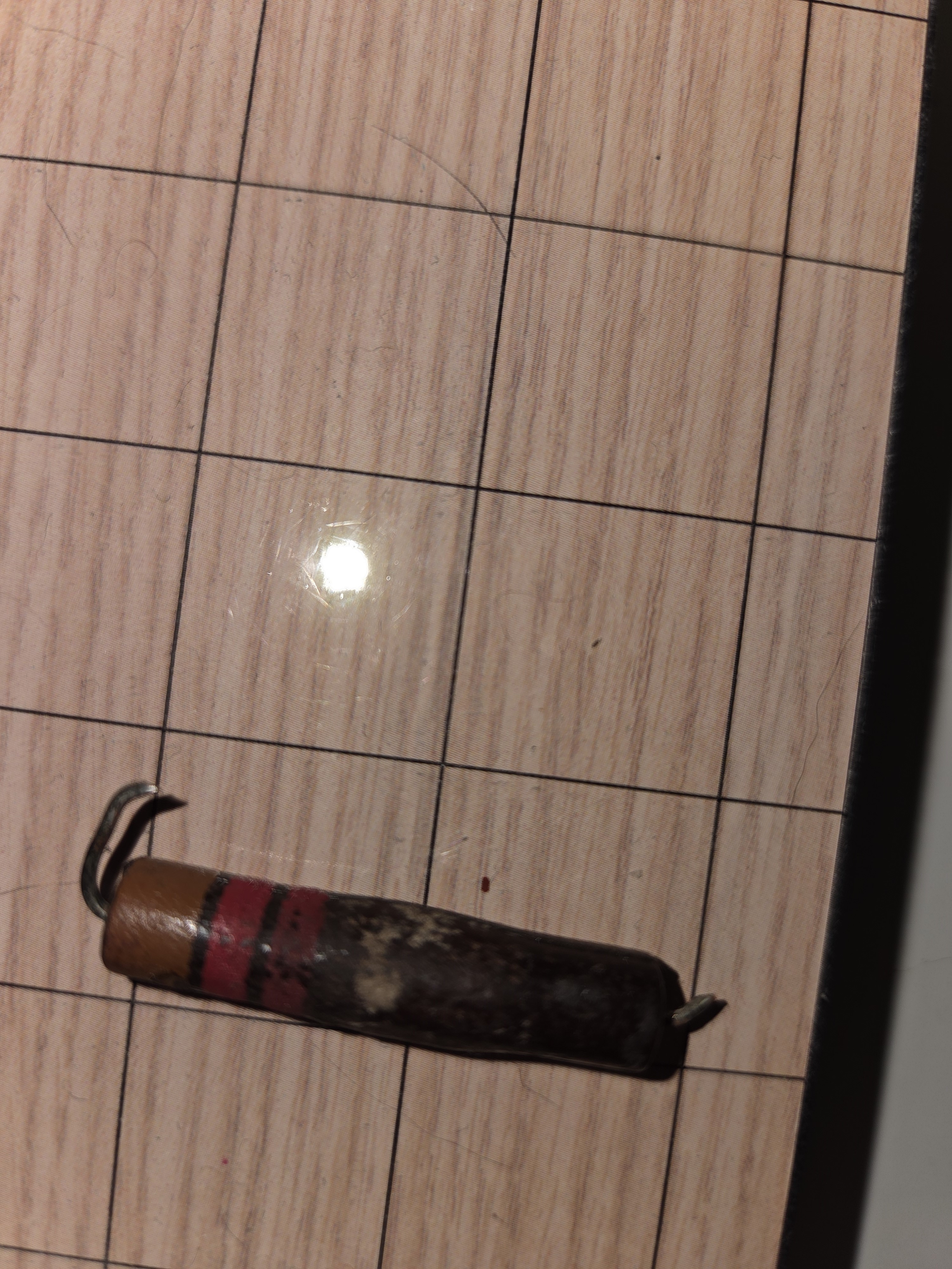

This USED to be a 1.2k resistor... but not any more!!!
http://suzaku.live-evil.org/20260422_191559.jpg
It go BOOM!
http://suzaku.live-evil.org/ooops.jpg
says it was a 1w on the b- line, putting in a 2w.
gonna be a while till I can do a test power up.

Did you find What cooked that resistor
