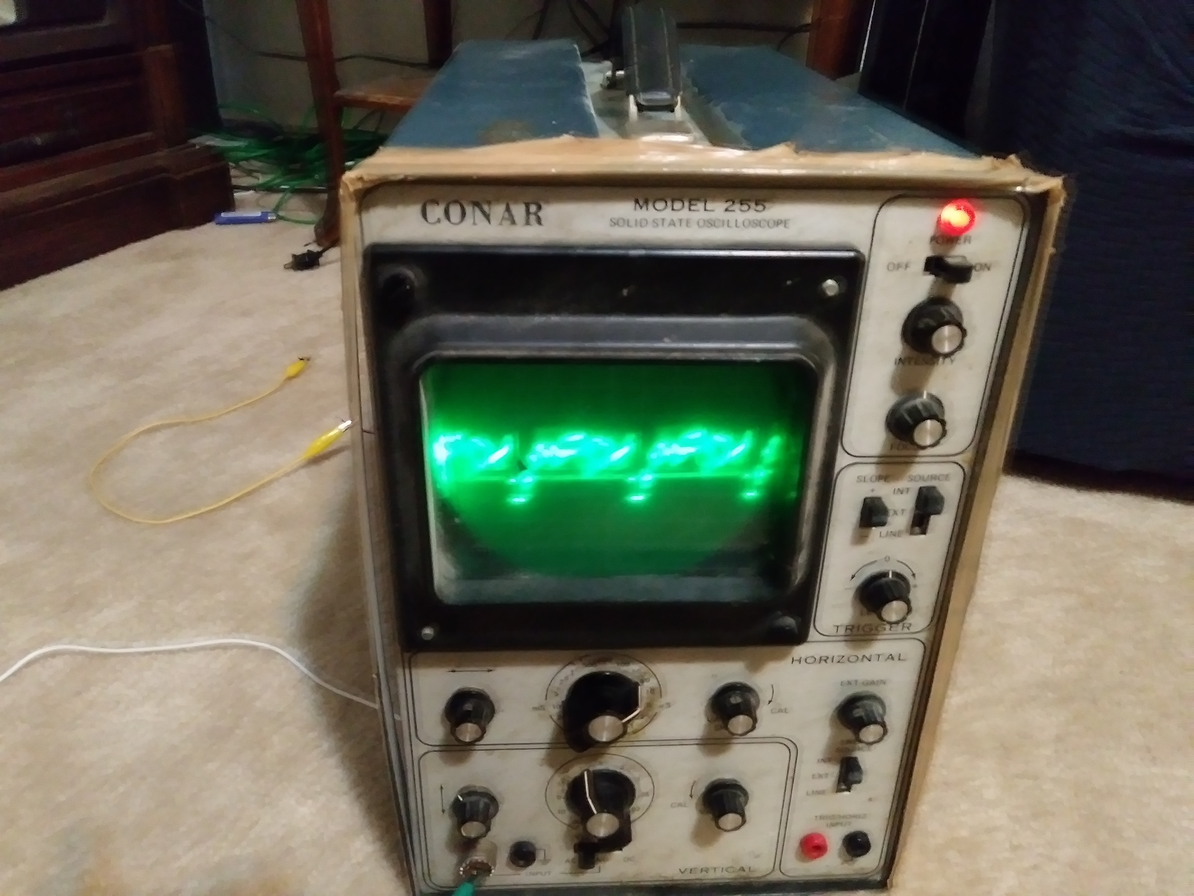

Att Timmy!
http://suzaku.live-evil.org/1011221837.jpg
This Mostly OK working oscilloscope can be YOURS for the price of shipping + a probe that you can get on amazon!
all you have to do is PM me if you are interested!

If I still had the spare scope I sold a few years ago I'd have made the same offer.
Out here good Scopes can still be found at swapmeets and hamfest for $10 if you keep an eye out long enough.
