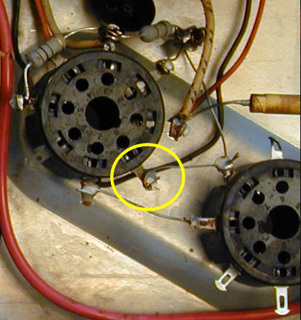

Yah, who knows what really happened with that flyback. I know that I saw a big blue arc and a bunch of new melted wax, and I know that the TV works well now. The rest is all guesswork.
I dug out my little old dime-store analog meter and it pegged the needle in the 250ma scale, so I guess the current is higher than the 100-140ma given in the schematic (assuming that this 25-year old Radio Shack special is accurate). Not sure where to go with that, since the grid voltages on the HOT look normal, as noted earlier.
http://antiqueradio.org/art/temp/Phi...MSchematic.jpg
I'm a little peeved with Philco for using cheap sockets on the HOT and damper. Their terminals are above the chassis.
When I began unsoldering the cathode lead, the terminal instantly snapped off. Altoid tins are made of better material. The pin socket is like a bent strip of tinfoil with holes -- not very practical to repair. I have wonderful new sockets in the parts chest, but they're a normal style with terminals on the bottom. The original sockets are wedged into tabbed holes in the chassis, so replacing a socket with a standard type is not a plug-n-play job. Meanwhile, the TV plays fine with a cathode lead soldered directly to the HOT pin, so I'm tempted to pretend that I never saw those oddball sockets.
Leaving the old fly in place is sounding better. Instead of looking for more trouble, I'll play the set for another long spell today and see how it holds up.

I dug out my little old dime-store analog meter and it pegged the needle in the 250ma scale, so I guess the current is higher than the 100-140ma given in the schematic (assuming that this 25-year old Radio Shack special is accurate)...
When I began unsoldering the cathode lead, the terminal instantly snapped off. ... The pin socket is like a bent strip of tinfoil with holes -- not very practical to repair. .... Meanwhile, the TV plays fine with a cathode lead soldered directly to the HOT pin, so I'm tempted to pretend that I never saw those oddball sockets.
Vertical linearity still needs improvement, but that's about all I've got left to fret over.
It's ugly and crude, but it worked. However, it would bother me too. If you can get to those sockets easily, I see what looks like the metal of the pin and terminal metal in the rectangular slot halfway between the actual pin socket hole and where the terminal sticks out. Using a smaller soldering iron tip, you might be able to melt some solder to one side of the metal I see exposed in that rectangular slot, and if you can, connect that cathode lead to that point. Slightly less ugly.
Or as you said, just pretend it's not ugly. And I'd just tag and leave the new flyback on the shelf, so you can break it out if the old one does die. Not borrow trouble.
Oh, you could test your rat shack meter with a resistor and a source of DC (ohms law) to see what 120ma looks like on it. Though it's not DC on a cathode lead on a HOT. As mentioned above, use the 0.1uf bypass cap on that cathode, close to the tube.

Fixing the socket terminal was a good idea. I got a wire through the side of the socket, wrapped it around the little holed piece on the inside and the old stub on the outside, and soldered. Left a pigtail until I'm done messing around in that area. It won't survive caveman yanking, but the original terminal wasn't that sturdy, either
With a .1 uf cap in place, I measured 118ma cathode current with the Triplett meter. That's the middle of the 100ma-140ma range given in the schematic. I'm going to quit stressing over this, since the voltages on the HOT and general performance are also normal.

Looks good. I'd probably just solder the other end of that pigtail to the terminal of the other tube socket (gently!), maybe creating a loop with the old wire to hold the pigtail to the terminal when you solder.
