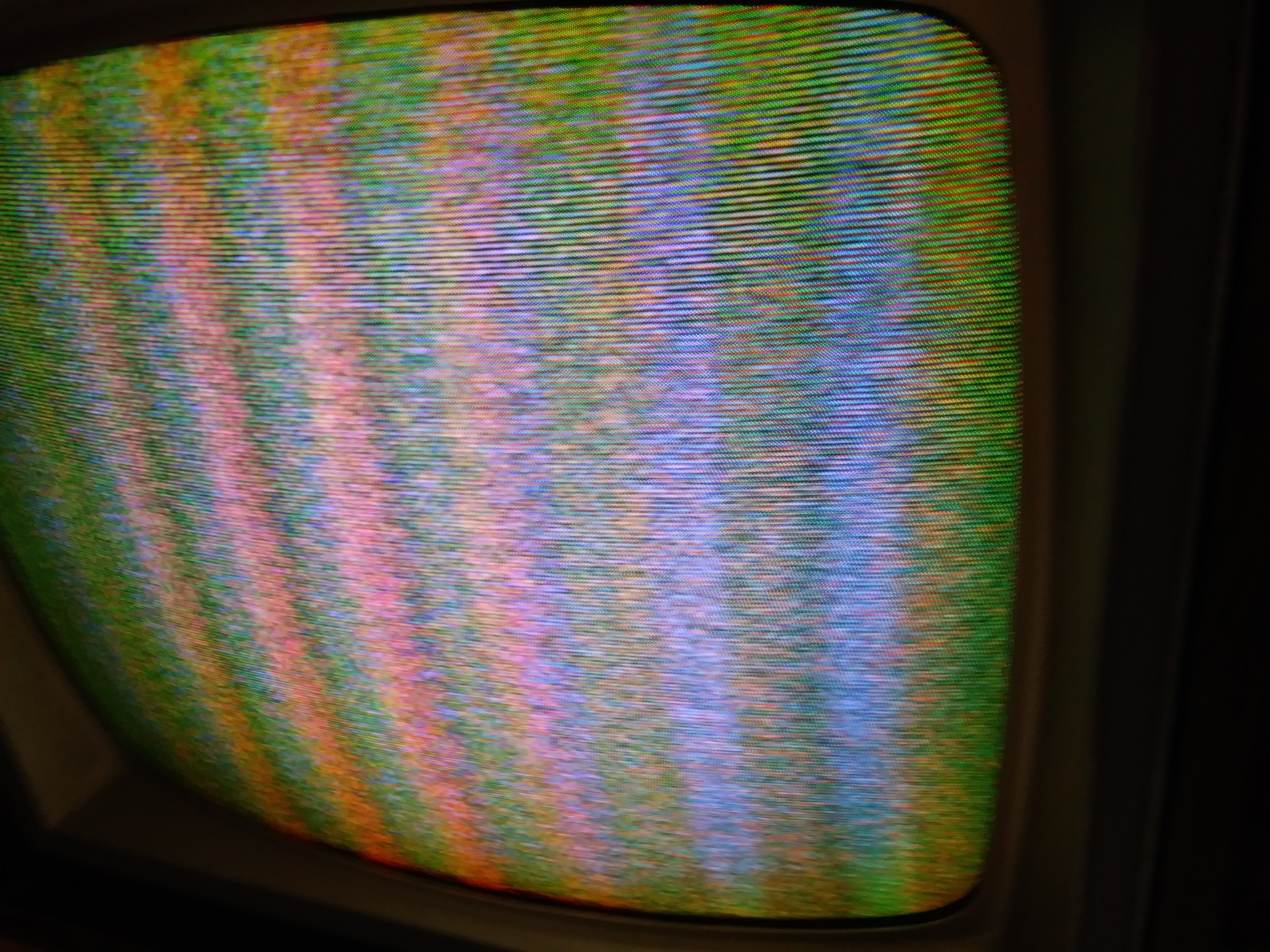

AHHHH! That explains the odd behavior I saw last night!
Turns out that what is stamped out in the back of the chassis for the controls is NOT what they really are, they had stickers to show what they were, but they are long gone, what was marked as CRT bias was really VIDEO PEAKING, which was set in top most setting, and I sort of freaked when I changed it and lost picture and just got a blank raster.
Meaning there may be bad caps or more likely bad resistors, or the switch itself is dirty.
The REAL CRT bias adjustment is indeed a potentiometer, just as the SAMS says, but in a position stamped for something other than CRT bias, and when checked, much to my relief, it was turned 1/3 the way up when it made the video posted yesterday!

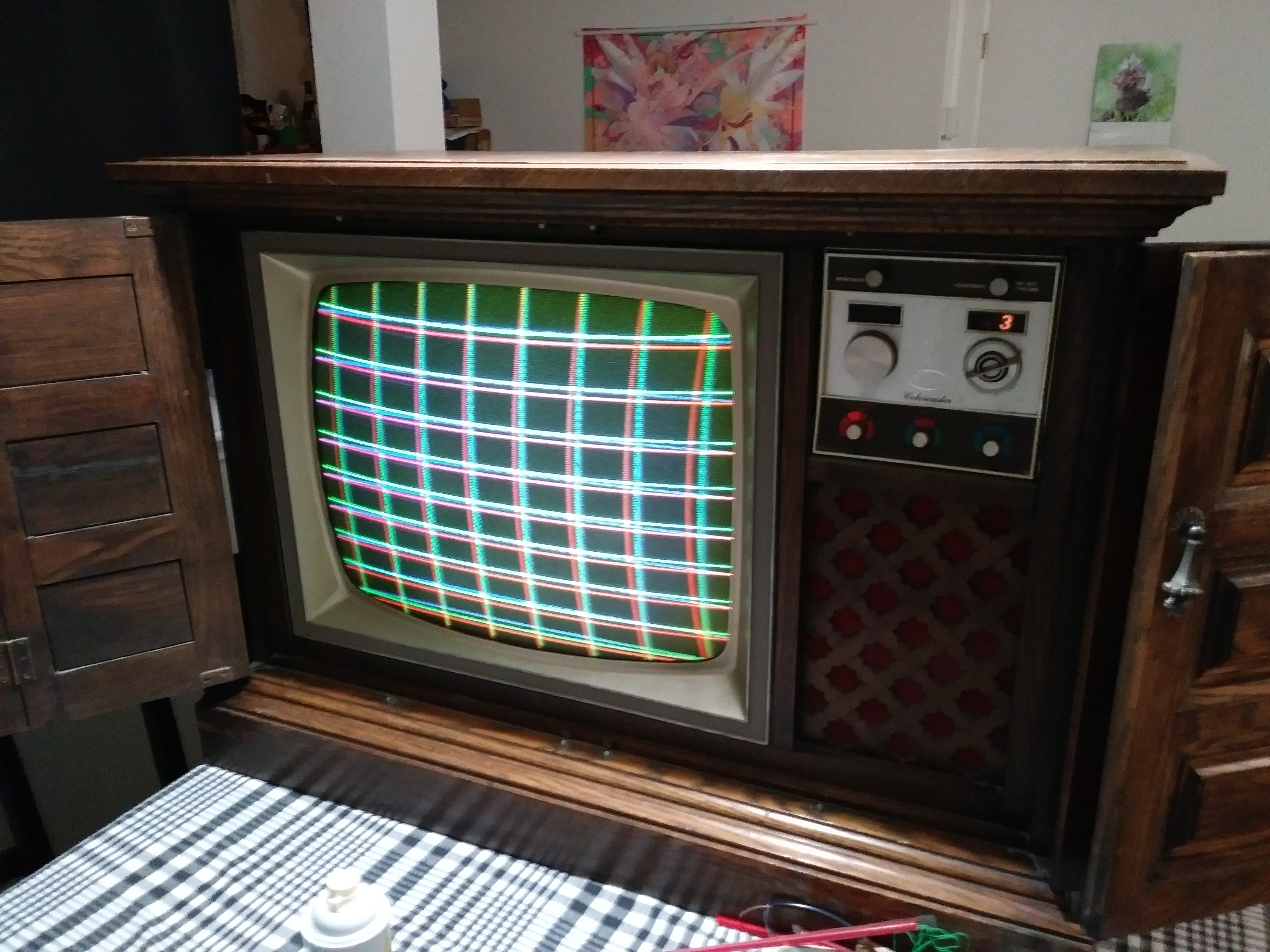

I did find ONE of the stickers that fell off, for top/bottom pincushion.
I did manage to clean up the convergence a bit, will make one more vid before I yank the chassis to haul upstairs to go over it with a fine tooth comb looking for out of spec parts.
It's looking rather well considering it's just been patched together and I did not put the blue lateral/purity assy back on yet.
The whole thing is just too big to bring upstairs, but at least they made it easy to unplug / reconnect the tuner / front controls, just 2 plugs & the IF.

Looks a lot better!

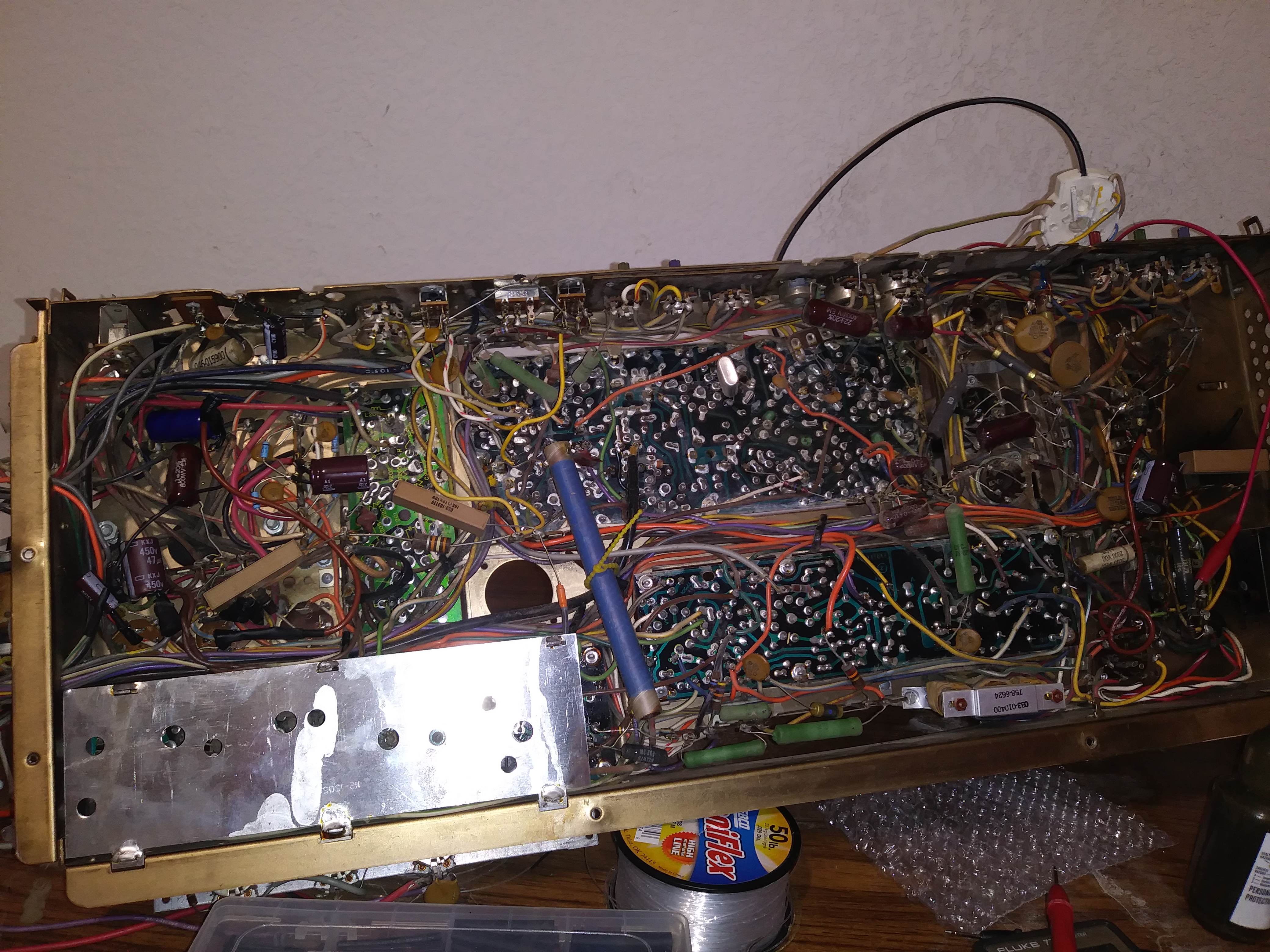

So far, I have been over 1/3 of the color PCB and i have not found one out of tol resistor yet of the ones the I CAN test w/o removing them from circuit, starting to think that it's not worth checking them at this point any more :O
Old 07-24-2022, 01:09 AM
Posts: 3,206
Recapping 1/2 done (electrolytic)
