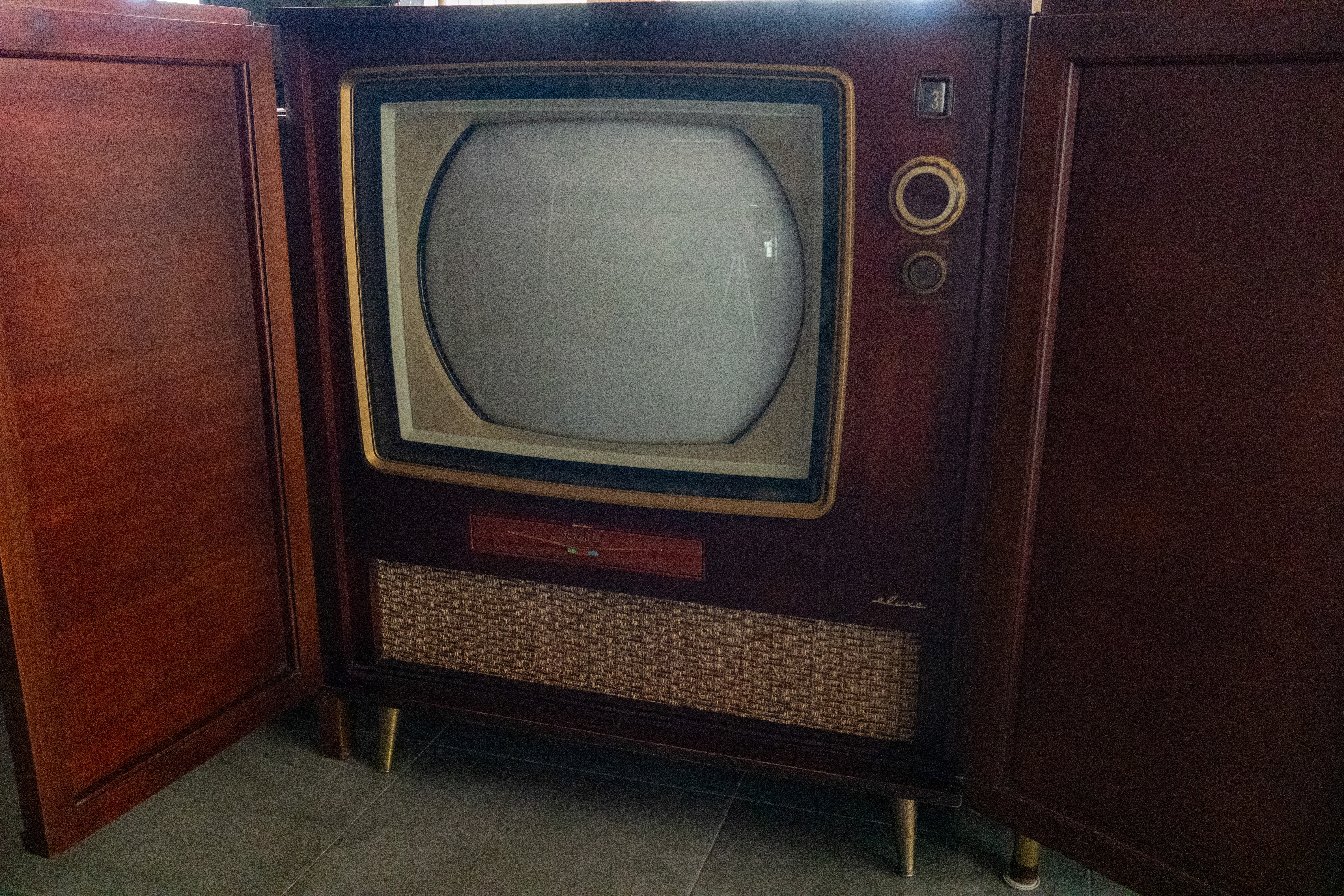

Good day to all. The last CW transformer and socket repair may have fixed the hue drift. Mike reports after 3 days of cooking the CTC-5, the set is stable. If all continues well, we are looking at a July 22, 2025 delivery.

The restoration by Mike Doyle was completed today with the delivery of the RCA CTC-5 Chandler Deluxe model to my residence. Watch a 3 minute video to see the results.

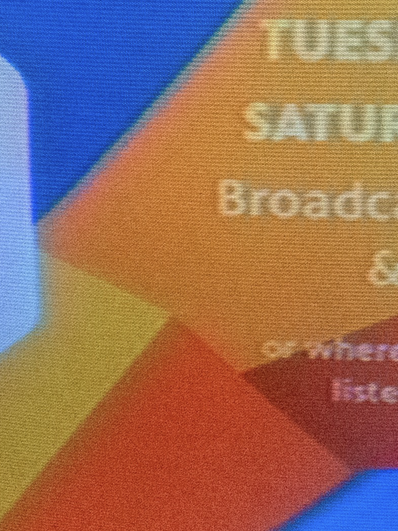

  #69
Old 07-26-2025, 02:43 PM
Posts: 1,640
As requested by Penthode, a few closeups.

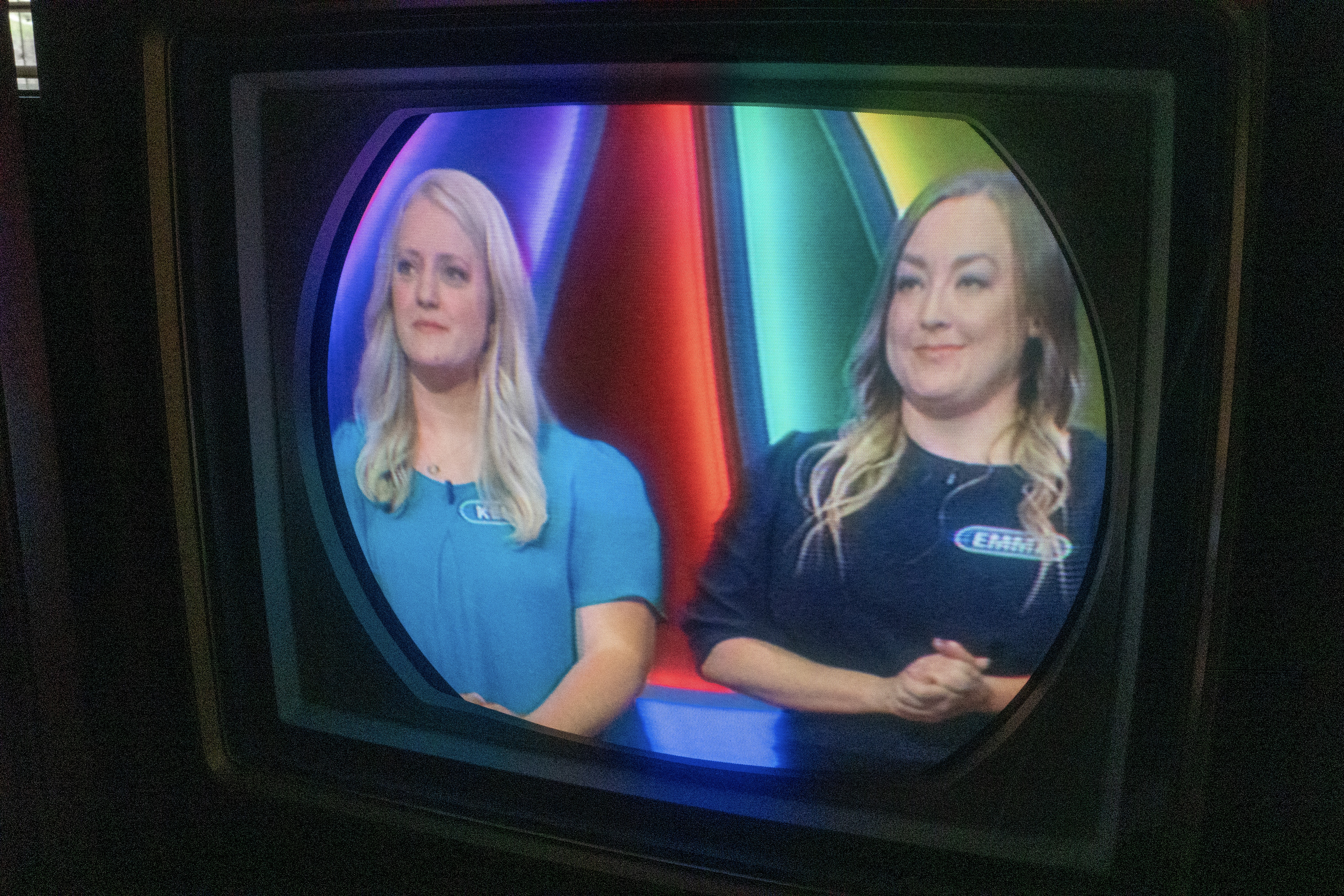

  #70
Old 07-26-2025, 02:54 PM
Posts: 1,640
I noticed a “softer” picture, Mike who did the restoration commented that on all the CTC-5 restorations he worked on including his personal set he saw the issue due to the 1st video amplifier circuit being very marginal to drive the final stage. He has a fix which he applied but contrast is sometimes not enough.

  #75
Old 07-26-2025, 03:50 PM
Posts: 7,777
These look excellent to me.
A quick lab check for quadrature distortion is to display a color bar pattern and look at the green-magenta transition, which should be neutral at the center for any decoder, equiband or I/Q.
