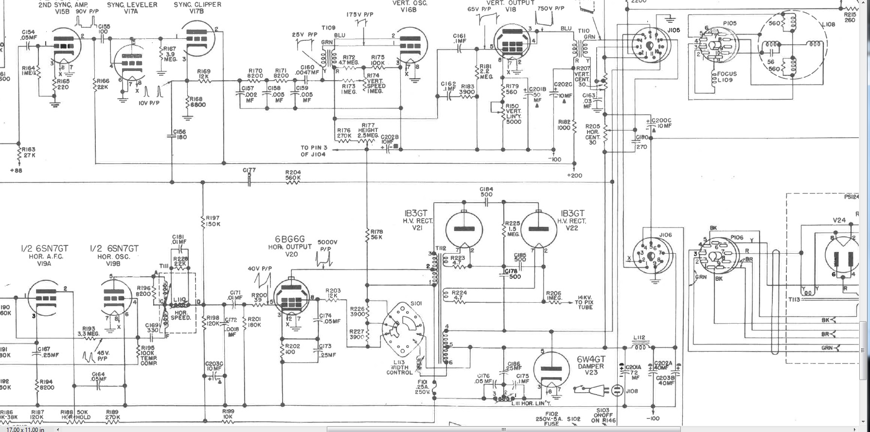

Work is going ahead slowly.
horizontal oscillator seems to be fine, bit a bit low which makes sense sice the FB is not in yet for feedback for it yet. about 28v PtP. on the grids of the HOT.
The vertical oscillator is NOT running, and from what I see it can't If I understand things correctly, the OSC gets power ( T109, V16B) via boost through
r178 from pin one of the FBT, also goes to G2 of the CRT, filtered by C202B.
http://suzaku.live-evil.org/no-vert-osc.jpg
So, if I understand this circuit correctly. long of the short of it is, until the FBT energies and that boost come up, the vertical oscillator won't start.

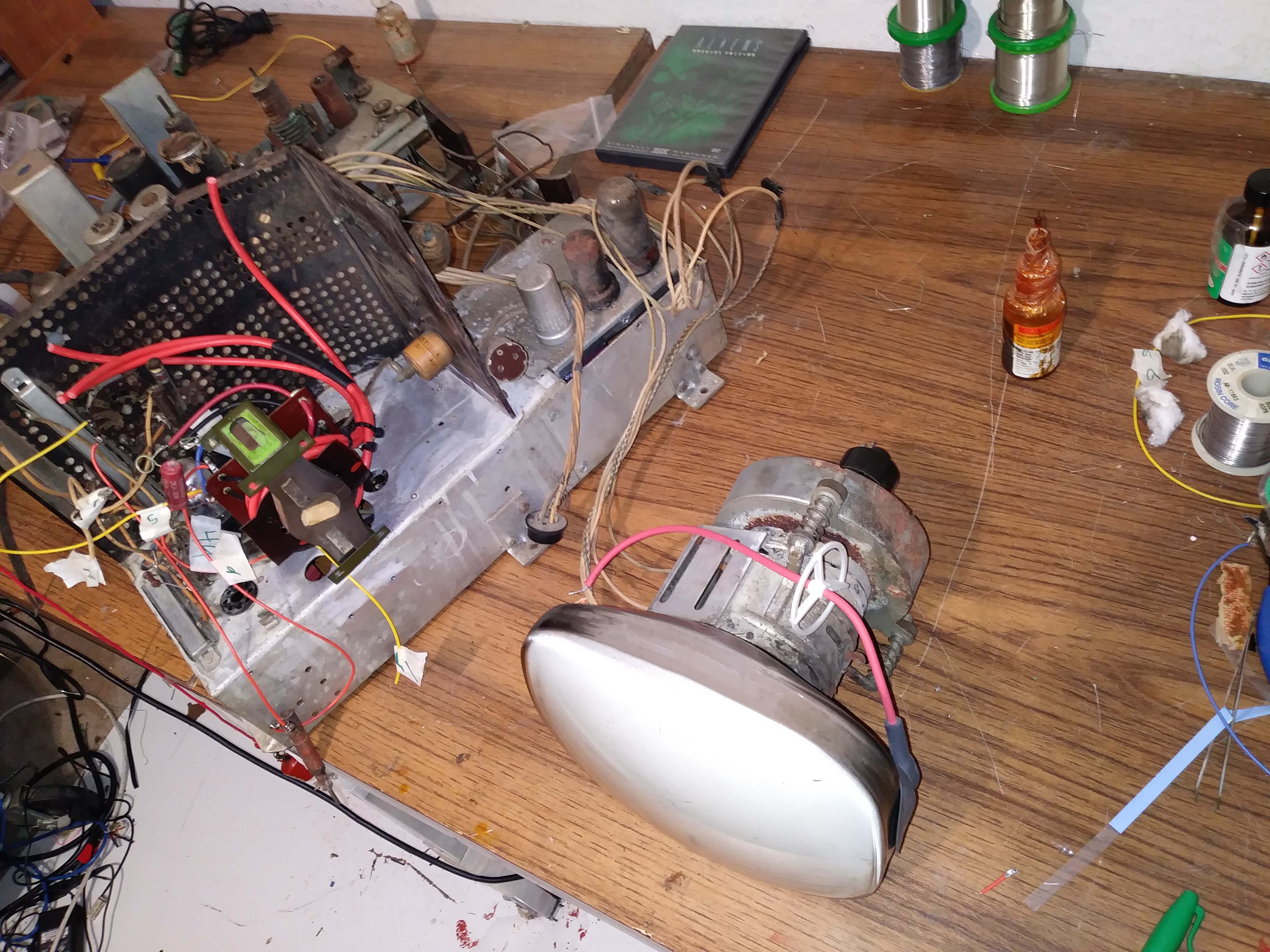

  #66
Old 03-24-2025, 09:05 PM
Posts: 3,204
It might be a bit silly looking once I get a raster/ picture up on this little test CRT!

Things are a bit different from the schematic, which is not unusual.
http://suzaku.live-evil.org/maggy-bad.jpg (re-using this picture)
C178 is not hooked as shown on the left of C185 but is on the right side, and the other is hooked to ground as for the EP4, R225 is testing at 1m I will assume its bad, as I cant read the bands on it, the 4.7 ohm ones test OK, but will be replaced anyway. the entire area was very dirty and needed lots of clean up

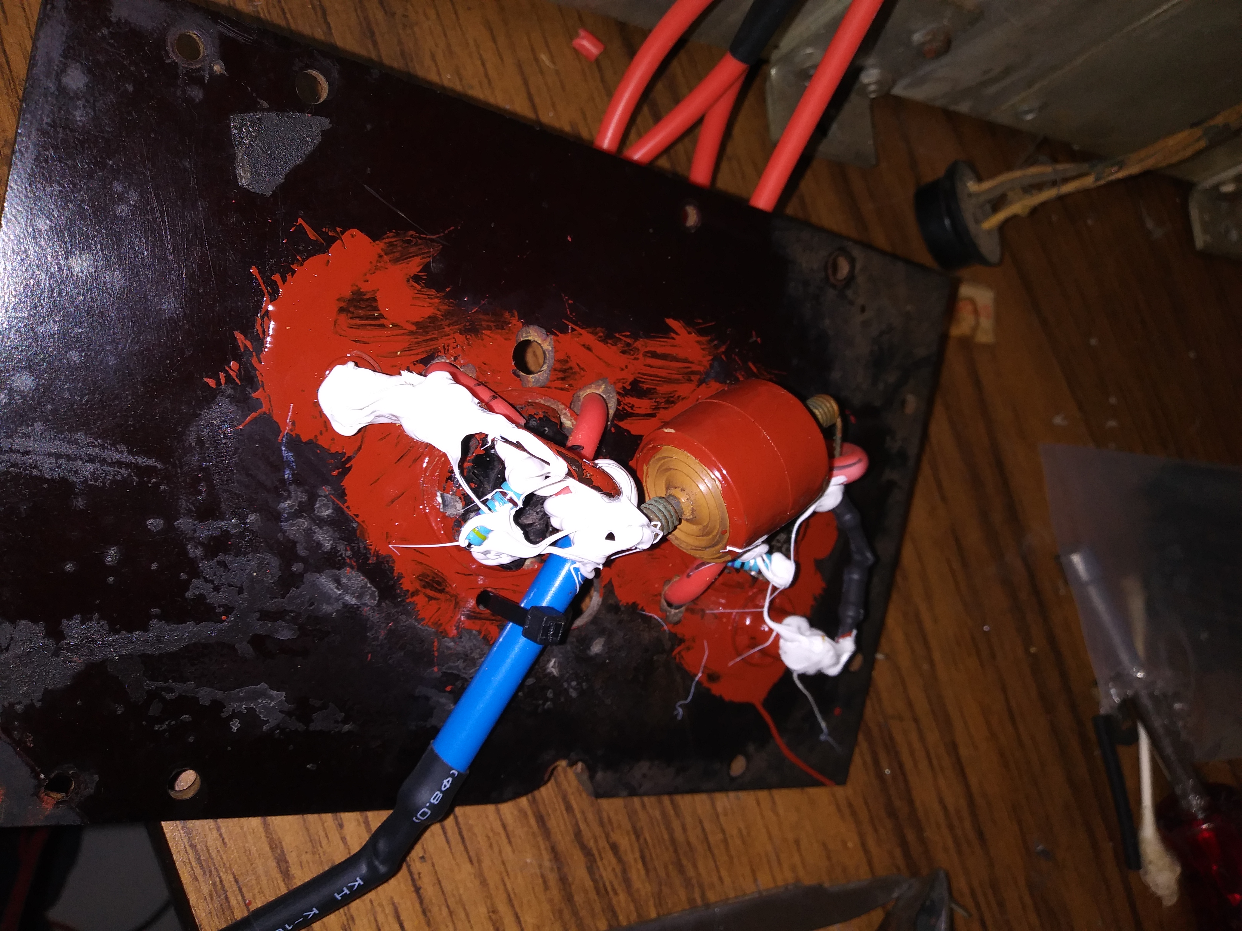

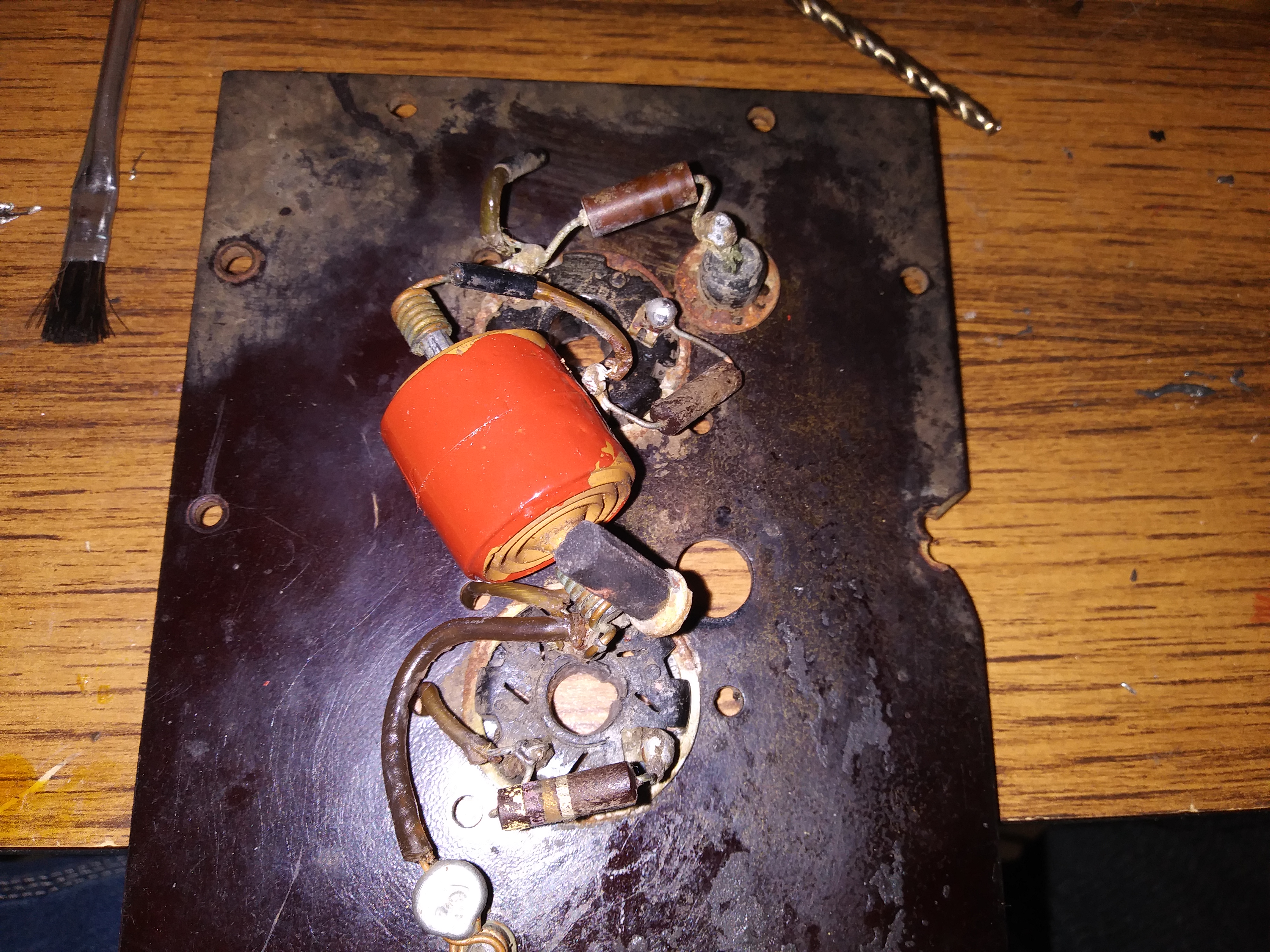

Old 03-27-2025, 10:09 PM
Posts: 3,204

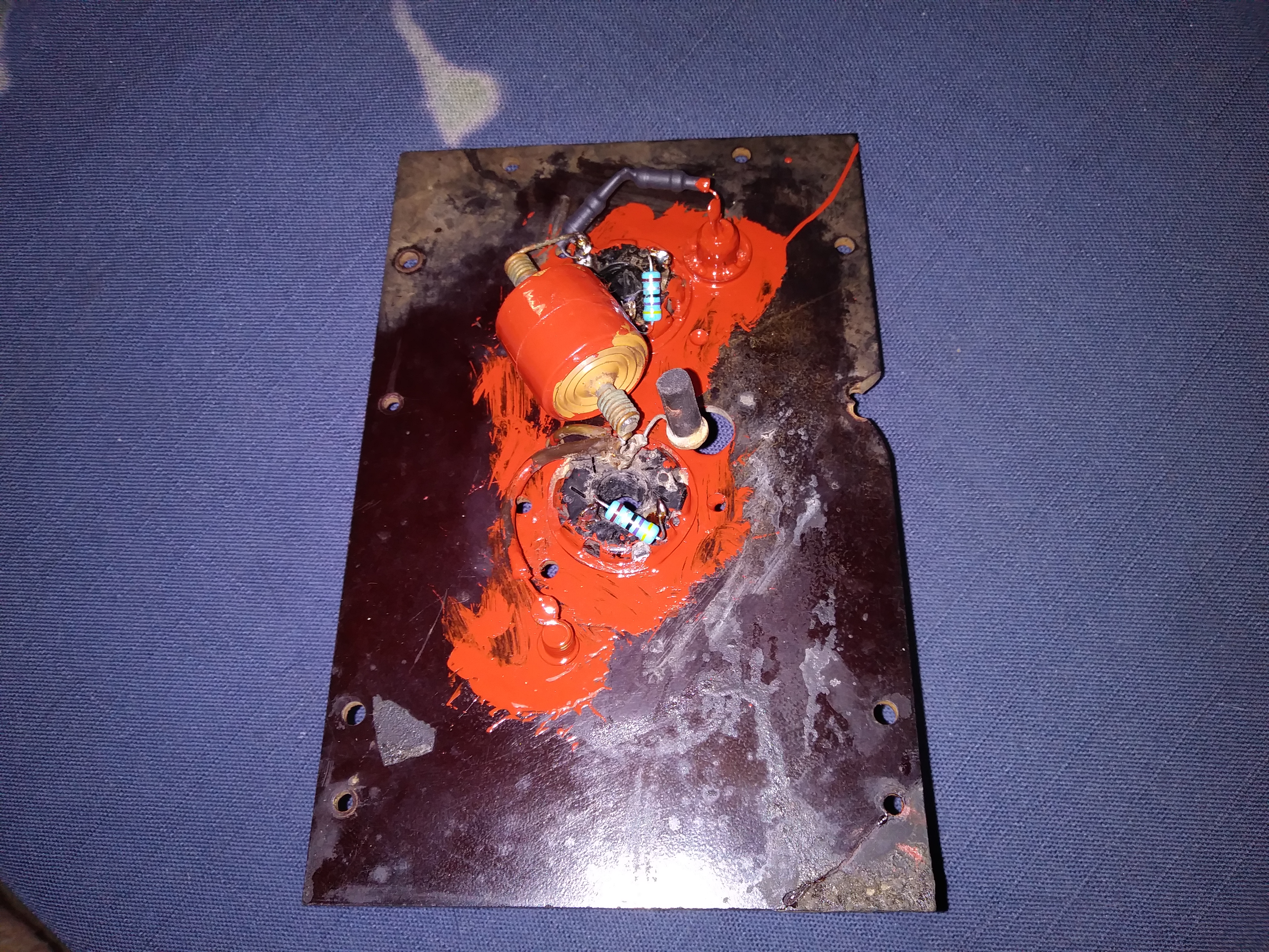

http://suzaku.live-evil.org/0327251948a.jpg
The HV doubler circuit before having the old resistors replaced, lot of bad solder work
http://suzaku.live-evil.org/0327252050.jpg
new resistors in,, don't have the NEW HV 1m one yet.

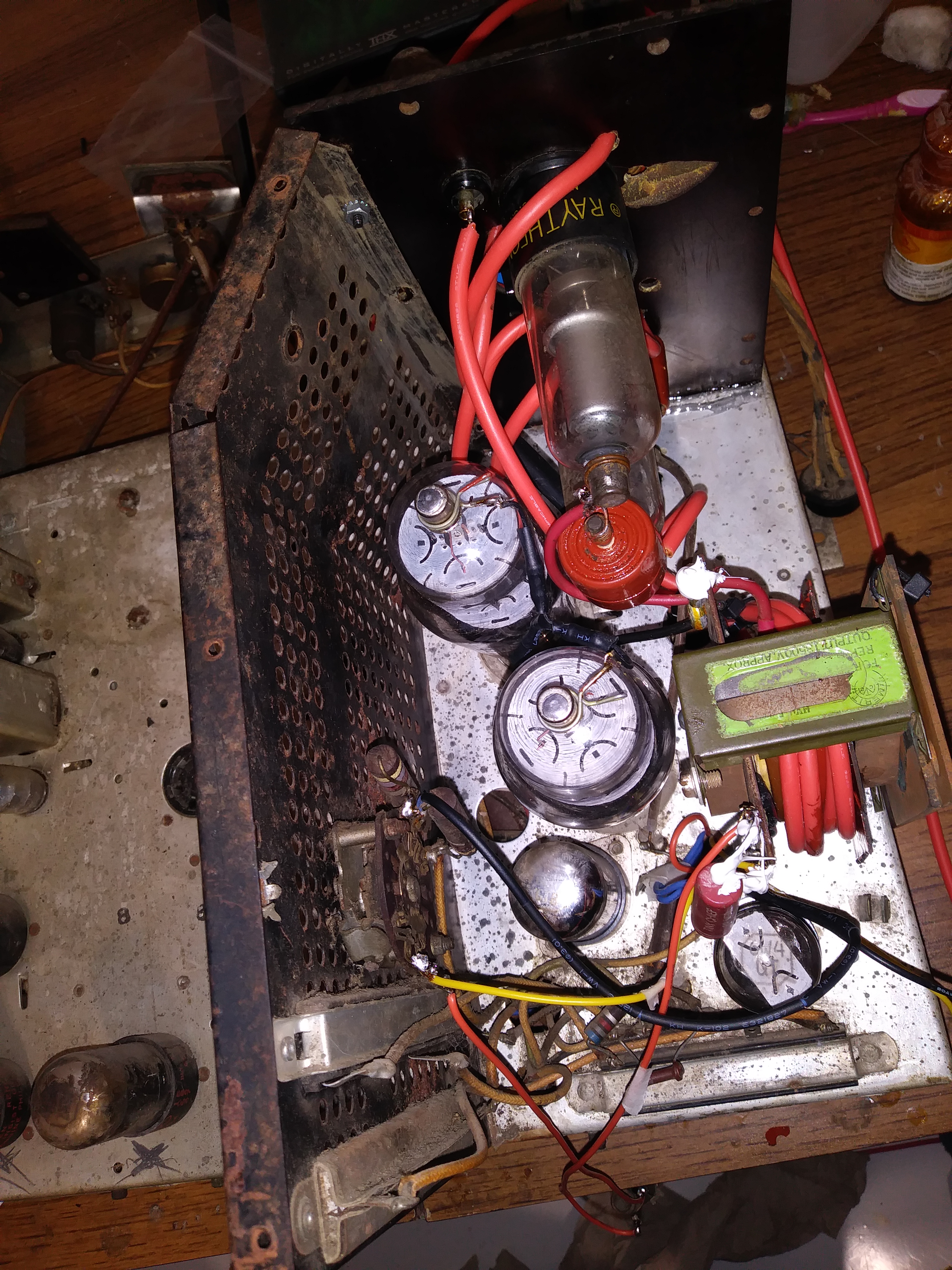

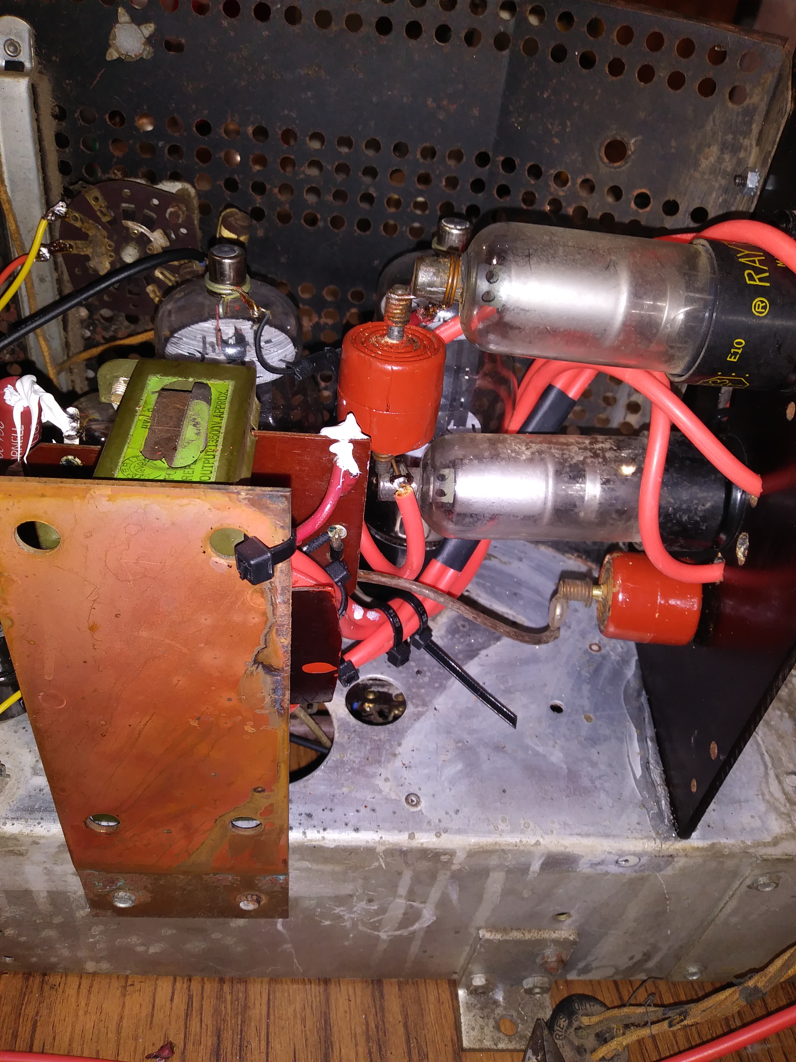

All HV parts are in now
http://suzaku.live-evil.org/0328252209.jpg
Boy its crowded in there!
http://suzaku.live-evil.org/0329250310.jpg
http://suzaku.live-evil.org/0329250315.jpg
gotta wait for the silicone to cure now.

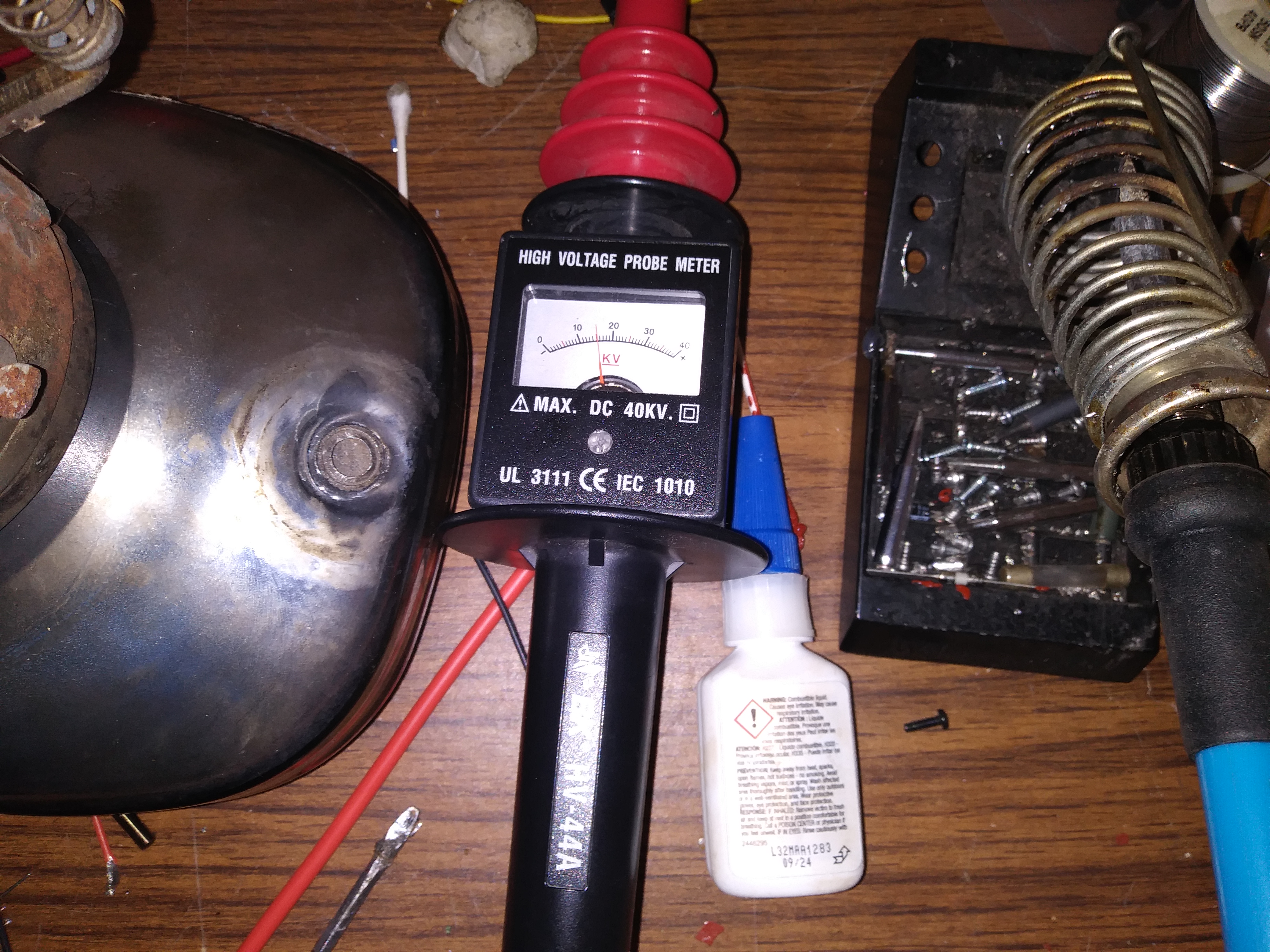

http://suzaku.live-evil.org/0329251102.jpg
Turns out that both 1B3GTs were also dead, had new on hand, so no biggy.

Old 03-29-2025, 11:27 AM
Posts: 3,204
Why did you use a special HV resistor? A regular one would be fine.
It most likely would have, but if you look at the pic of the old resistors, what was in there before was 2 rather large 500k resistors in series, that had broken, I had no ref to what size they were power or what, but I did not have anything near that size physically in my stocks, so if I was going to have to order something, I chose to spend the extra $ for a HV resistor.
