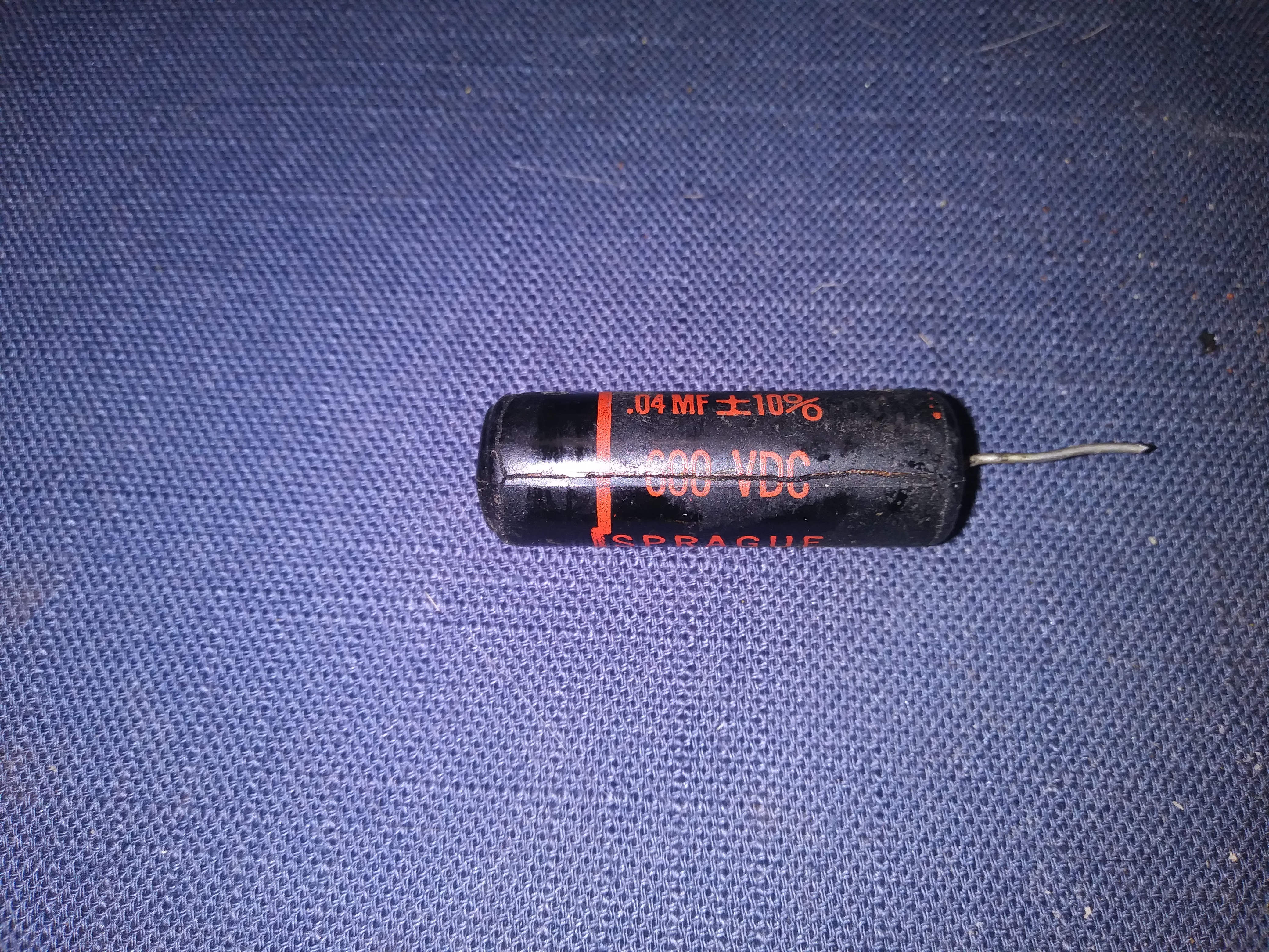

Replacing a few more caps before i try to get a raster, now that HV is working.
this one was REALLY bad!
http://suzaku.live-evil.org/0331251435.jpg
tests at 68pf :O
slightly dif from what was shown in the schematic, C163 off the center of the vert center pot, but it being bad would no doubt had a drastic effect on the sweep.
http://suzaku.live-evil.org/no-vert-osc.jpg

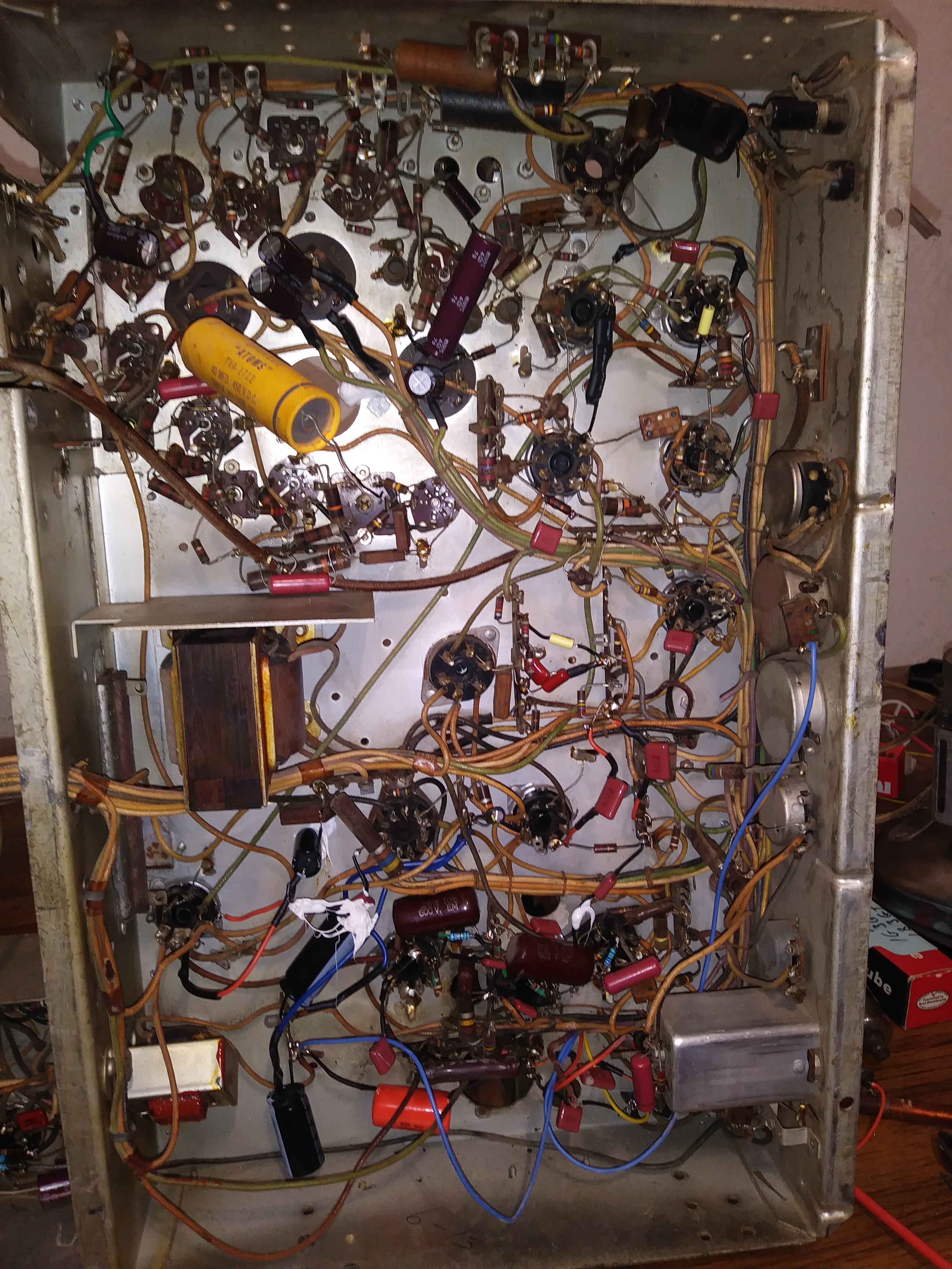

Recapping almost done!
http://suzaku.live-evil.org/0401252124a.jpg
not sure why that yellow cap was stuck in there :O
  #78
Old 04-02-2025, 08:53 AM
Posts: 3,204
That extra sprague atom cap that someone put in there has me a bit confused as to why they did it, they put in that big yellow cap (40uf) in parallel with C200B, (30UF), which did not really test bad, 37uf, a bit leaky, both C200A C200B (30uf) are in the bleeder network, 200C (10uf) is in sweep tests at 14uf.
Why did they add the extra cap?

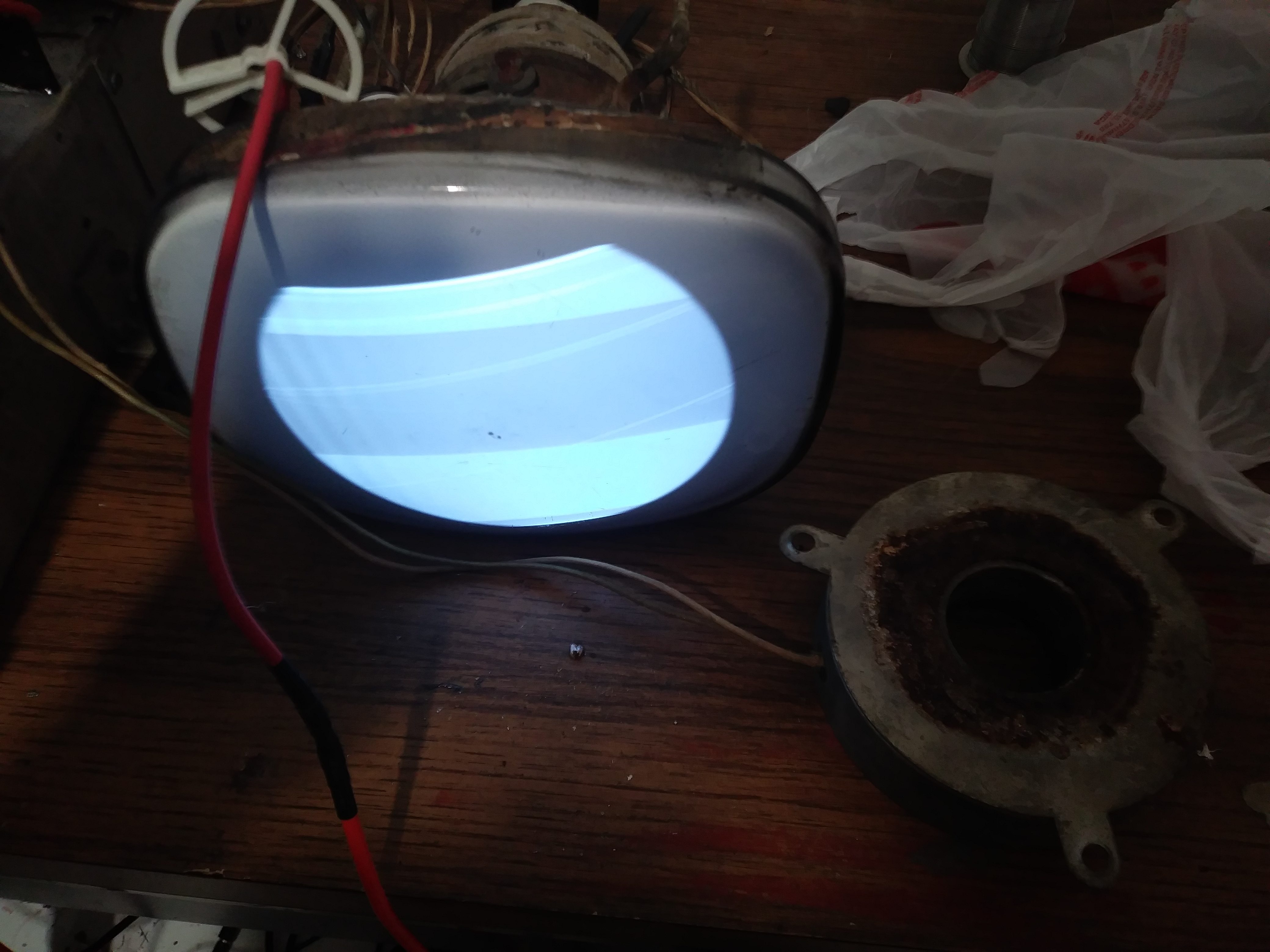

  #79
Old 04-05-2025, 02:11 AM
Posts: 3,204
And there is Raster!
http://suzaku.live-evil.org/0405250052.jpg
No video yet...
but full sweep!

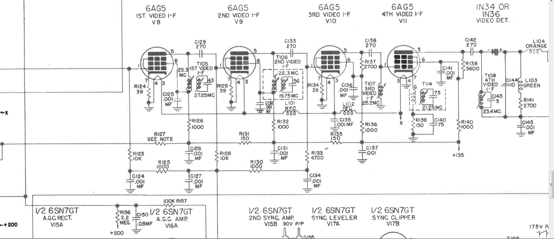

  #85
Old 04-05-2025, 05:03 PM
Posts: 3,204
http://suzaku.live-evil.org/maggie-IF.jpg
R162 =2K R140 1.6K
Still poking around.
So that and old/unknown tubes prob killed sensitivity.
new tubes = $24 with shipping

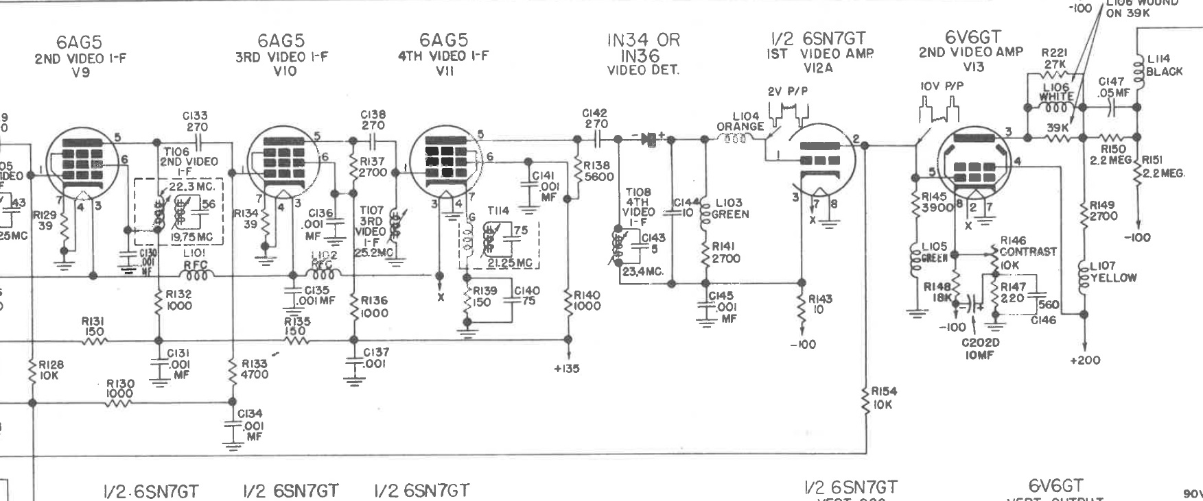

  #86
Old 04-05-2025, 07:03 PM
Posts: 3,204
Another thing noticed :P The detector diode is shown backwards on the schematic, it;s anode to the 1st amp in the chassis,
  #87
Old 04-06-2025, 04:08 AM
Posts: 3,713
Maybe a typo in the schematic like the Motorola vt71 same thing backward diode shown in the sams.
  #88
Old 04-06-2025, 01:07 PM
Posts: 3,204
http://suzaku.live-evil.org/maggie-1st-amp.jpg
This 1st amp is a bit different from what I have seen before.
no direct positive power on the plate, seems to be driven from the -100 on the cathode, through the 10 ohm resistor (13 ohms OK) and up via r145 and L105. both OK. R154 goes to sync.
The Det diode is odd looking , Sylvania made 1n36.but has a fiberglass body with metal end caps, looks a lot like selenium rectifiers I have seen before. but a 1n36 can't be selenium... Just have not seen one like it before as a det. not sure if it's good or bad, not sure how to test it. it's acting weird.
I do have a 1n60.
In the meantime, if i were to feed a 2v wave from a generator to the grid of the 1st amp, if all is working to the screen I should get some kind of pattern on the screen, if I'm correct.
  #89
Old 04-06-2025, 02:19 PM
Posts: 3,713
I do have a 1n60.
If all is good further up the strip you won’t know it if the detector diode is bad.
  #90
Old 04-06-2025, 02:58 PM
Posts: 3,204
you can see the diode in the upper right comer I never saw a germanium detector diode that looked like that before, weird.
