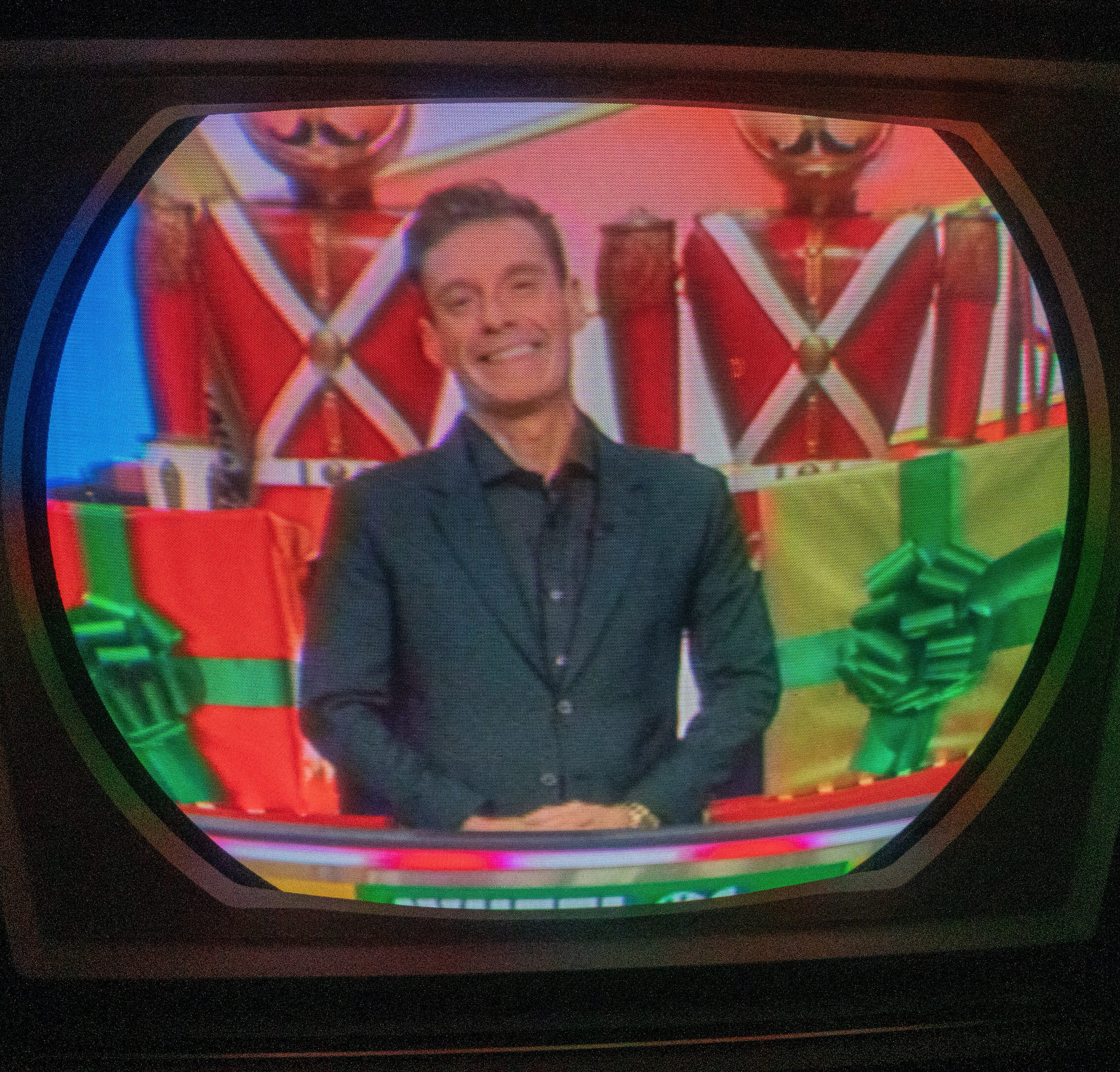

Happy New Year to all. RCA CTC-5 January 1, 2026

Nice! Happy Holidays!
