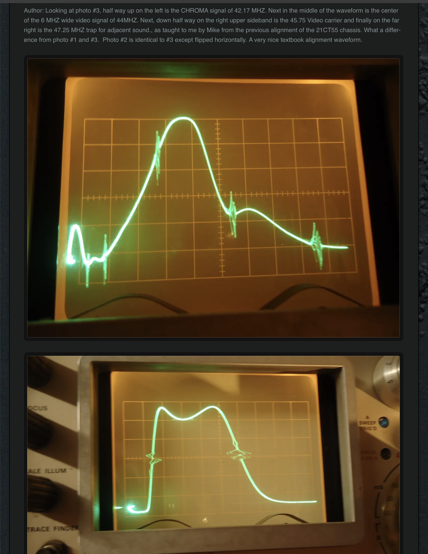

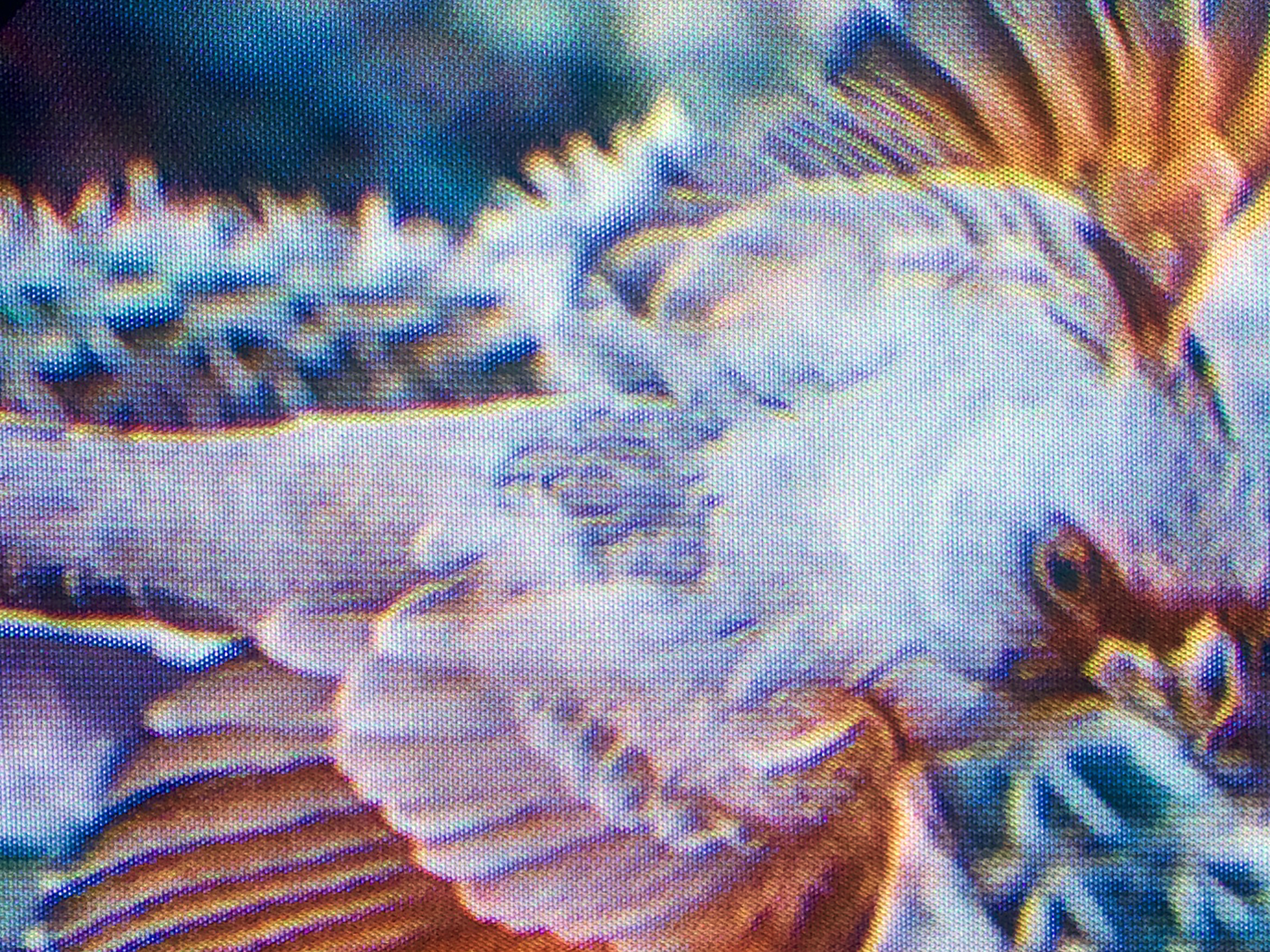

  #132
Old 12-05-2022, 03:41 PM
Posts: 1,641
Originally Posted by Penthode View Post
Been plodding away at the alignment today. The pages so far is as far as I have gotten so far with successful results.
I am going to back over the entire process and document it. So far I have seen multiple restorations to get the CT100's running but I do not recall seeing anyone doing a full RF/IF alignment?
Has anyone been through this?
My Westinghouse H840CK15, not a clone of the CT-100, received a full alignment. Here are a few notes and photos of the scope wave forms. The bird photo was just taken November 23, 2022. The restoration was over three years ago. I had to take screenshots to post the 79 MB resolution of about 198 MP of the 15GP22’s 585 K dots. Mike Doyle who is an inactive member here, did the chassis restoration. He worked at Cal Tech developing the Hubble telescope and later helped maintain the Hale telescope at Palomar and taught students at the University.
https://visions4netjournal.com/wp-co...5CE820782.jpeg
https://visions4netjournal.com/wp-co...0D3B487BA.jpeg
https://visions4netjournal.com/wp-co...8C571161C1.png
https://visions4netjournal.com/wp-co...5876908EC7.png

  #134
Old 12-06-2022, 11:43 PM
Penthode's Avatar
Penthode Penthode is offline
Posts: 1,463
I am impressed with the H840CK15. It has 4 IF stages and appears to demodulate the chroma on the R-Y and B-Y axes. This means early on it appeared to be the sensible way forward.
However I question the written statement that the placement of the color subcarrier at the 50% point is on the curve depicted.
Although it is stated that the the color subcarrier (42.17MHz) is at the 50% point on the curve, it looks to me 42.17MHz is at the 100% point. Perhaps teh 50% is instead 41.70MHz?
