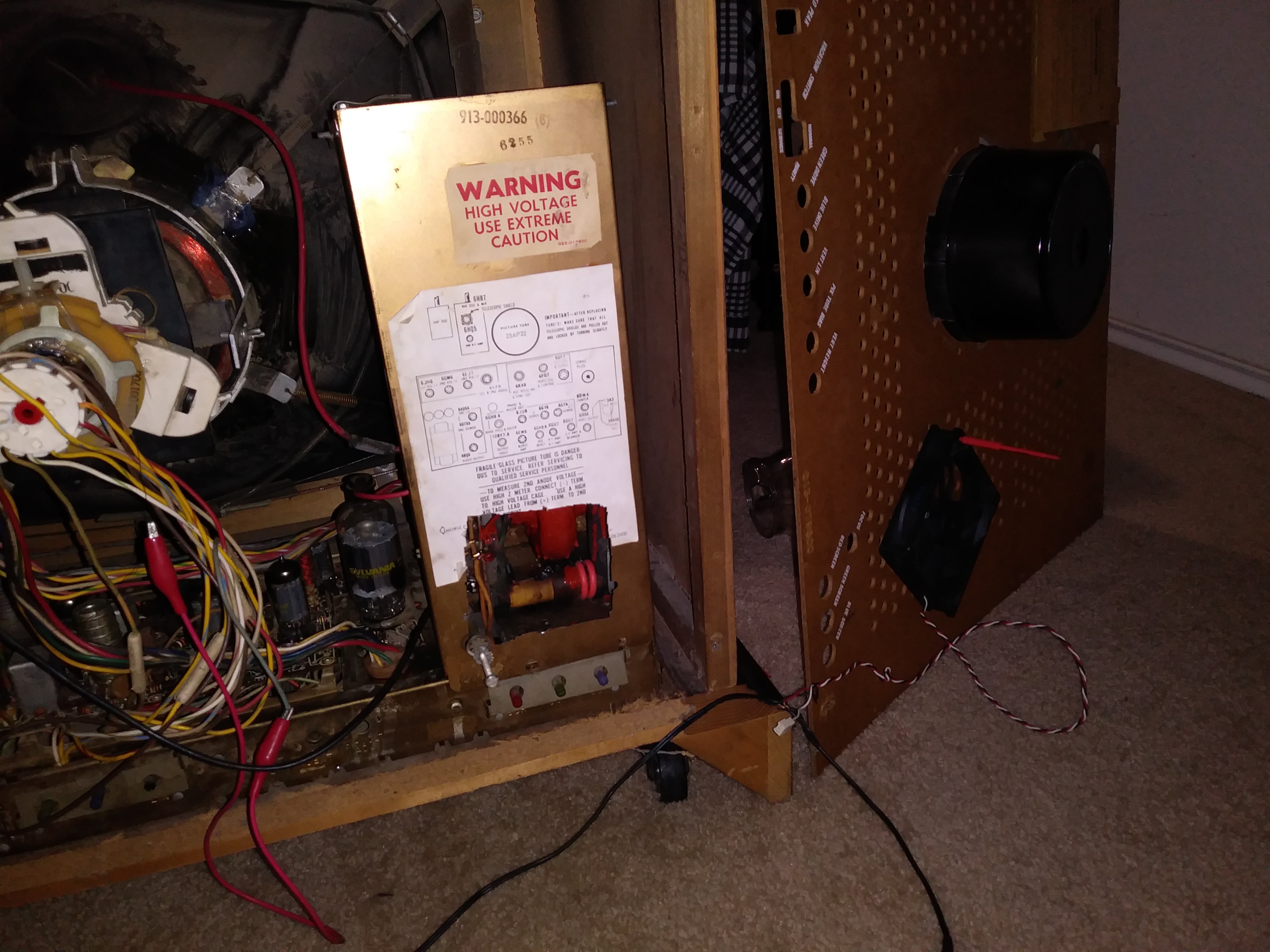

Posts: 3,206
compromise to leaving the HV cage cover off.
http://suzaku.live-evil.org/0917221801a.jpg
Fan will be paced on the back cover.

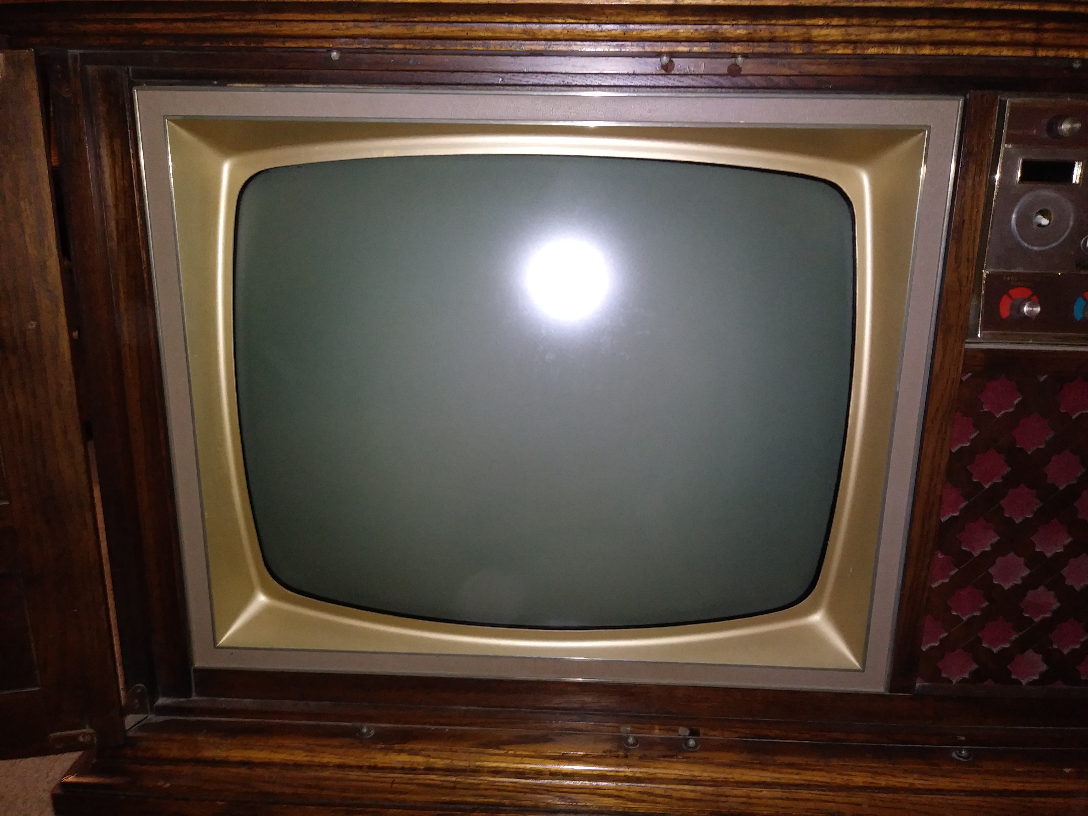

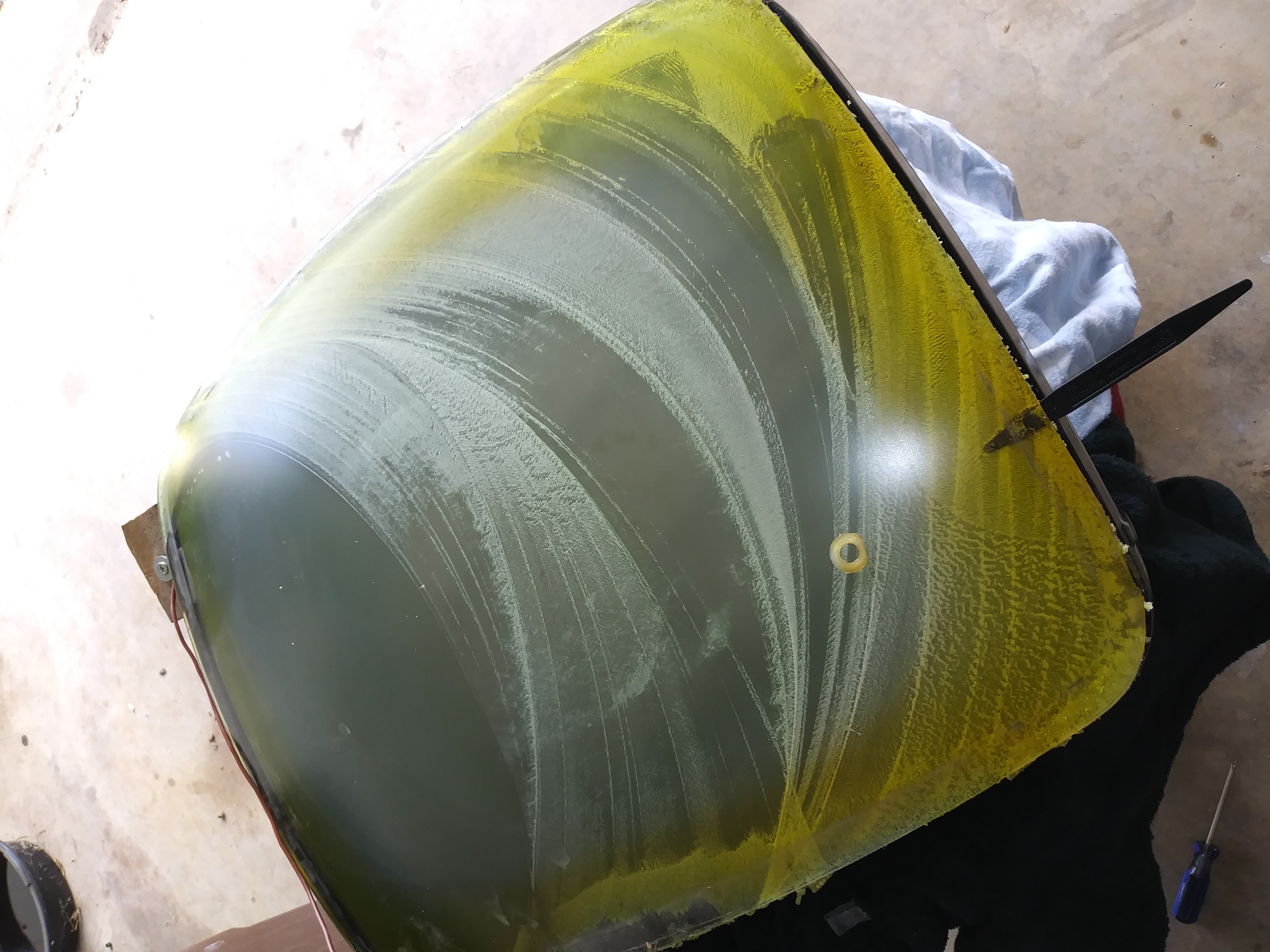

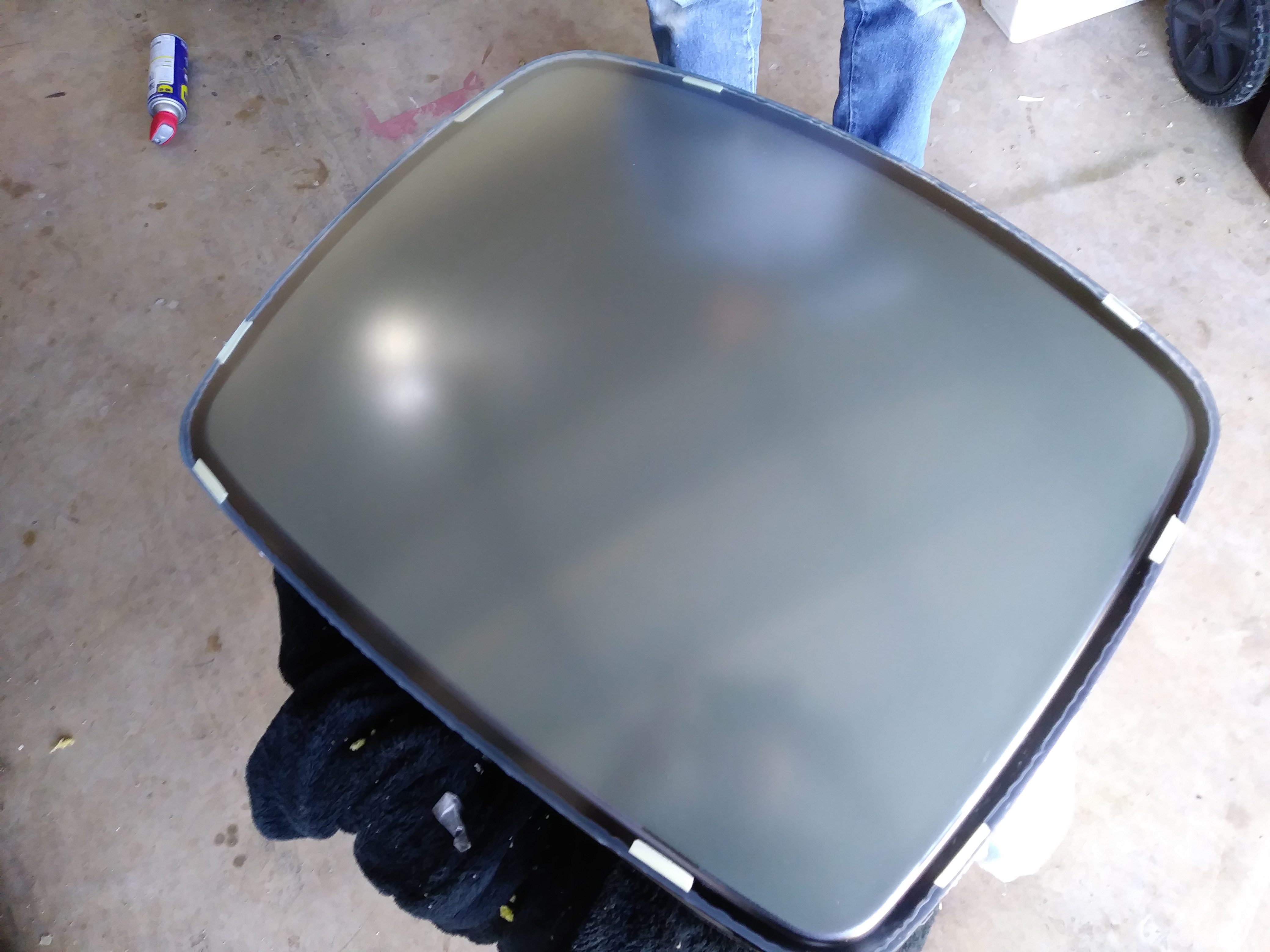

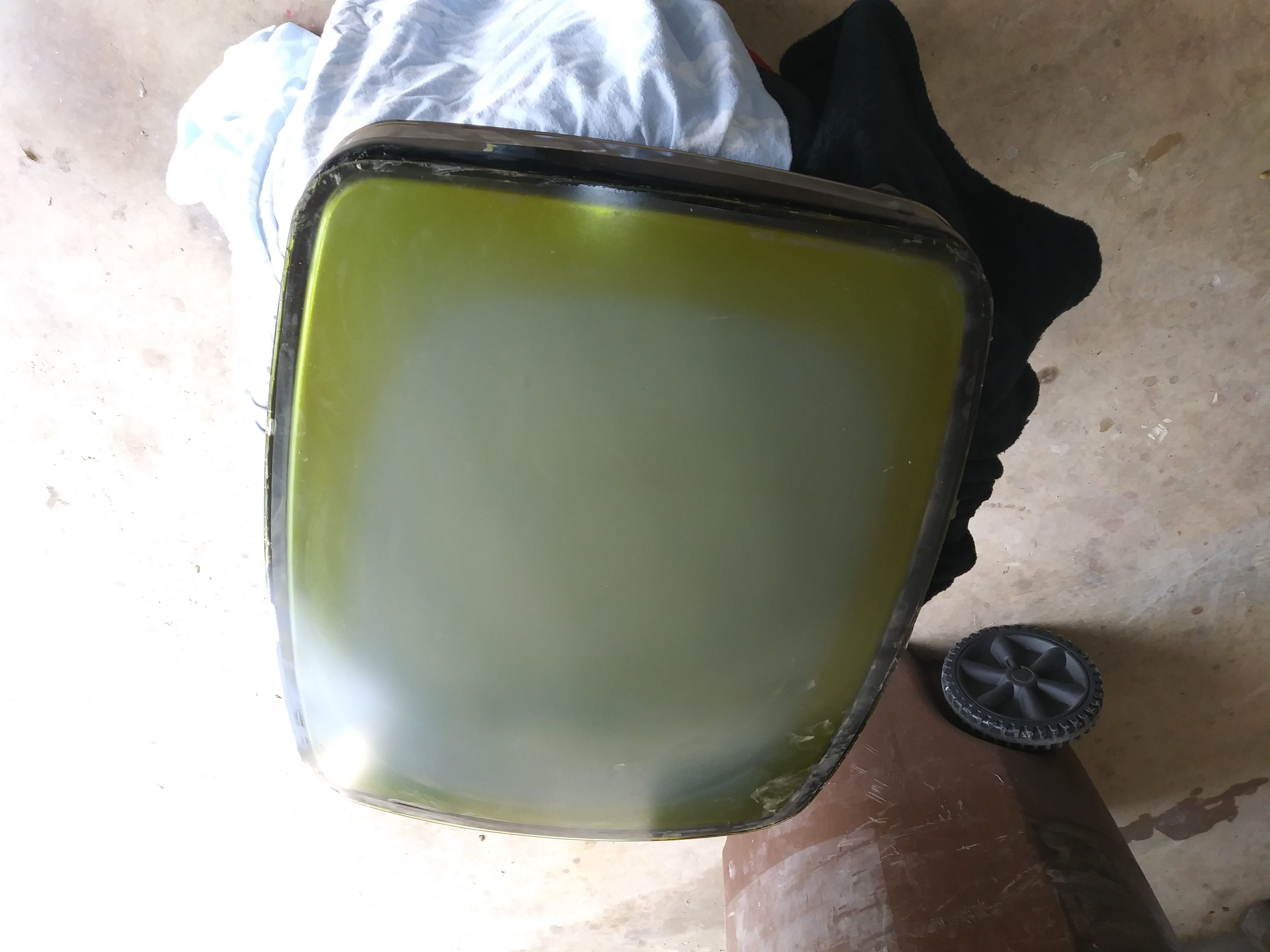

Cataract repair complete!
http://suzaku.live-evil.org/1008221106b.jpg
http://suzaku.live-evil.org/1008221132.jpg
http://suzaku.live-evil.org/1008221137.jpg
http://suzaku.live-evil.org/1008221147.jpg
http://suzaku.live-evil.org/1008221137a.jpg
http://suzaku.live-evil.org/1008221522b.jpg
http://suzaku.live-evil.org/1008221541.jpg
http://suzaku.live-evil.org/1008221556.jpg
https://www.youtube.com/watch?v=PblT6q0aQOc
cleaning the crap off the safety glass took much MUCH longer than it did to get it off the screen with the hot wire.

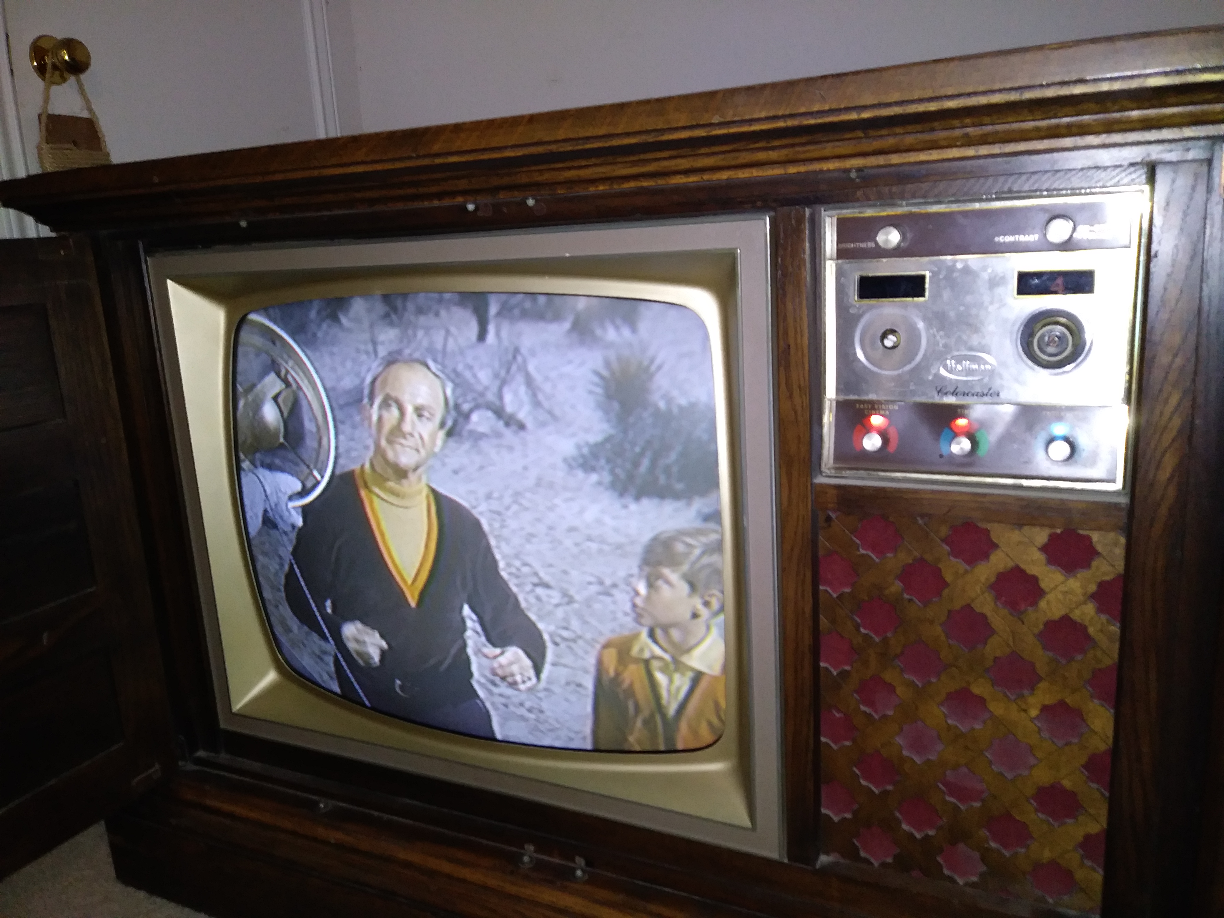

Old 10-15-2022, 03:45 PM
Posts: 3,206
TV now n final location.
https://www.youtube.com/watch?v=Wj0a2_-IFVY

It looks good, but I can't stand the Communist News Network.
Its one of the FEW things i can show that wont get a u-tube copyright hit T_T.
