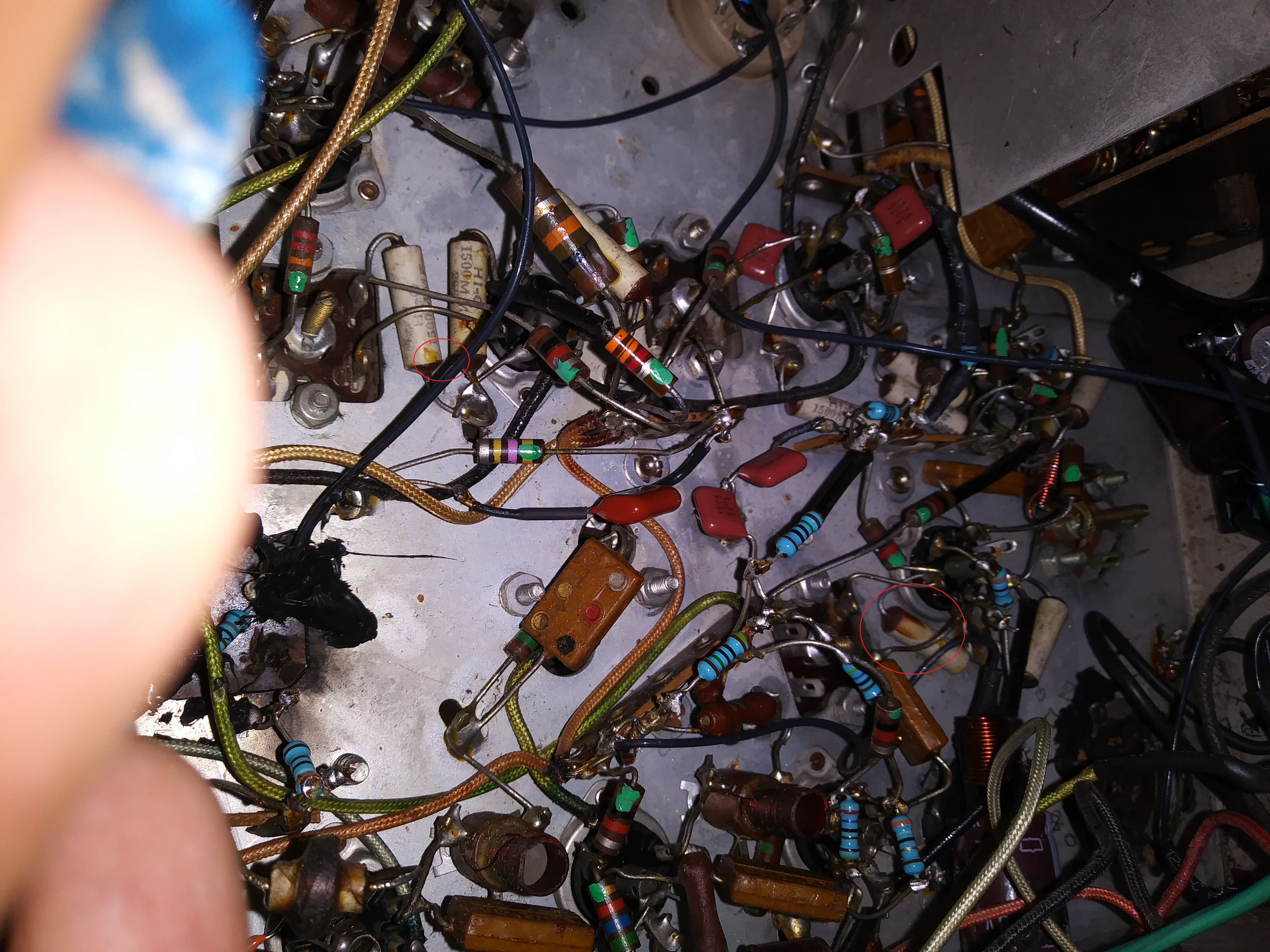

Yamamaya42 06-20-2024 04:13 PM
http://suzaku.live-evil.org/0415202203(1).jpg
pic of the weird brown stuff on the white caps

I don't have those caps in my TV...it has the resistor-like caps all of them in the 6.3V filaments to ground.
These were on my +135v IF line. :tears: and caused me pure hell in my FADA, even though the parts list called out ONE type, there were 2, the white with the weird leaking, and the tube type that seemed OK.
What's in yours? :O
Chris K 06-20-2024 06:59 PM
These things
https://imagizer.imageshack.com/v2/1...924/2pEc4v.jpg
