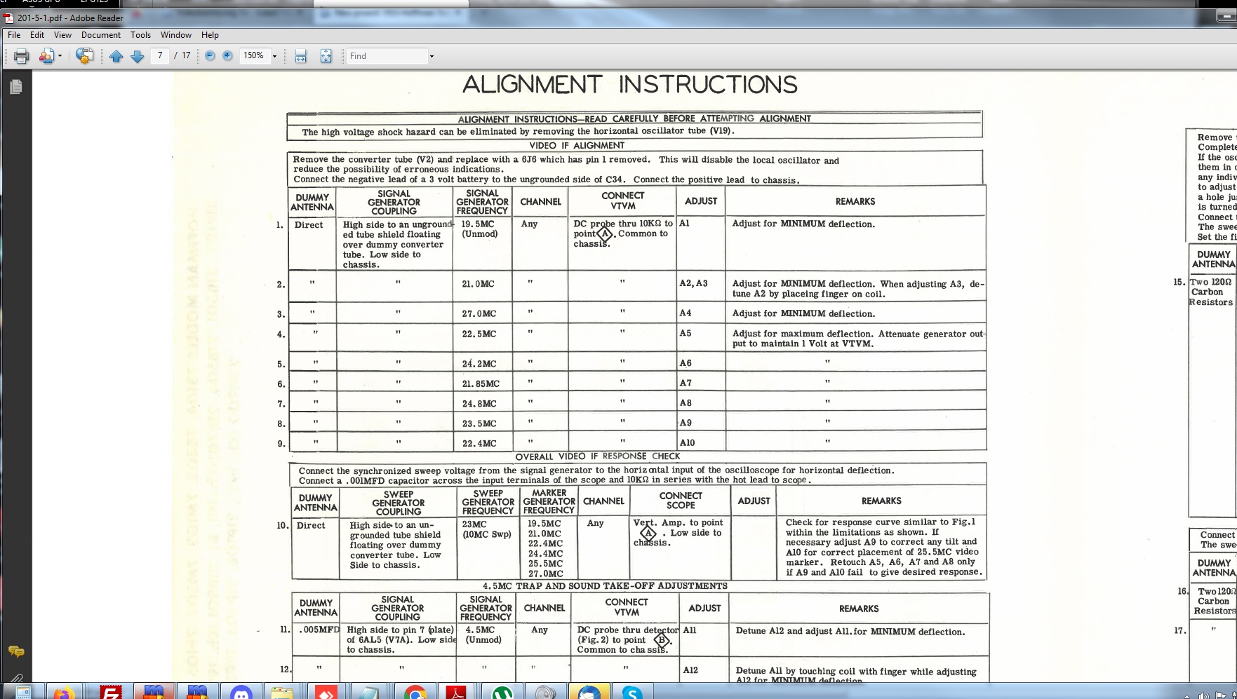

My Hoffman works, but not as well as it could. SHOULD.
As is in it is not as clear/ sharp and crisp as I think as it could be and I do not see snow on the screen with no RF input as I do whit my Arvin which i did attempt an alignment, but I still have no marker generator to do it complexly, just a digital RF generator, So would it benefit to try the first 9 steps of this alignment setup?
http://suzaku.live-evil.org/hoff-align.jpg

Hi,
You can't get around a good sweep generator, just because this Hoffman will
be not your last newcomer in your collection!
They were expensive when new, but in our days, nobody wants them.
The number of warm-hearted TV-collectors is low, they have some, and
many TV-shops are passing - incl. their stuff!
Here in Germany it is told, that sweeping TV sets is out of vogue since
the beginning 80s - it was really not more a part of the education for TV-men!
I am sure, that you are able to get a good sweep generator with cables,
when you are going to check Ebay, CL or here at the VK-marketplace or search at the ARF-classified!
The shipping price might be higher than the cash you have to pay for the set!
Good luck!

problem is, this is a 25.5mhz IF set, and sweep marker generators are pretty much impossible to find for them, 45.7mhz aare all over the place however.

Hi really?
We had in the early 50s these low IF in Germany, too.
You really have to have a set like that.
Please start requests at the given forums.
Did you ask them: https://www.earlytelevision.org/index.html
They might have an idea, to get one.
Another way is to buy one from Germany or the Netherlands.
Literature is not a problem, but we have 220/230 Volts sets with 50 Hz.
So before you could start, you have to repair a european "Wobbler".
Maybe you can build your self a device to get the right frequencies?

I do see A Eico 369 out there, which has 4 marker points, unlike the 368.
