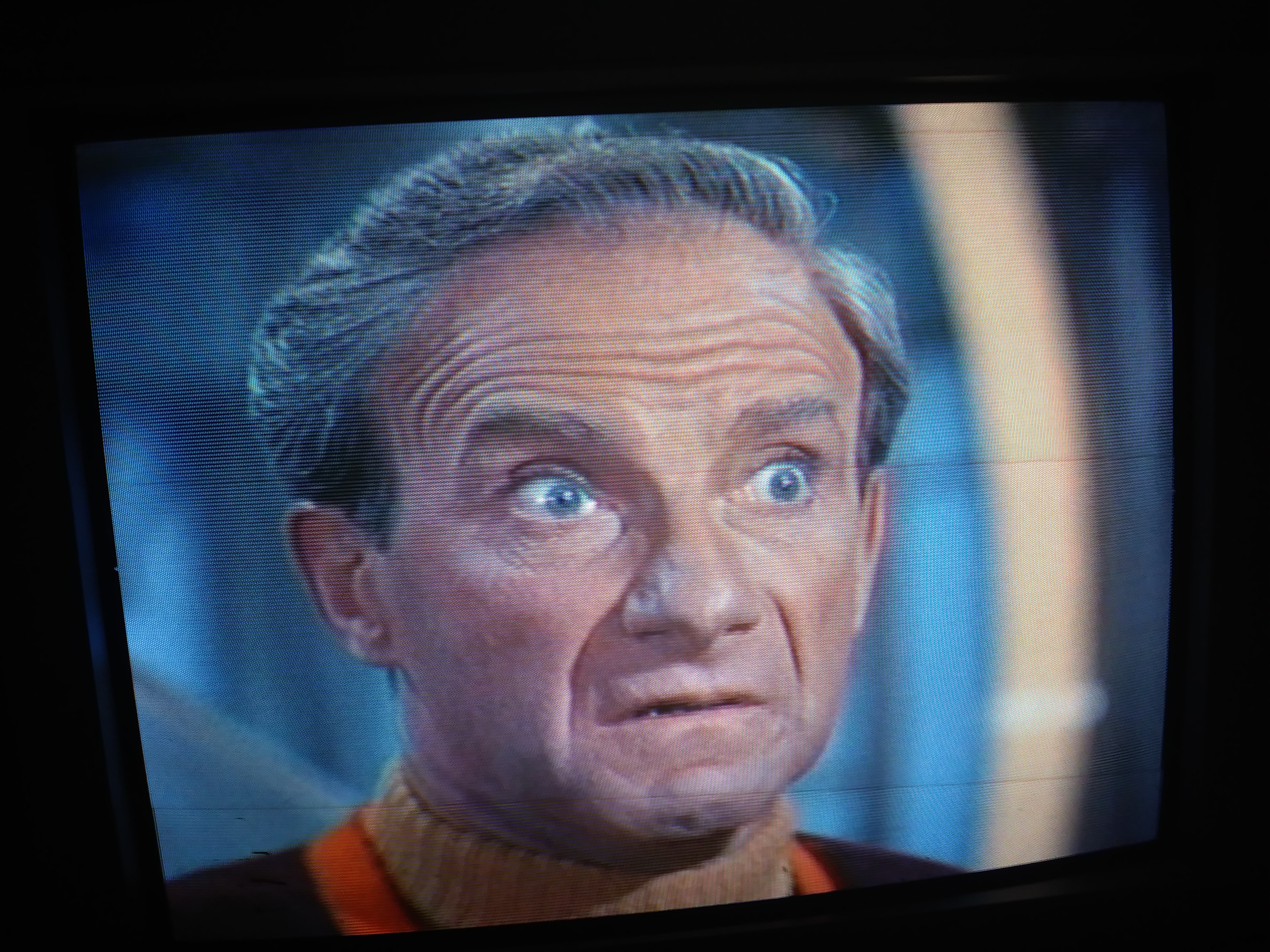

Old 03-10-2026, 09:31 PM
Posts: 3,231
It's odd, cause when it works, it works well.
http://suzaku.live-evil.org/0310262115a.jpg

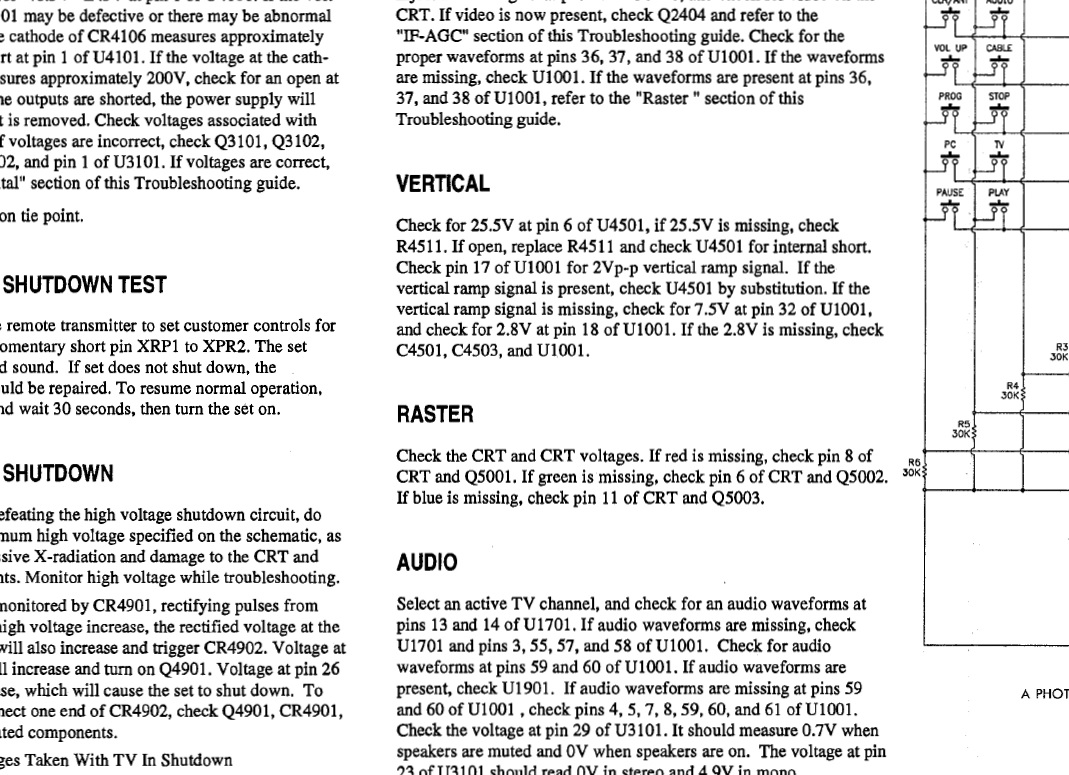

What SAMS says about vert debug.
http://suzaku.live-evil.org/vert-problem.jpg
Yes, the 25v is good.
And the output IC has a history of trouble. New one ordered.
Those era vert output ICs are generally touchy and often blow open when the caps attached to them drift too far out. They also run very hot and destroy the caps near them on the PCB, so they essentially kill themselves. Very common
It's oddly running cool for some reason, as in after sweep does start, and has been on for a while, shut down, grab the HS, and it's very cool.
