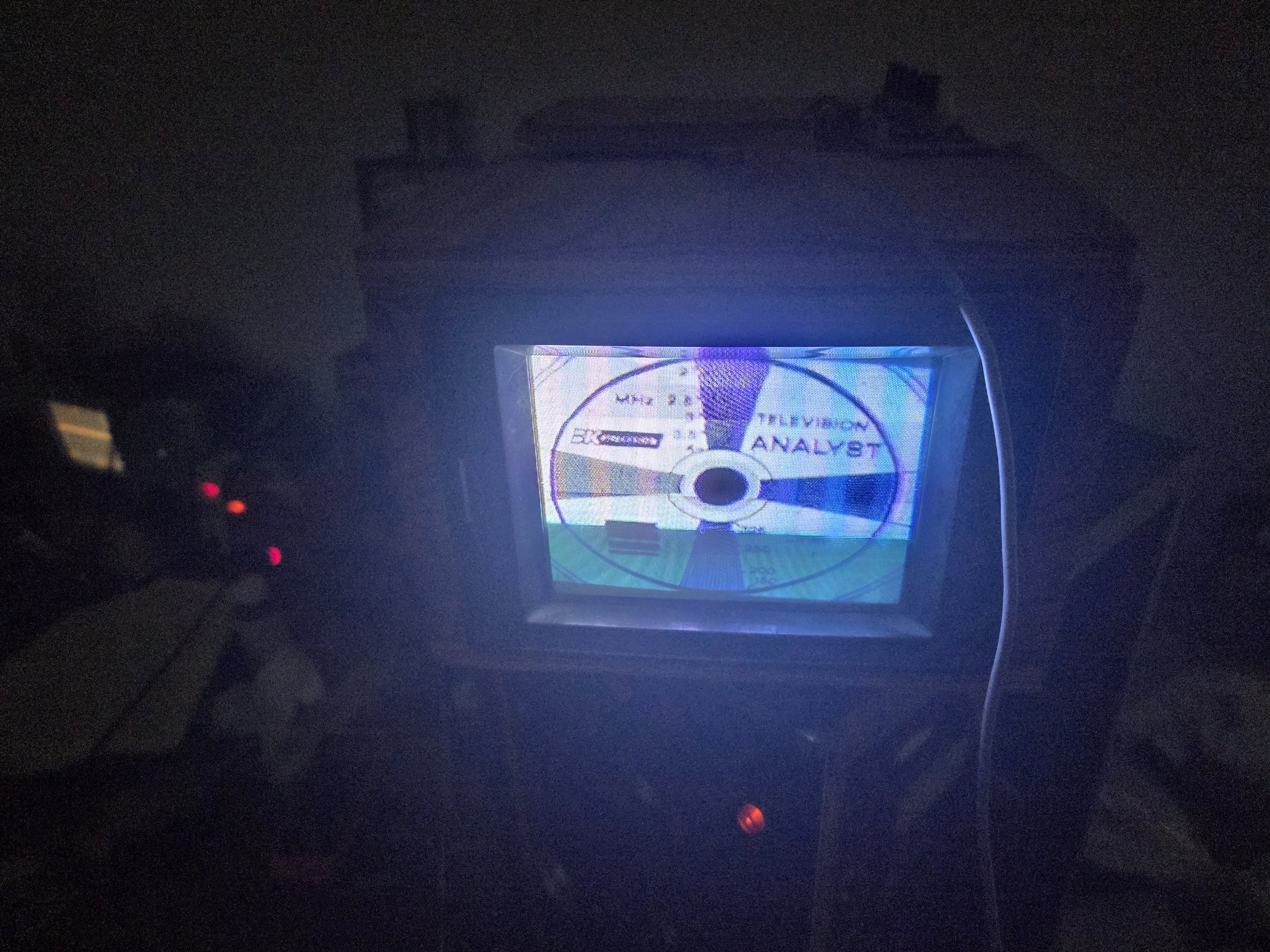

Yet another Test Eqipment project! BK Precision 1077B.
I have always wanted one ever since I saw one of them in HS, and it blew me away how it worked, so I finally gave in and got a couple, cheap.
First one seems really clean looking, seller said it is working, which I doubt, as there's something missing in this picture.
http://suzaku.live-evil.org/ezgif-61b06a3c43119908.jpg
So I got another cheap one.
http://suzaku.live-evil.org/ezgif-604c1d51370434b0.jpg
This one HAS the missing part, and 2 templates, but said was unsafe to use as it was "smoking",I spotted something odd in the picture.
It came today.
I was correct, I did spot something..
http://suzaku.live-evil.org/20260923_203627.jpg
SMOKE source.
did not even have to plug it in.
http://suzaku.live-evil.org/20260923_203644.jpg
Not even sure if this CRT is good or bad, It's an odd type, not sure how to test it, does not match the schematic.
Now I wait for the other one to come.

the other unit came that was said to be "working" and as I suspected, it dont work so well!
http://suzaku.live-evil.org/20260928_184419.jpg
At least it does not smoke!
The main cap on it is DEAD!
http://suzaku.live-evil.org/20260928_191825.jpg
Replacements coming.
Old 09-29-2026, 09:42 PM
Posts: 3,227
It's working!
Sort of.
I did not order the NP 20 uf cap on the video output on the thing, and it's REALLY bad, leaky, put a temp smaller film cap in for testing.
http://suzaku.live-evil.org/20260929_205605.jpg
ordered a 22uf film cap 450v

That 18.86 khz seems a tad bit high, but I'm not sure if the O-scope is reading it right yet, will see when the right output cap is in it, but there does seem to be a way to Adjust the freq.
Old 10-02-2026, 05:01 PM
Posts: 15,478
If you have a regular sinewave generator you could adjust it to repeat at the same rate as the horizontal does and measure the frequency of the sinewave.... Alternatively you could measure the number of scope grid divisions between sync pulses on a modern stable composite video source (like a DVD player) then adjust the B&K so it matcjes.
Old 10-02-2026, 07:03 PM
Posts: 3,227
It's alive!
http://suzaku.live-evil.org/20261002_184808.jpg
Still needs some work, perhaps some new tubes. they are all old original.
