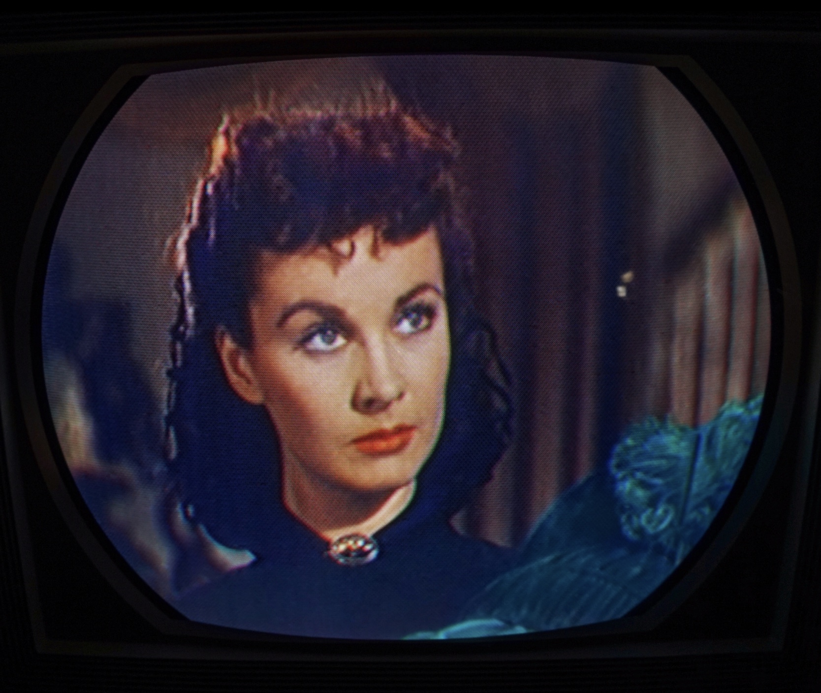

So I decided to look into the the DC restoration issue today. As it turned out, it was the cameras fault, not the TV. I was not seeing the blue push that the photograph showed. I adjusted the white balance to what I was seeing on the screen. It was set to auto, and we changed it to “shade” which better matched the actual colors on the screen.
The first shot is the one posted earlier and commented on. The second shot was from today after adjustment. All shots original size 6000X4000 reduced for posting here.
The yellow straw hat is influenceing the skin tone.
I’m also posting some test shots from the Video Esentials disk using the new white balance setting.

Back in the day, I used an analog Nikon 35mm SLR. In those days the camera did not have ISO settings or white balance settings. Film was generally slow, so one wanted a lens with an aperture that allowed the most light to strike the film such as 1.4. You bought “fast” film and high ISO ratings.
I haven’t operated that camera since 1998. Been using cell phone cameras. Recently my wife gifted me with a nice DSLR, mirrorless, APS-C sensor, with interchangeable lens’s. It’s been a learning curve adjusting to all the settings available. Case in point, white balance. What I learned, check the white balance of the subject your shooting. :-)
The “sweet spot” or maximum focus of my lens based on an Aperture of 3.5 is supposed to be about F9. So today, I tried that setting on the 21CT55, but all the shots turned out lousy.
From the old days of analog, shooting through the center of the lens (stopping down or closeing the lens) was usually the sharpest. A lens is curved so you have distortion at the outer edges of the lens. Sony used this anolgy effectively in advertising in 1968 with their one gun, one “lens” Trinitron. I found F16 worked the best for screenshots.
I think I’ve got it right?
I’ve attached two sets of comparison photos. You can see the blue “push” with auto white balance.

Defocusing slightly doesn't make the auto exposure work differently. When you defocus, insted of imaging bright phosphor dots on some pixels and the dark spaces between the dots on adjacent pixels, you spread the bright dot over several nearby pixels so they see an average brightness that is more like the average that the automatic exposure sees.
Defocusing is tricky to do just enough that it prevents bright pixel overexposure but doesn't degrade resolution. As stated by DTVMcDonald, if you adjust the exposure towards a darker picture, it will help the very brightest pixels not be overexposed. However, if your picture is sharp enough to resolve the phosphor dots, this will mean the picture will look darker on average.
Regarding white balance: if your camera provides a way to save a custom white balance, you could do that by turning the color down and capturing that setting on a black and white image. But I agree with the comment that the best way to handle this is to shoot in raw mode and adjust the white balance in software.
