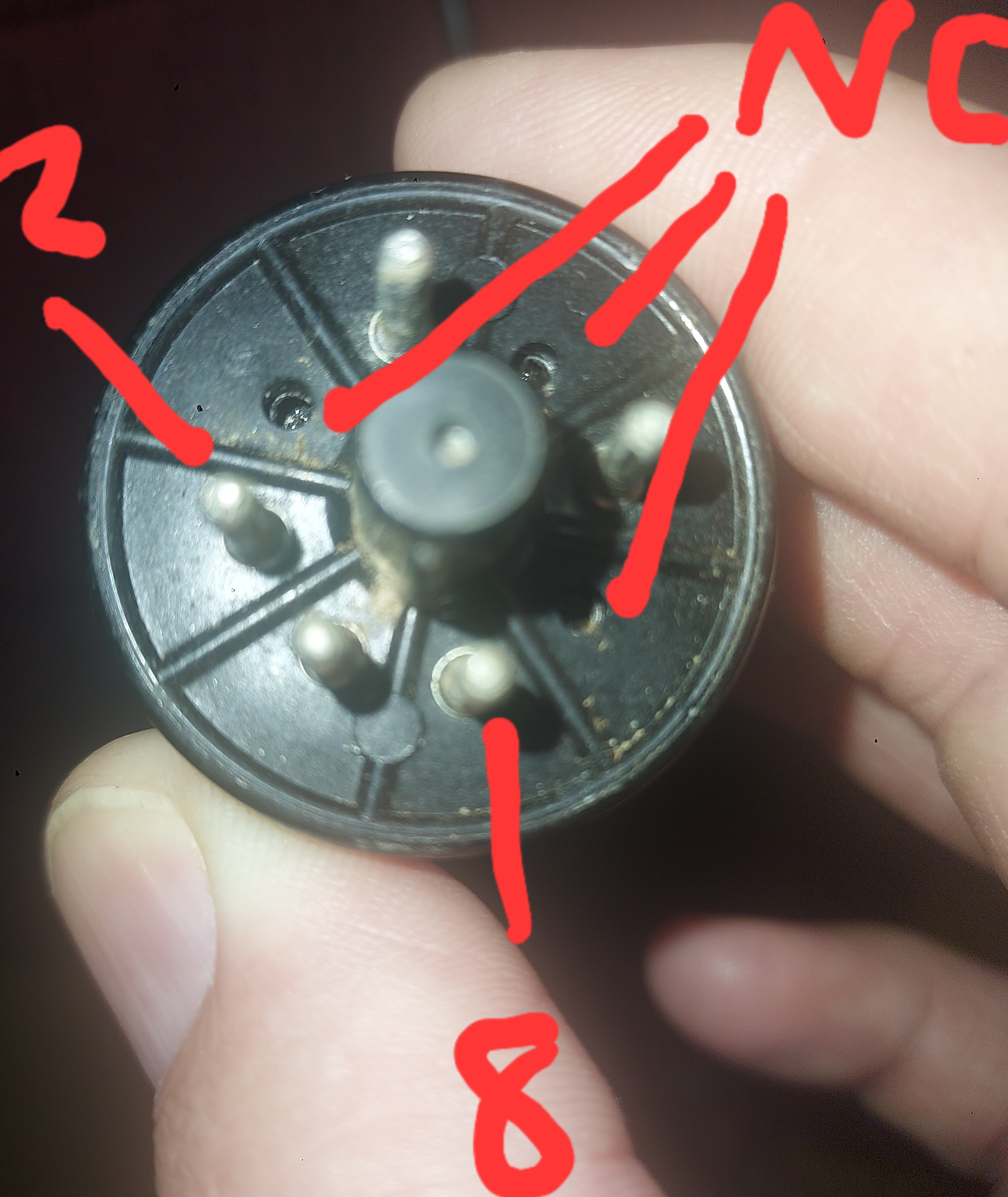

No Problem, If you can get your hands on a RCA Receiving Tube Manual (which can be downloaded off the Internet for free as a PDF Document) that will tell you the pinout of pretty much every single type of tube made from the 1940s-1970s.)
I have a couple of copies of the RCA Receiving Tube Manual on my computer (two different years) but I don't know if I can upload them on here on not because of how big the files are.

I think I got it. Rc 30 1975 172 pages at 37 mb. Assuming nc is the blank areas or no pins, I've labeled 2 and 8 and seems to check out. Got fluctuating numbers meaning good. 👍

Are you trying to test the tube or the TV chassis transformer? Generally, I pull the 5U4 and power up the TV. All the tube filaments should glow. Then, if you have a meter that can handle 1,000 volts AC, carefully place the probes into the 5U4 socket holes for pins 4 and 6. You should get something between 600 and 800 volts AC.

Ok, pulled 5u4, put probes in 4 and 6, plugged in. All tube lit and got 630-636 on meter.

Cool. Sounds like you have a good power transformer.
