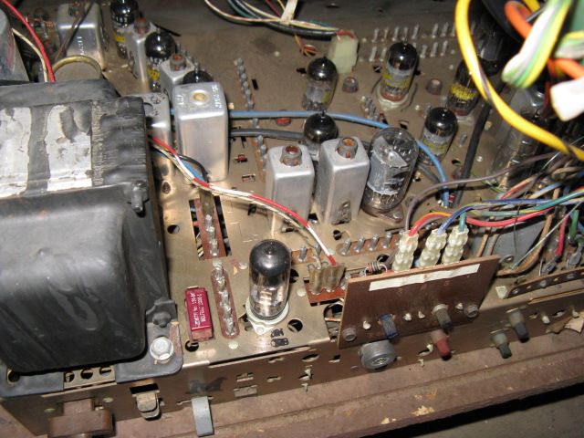

I decided to finally re-install the chassis that Doug rebuilt for me some months ago.
All went well until I came to the degauss coil wiring...
It appears I did write down that it came from a connection strip with 5 "prongs", the last two being for the degauss coil. Problem is, there are many strips that fit that description, and I drew it horizontally, but the strip I "think" it came from is vertical!
Can someone tell me where (physically) the coil is supposed to plug into?

If it's the 23MC32 chassis (H.S. 804-4) you may want to look under the chassis to verify. The input lead would be off the circuit breaker and the other point would be at the junction of the B+ diodes.

I just double checked, this is chassis 24NC31Z.
No circuit breaker on this one. Thanks anyways

Those plug into first two pins directly to the right of the 12HL7 video output tube as shown here. The chassis on mine is marked "DGS" with a grease crayon, probably done at the factory. I've seen others like yours with no markings at all.

But on the real... Thanks for the photo Doug... Plugged it in and I was in business! As has been said before on this forum recently,
