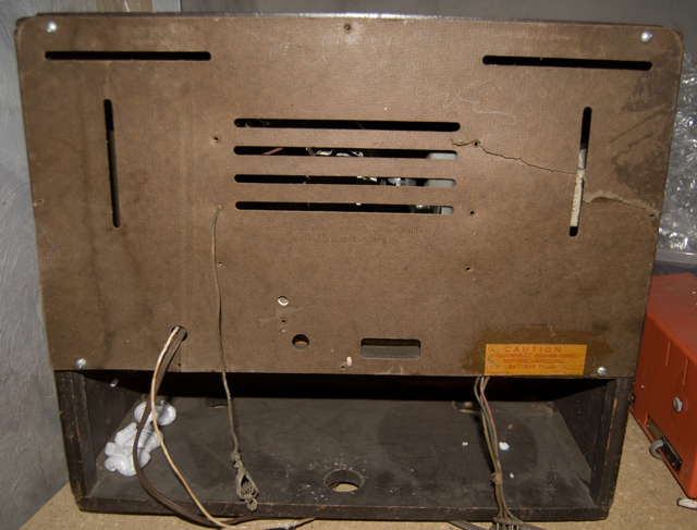

The back needs a little repair.
and has this label, which says something about the evolution of product liability.

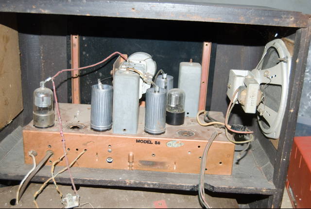

A quick peek inside - I haven't pulled the chassis out yet, but I already see some of the dreaded rubber insulation.
It's missing the 117Z6, one of the grid caps on the 1A7 is loose, and a cap can has been removed at some time. Dial needs restringing. The tube lineup is 1A7, 1H5, 1N5, 1N5, 1T5, 117Z6. Looks like it should be straightforward to get it working when I can get around to it.

I remember reading a pre war Crosley ad that the 117Z6 tube was not included. It stated when your home was wired for electricity, you would then get one from your friendly Crosley dealer.

Fascinating. I wonder if they left out the filter caps too. That would explain the missing electrolytic can. I really need to pull the chassis and see whats underneath it, but if I start on it, I know myself well enough that I will give it precedence over other projects that I should finish first.
