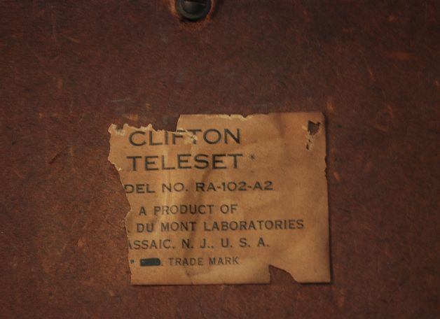

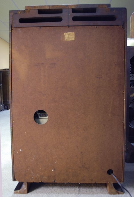

Clearly it had a back originally, but I haven't been able to find a photo of one
Well....here you go. This is what the back of the Clifton looks like...........Not much to it.
And a close up of the ID tag attached to the back.......................

Originally Posted by Ampico-kid View Post
Well....here you go. This is what the back of the Clifton looks like...........Not much to it....
Excellent I was picturing a masonite back with 100s of holes in it.
