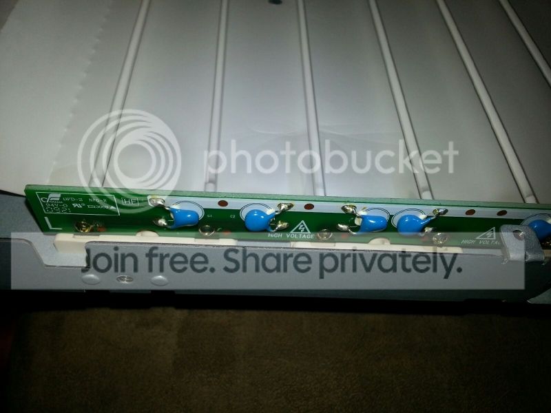

[IMG][/IMG]
[IMG][/IMG]

Sorry, those look like the backlights themselves. The inverter has some small
(1 inch by 3 inch) transformers that are flat on them. Look around the board that they are on for dark spots, especially under transistors.

[IMG][/IMG]
There are no burn marks on the transistors behind this photo at all or anywhere else on this board.

Chect the three capacitors on the left for leakage. They look overheated. These little blu caps are a continual source of trouble. If they get warm when running that is a dead giveaway.
