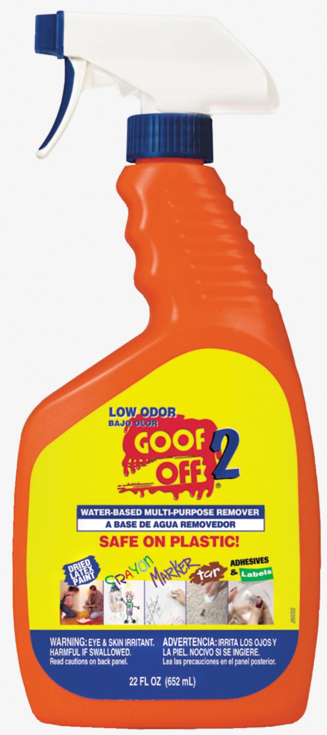

Alright, I'll see about picking up a bottle of that. The only problem is that there's some paint spatters on one of the knobs as well and I tried scratching it off with my fingernail and it wouldn't come off and I know goof-off isn't going to be good to use on something like plastic because it has stuff in it that hard on plastic, so I wonder what I would use on the knobs to clean them up.

Try the new Goof Off 2. "SAFE ON PLASTIC!"

OK, I'll see if I can find some.
